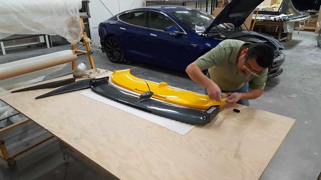

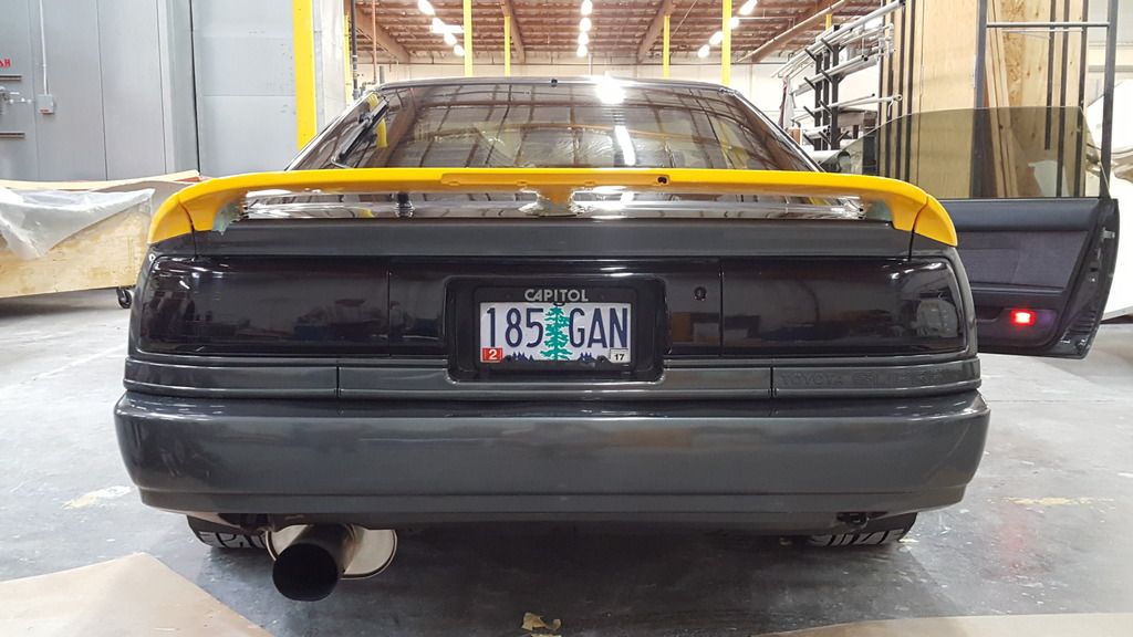

UPDATE:
So the spoiler is under alteration. The antenna hole will be shaved as 3/4 of everyone have their removed and it will be a lot easier to make a hole for the antenna than to fill the hole with FiberGlass or possible Carbon Fiber.
Hello Kaminari
It's HAPPENING

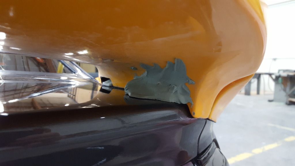

Got mine removed next to the Kaminari Main Wing (The V2.0 will have a 1/4 inch addition to the height of the rear portion with a smooth transition into the spoiler giving it a slightly more aggresive look)
Passenger Side (Antenna Hole will be removed as most have requested/removed their factory antenna)

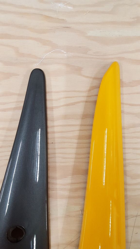

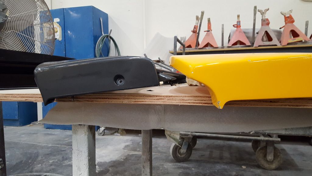

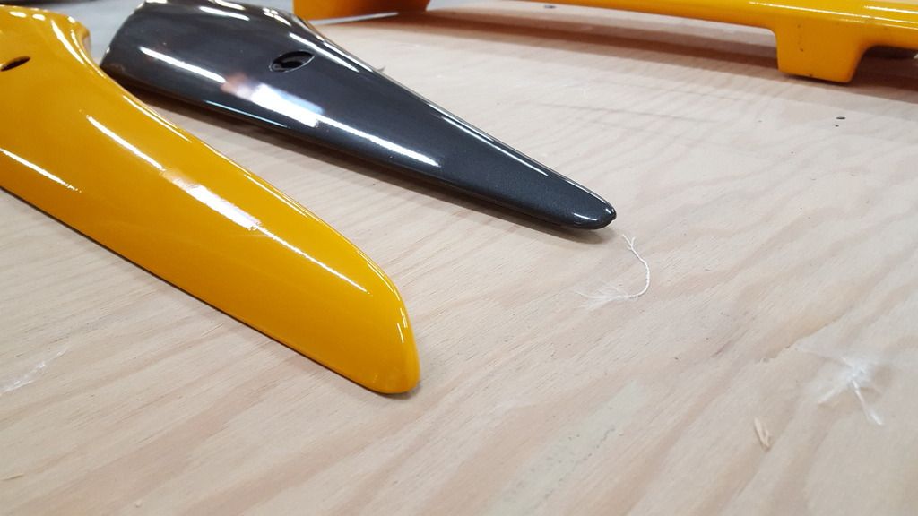

Side Wing Tips (You can see the Kaminari is currently taller and more pointed end) They will be rounding and tip and taking it down slightly to make a better transition into the body.

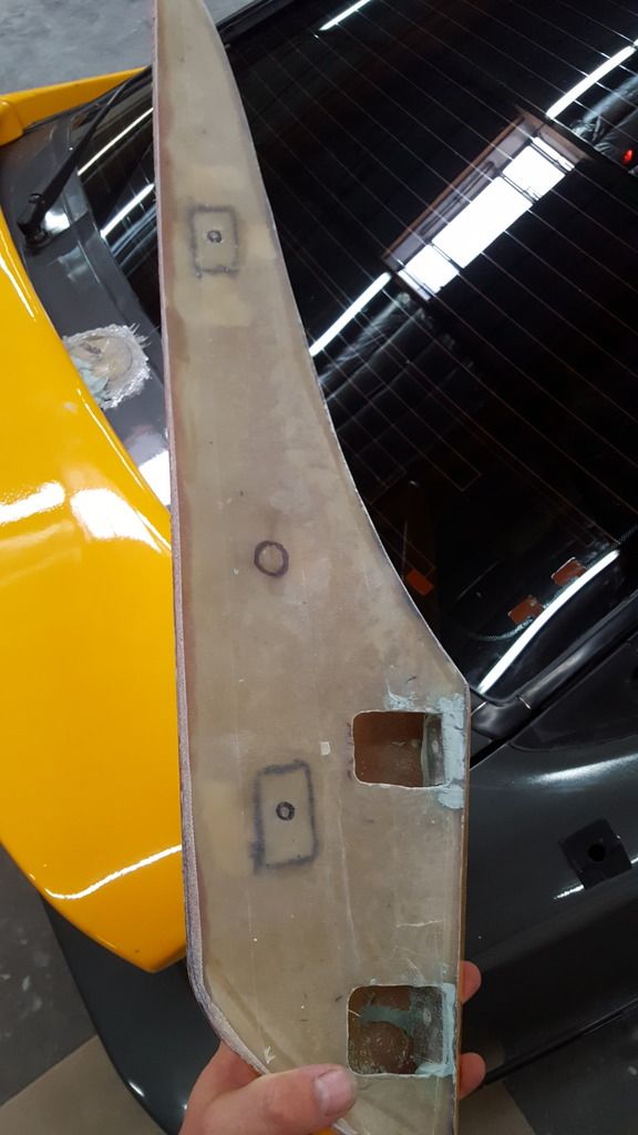

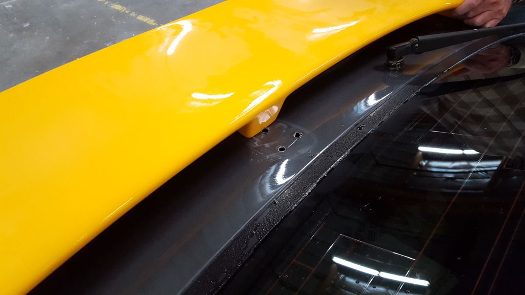

The Under side current does not have any mounting points. They are making adjustments so that the factory hardware can be used. THE ONLY MOUNTING DIFFERENCE WILL BE. They cannot reproduce the snap in pin on the Lower edge of the side pieces that go up the body. They will be making a female mounting point where we can run a bolt/nut through the original OEM holes and secure the spoiler that way.
Pete, the owner and Master of Kaminari helping fit the spoiler.
Center Mounting point is as if it was cut off. Pete is casting my OEM spoiler center mount to add that to the Kaminari center so that the factory mount holes for wires and bolts can be used.
Getting Masked off for the casting to be done.

So awesome that this is happening and even better to get some pics of the process. The changes are exactly what I would have requested. Nice work

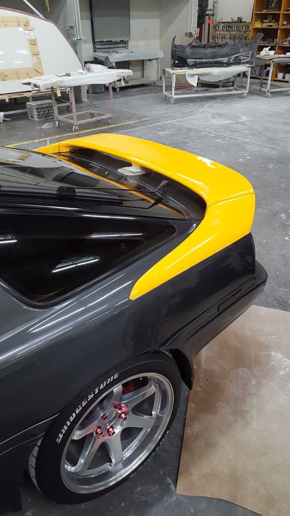

UPDATE #2

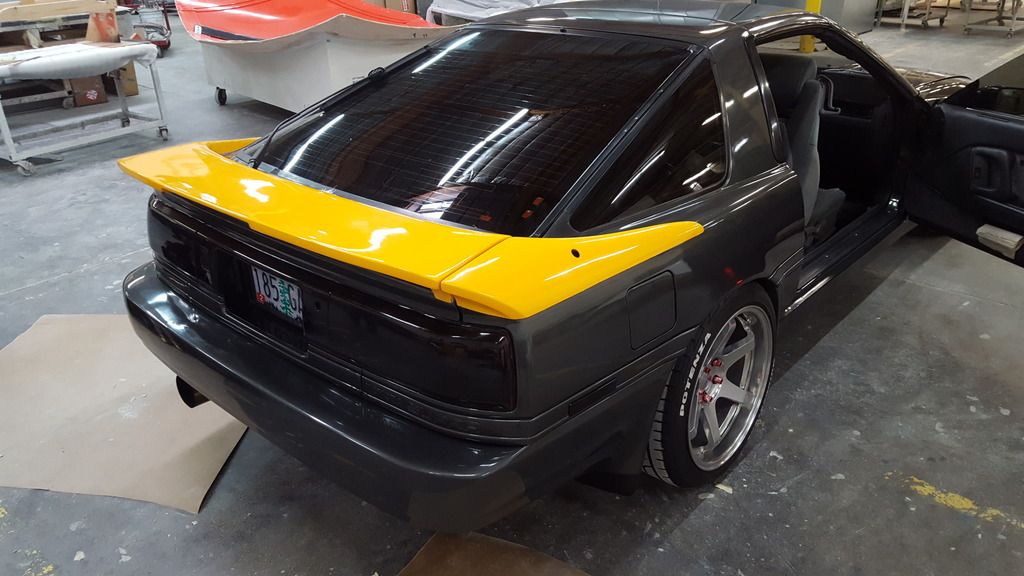

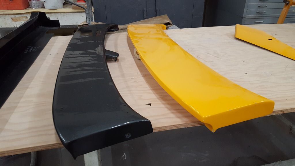

So, the next morning went back to pick up the supra and see what they had done to the spoiler at that point and a good amount was completed. They masked up the body of the car and made a cast on the bottom part of the spoiler so trimming and adjustments for fitment to the body could be made. (This was their catelog spoiler so it didnt sit perfect)
Dont mind my daughter walking into the picture
spoiler sits on its own and forms great to the body
You can see the fiberglass base laid out for the spoiler. They cast my spoiler middle mount to make the addition to this piece.

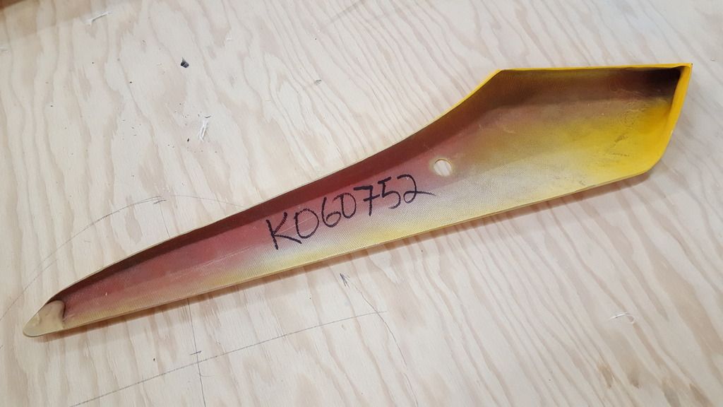

THE SIDE SPOILER TIP PIECES WILL REMAIN ORIGINAL KAMINARI. No alteration to the front side tips will be made.
Rear Shot. (you can see some filler build up that i have a closer pic of)
The Antenna hole WILL BE SHAVED AND REMOVED ON ALL SPOILERS as it would be harder to fiberglass fill the hole for the majority of people that dont have the antenna anyway. Also if anyone wants to buy a Carbon spoiler without the antenna hole they would just have to use a plug. So to help compensate for those that want to use factory antenna. There will be the hole location cast/marked on the bottom side of the spoiler for easy drilling of the factory located hole.
The rear bolt on OEM mounts was RIGHT ON the edge of the kaminari so they will slightly be building it out a little wider so the bolts can be put to OEM location.
