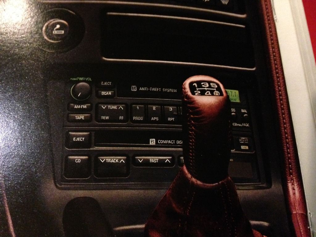

2) Rip out the aftermarket stereo described above that uses a 16804 head unit from a MKIV Supra and go back to the correct OEM CD Player. I was never able to solve the noise issues in my current setup, although I know some of them are from the amp sitting over the fuel pump. However, I'm not feeling the need for a subwoofer anymore (getting old) and would rather have the trunk look 100% original anyway.
Question - I snapped this picture out of my 1989 Supra brochure. Does anyone know for sure a) what the model number(s) of this unit is/are and b) if it is internally amplified or not?
My 1989 TSRM is very unclear regarding if the CD player is internally amplified or not. There are two units (boxes) shown, but it is unclear whether those boxes represent the two single DIN units (radio/tape player and CD player) or the double DIN unit as a whole and the remote mounted amplified under the seat. I've been looking all over and have not been able to nail down the answer to this question, but I'm starting to suspect that all 89-92 CD players were externally amplified. If that is the case, anyone have a cosmetically clean 89-92 CD head unit, amplifier, brackets, wiring harness, etc. that they want to sell? As long as it is cosmetically clean and the CD transport works I can deal with electrical issues, especially in the amplifier.
