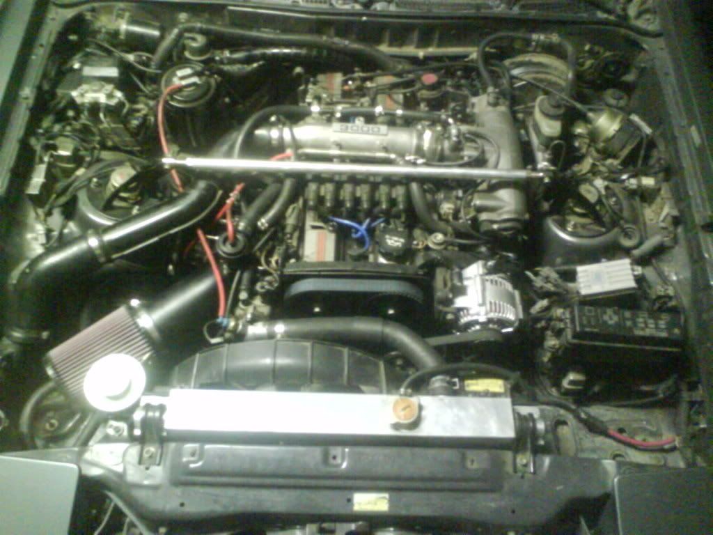

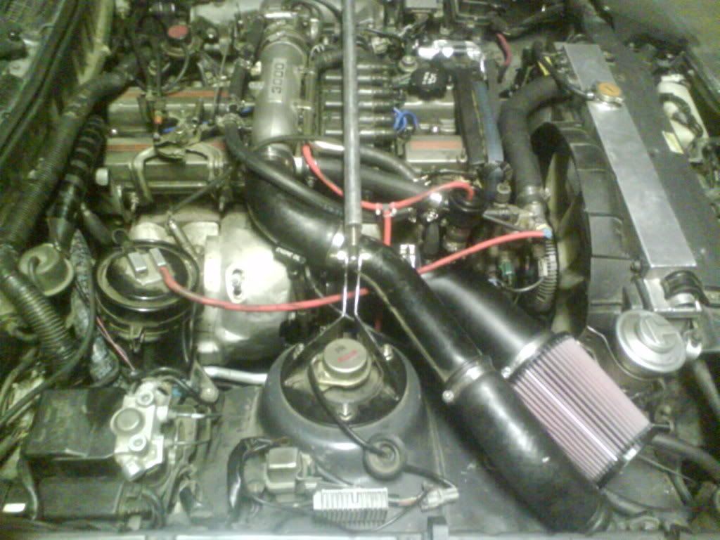

Bright shiney things on top keep a casual observer distracted
And if you know something, you may ask why is there a 4" filter on there?
And i want to thank Adjuster for the idea to move the PS reservoir where it is ;) Took some a lil modding of the oem bracket, and a custom 90* bracket with 2 holes in it, mounting to the old air box screw mount
Thats a bolt on t70.
