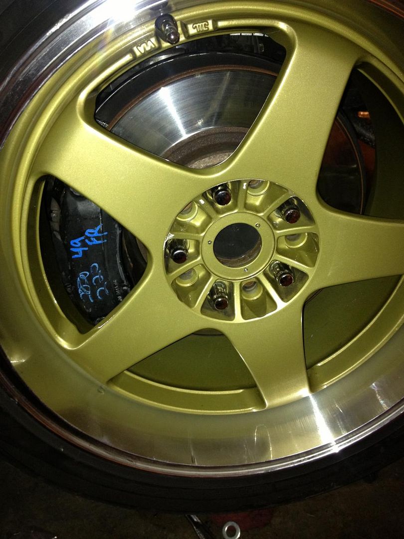

i got a set too cause i figured they're all gonna get bought up sooner than later. that ebay seller is prolly thinking wtf all the sudden everyone is buying my used mercedes calipers hahahaa. they were shipped fast and packaged well to.
hoping they fit i have xxr 962 in a 17x9 +35 up front. be nice if somebody had the rotor thickness but i can get an idea from the pics i guess. cause if its thicker than the stock rotor hat that will give the wheel more clearance. i want to test fit them before i order pads and rotors i think its gonna be close if they do fit. soon i will find out!

i should have been more specific but i meant how thick is the rotor hat on the mecedes rotor. cause to test fit wheels with just the calipers you need to know that cause it looks much thicker than the stock rotor hat so its going to space the wheel out more than stock brakes and give more clearance to clear the larger calipers ;)

idk they might work. i tried my wheels and they only fit with a 7mm spacer. but mine have a pretty big lip so if it the spokes are flush with the face of the wheel they might work. also i just spaced my stock rotor out with some washers to where it was close in the pic. if anything it might not be spaced out enough. really though i think the golden ticket that would make this setup better yet is a rotor that fit more inward so you don't have to shim the caliper out 5mm. im gonna look into trying to find a different rotor but i have a feeling its going to be hard to do since i don't think the deminsions needed are listed. heres a pic of them

Black89t you cannot use a rotor that goes more inward very much farther as it will hit the knuckle for the mounts for the tie rod and ball joints.
