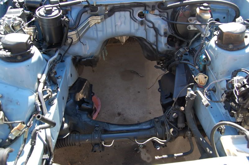

Here are some pics of the 7m coming out a couple weeks ago,
Here is a shot of the engine bay after I cleaned it a little,

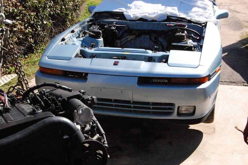

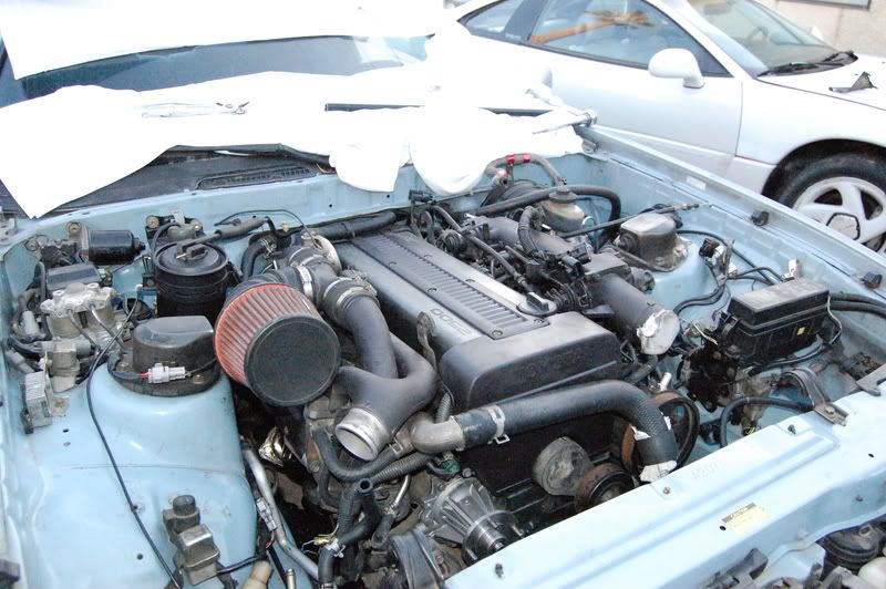

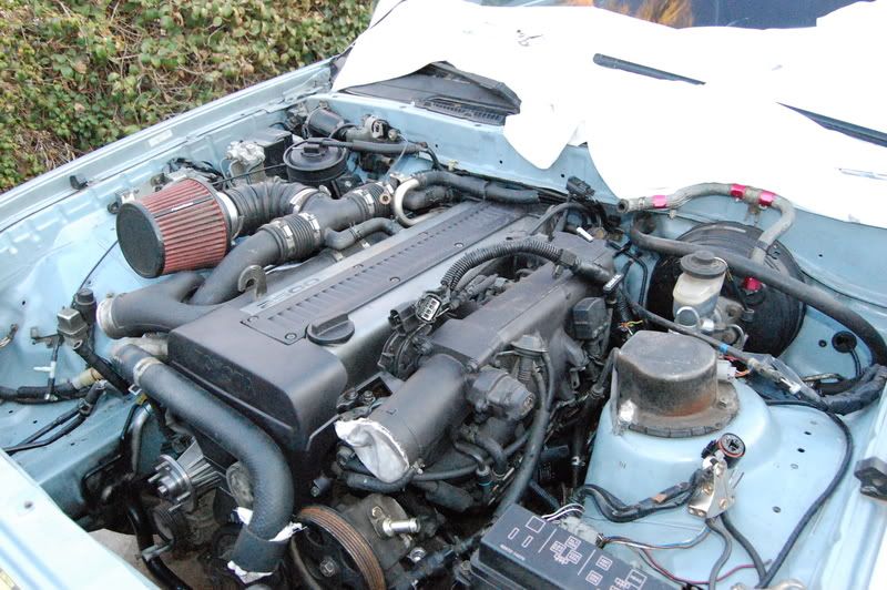

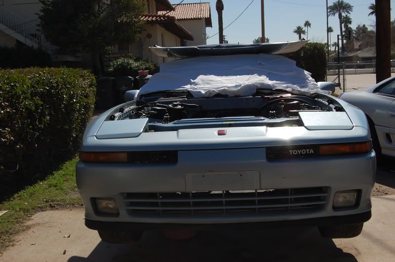

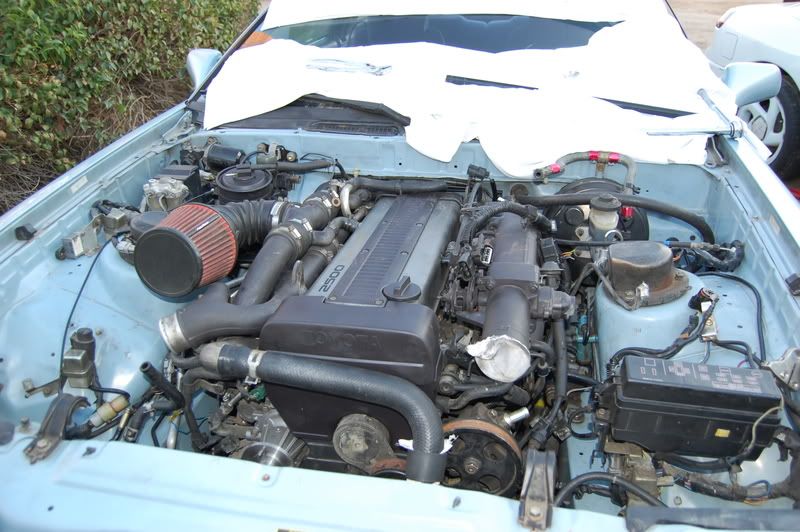

Well I got the engine in it wasn't that hard of a task considering this is my first engine swap, Of course with the help of my big brother(redmkiii):bigthumb: well enough talking now for the pics:icon_razz
I hoping to have it running this next week or the week after!
