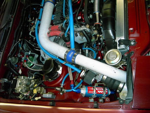

I use two Bosch bypass valves. Don't remember the numbers, but they are off a Porsche 996 Turbo IIRC, and they were 30.00 for both.
Here is the key.
They must be installed the right direction.
I see people with them installed wrong all the time, and those same people complain they leak or don't hold boost.
Here is the key. They are designed to open under any vac conditions. If you have them plumbed correctly, this allows air to take a short cut around your turbo, FMIC and all the pipes/hoses. This shortcut improves throttle response at low engine speeds where there is no boost yet.
As soon as pressure exceeds ambiant, the bypass valve closes up, and is held closed by the pressure in the IC pipes. IT CAN NOT OPEN UP UNLESS THE VALVE BREAKS. And that would take pressures beyond what your engine would hold anyway.
The Bosch bypass valve has to be installed with the hose going to your IC pipe off the side of the body, and the hose that goes straight down, to your Accordian/intake hose. (Opposite the vac line fitting.)
It fits better backwards, but it only works right when it's installed the way I just noted.
Here is an old pic of my old setup. (I use two of them to get maximum air bypass, so it improved low speed throttle response. It works.)
