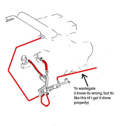

I'm awaitng replies and photos from people on the aus forums... in the meantime I also realised that my wastegate is hooked up to the intake manifold - which i gather is a bad thing... so thats another thing to fix!

Ok, after getting some help on the aussie forums, this is my current setup. I'm bypassing that vsv which I don't have with a loop of vac hose for now. Just how important is that vsv?
Comments?
My bov now has much stronger vac to it and my compressor surge has almost disappeared! yay! only thing is my boost stays at 6-8psi for a lot longer now before hitting 9psi :( lame.. do you think thatll go away when I fix the wastegate line?
