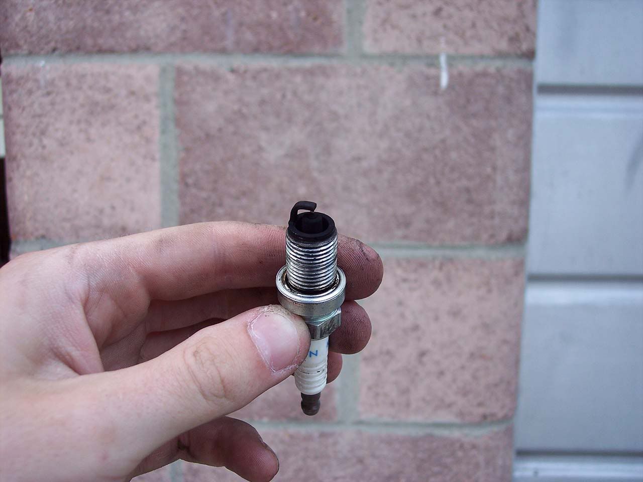

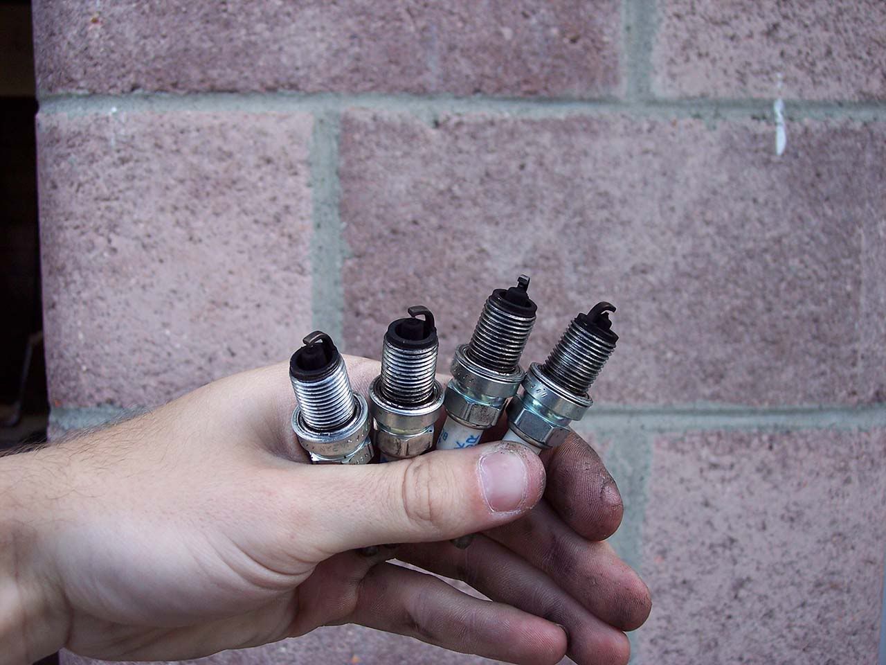

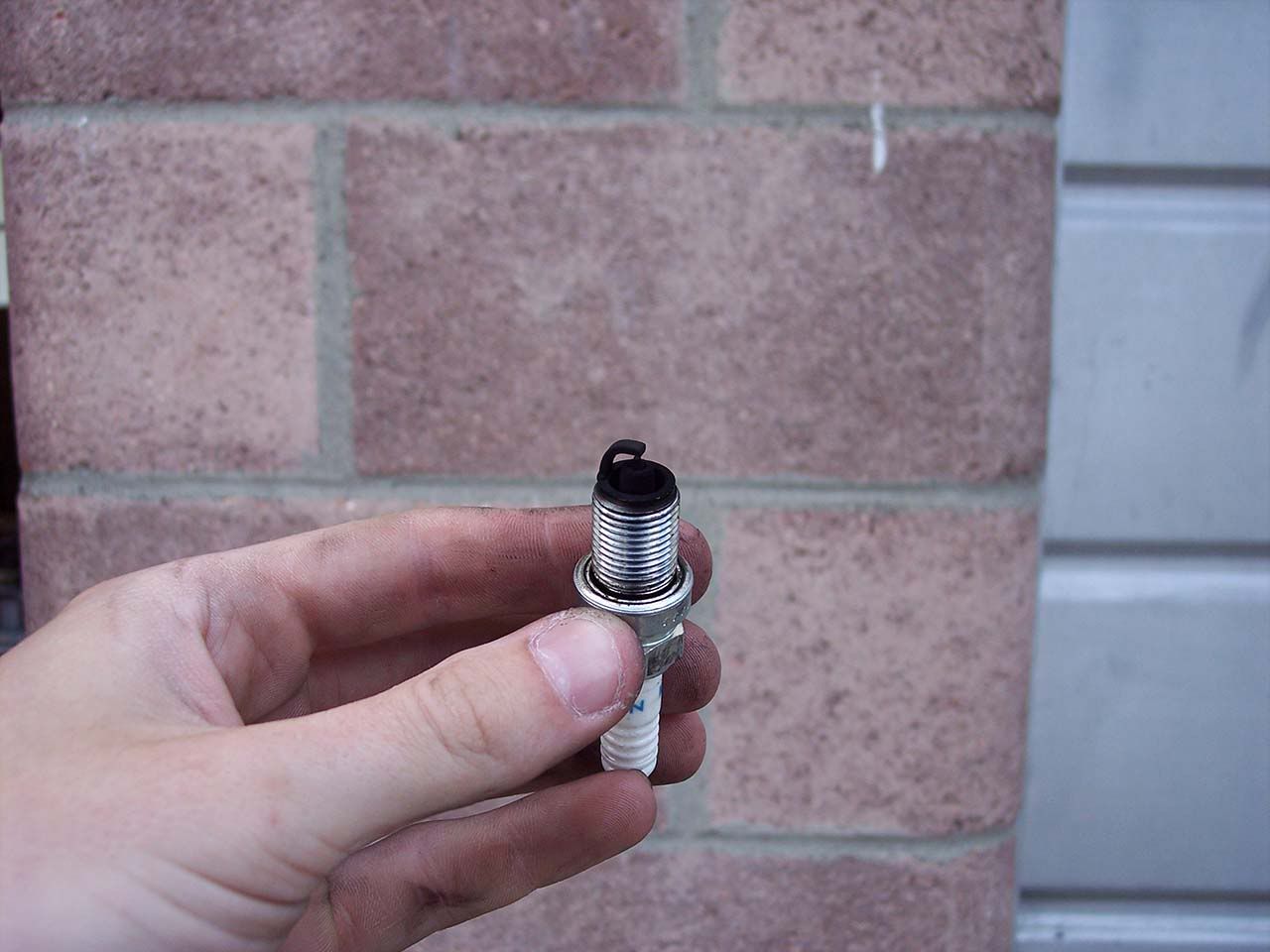

The time that I did get it to start was right after we cleaned the spark plugs, which were pretty black. The car only ran for 20 minutes tops, and seemed to run fine. I was really surprised when it wouldn't even come close to firing the next day when I tried it. I checked the plugs today and they're totally black again. I pulled the #1 plug and it is getting spark.

We cleaned the plugs the other day (pictures of dirty plugs to come), but the car still wouldn't start. Usually, if you let it sit for a good while before you try it, it'll cough once when you first crank it over, but then nothing more.
Last night, I gave it another try, and it fired up immediately. Once running, it ran fine, but I shut it off and tried it a few minutes later, and it wouldn't even sputter, it just cranked.
My guess is that its running rich, and maybe getting flooded out for some reason. That would explain why it only starts when its sat for a few days, the plugs are clean, and its kind of cold outside. Any ideas as to what's causing it, though?
