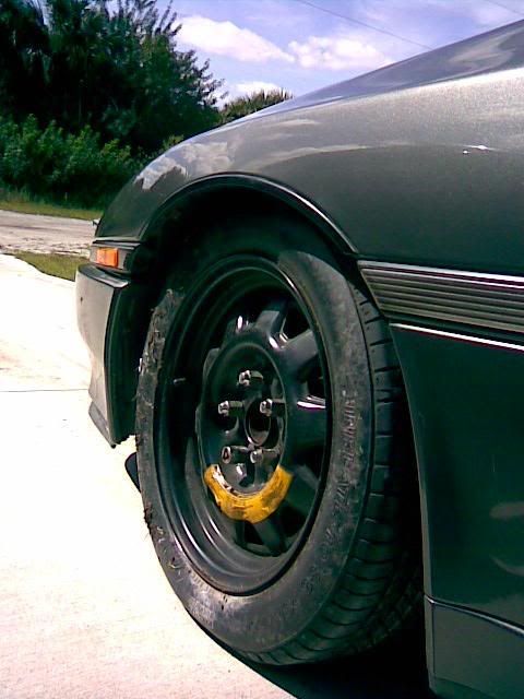

Justin: my car sits LOW... I guess you never saw it in person, but I posted a pic where my fist was on the ground and the top of my fist was touching the lip... Besides, 3.5 is plenty for that teeny turbo Im using, lol...
it cant be that low
we fit a 3" fine on that.. hardly scraped :)
