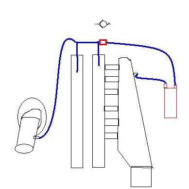

I think im going to do it that way too since I have a ffi. So what size is your port in the intake manifold providing the vacuum? The stock system does not incorporate a pcv valve, instead it has a metered hole in the TB for a vacuum source, correct? And if I understand correctly, your PCV valve is also whats protecting the crankcase from boost pressure, and thats where your hose to the turbo inlet takes over?
edit: like this:
edit: like this:
That won't work unless you have a one way check valve on your FFIM. :-(
edit: like this:
I think you're defeating the purpose of the catch can like that. Under boost, the catch can will be inoperable, no? Someone correct me if I'm wrong.
