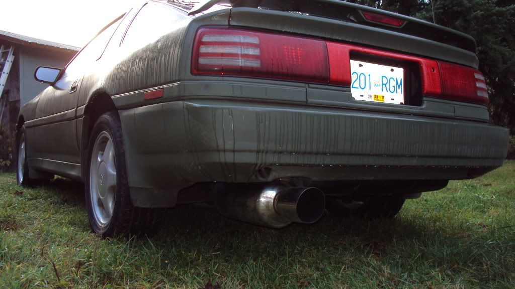

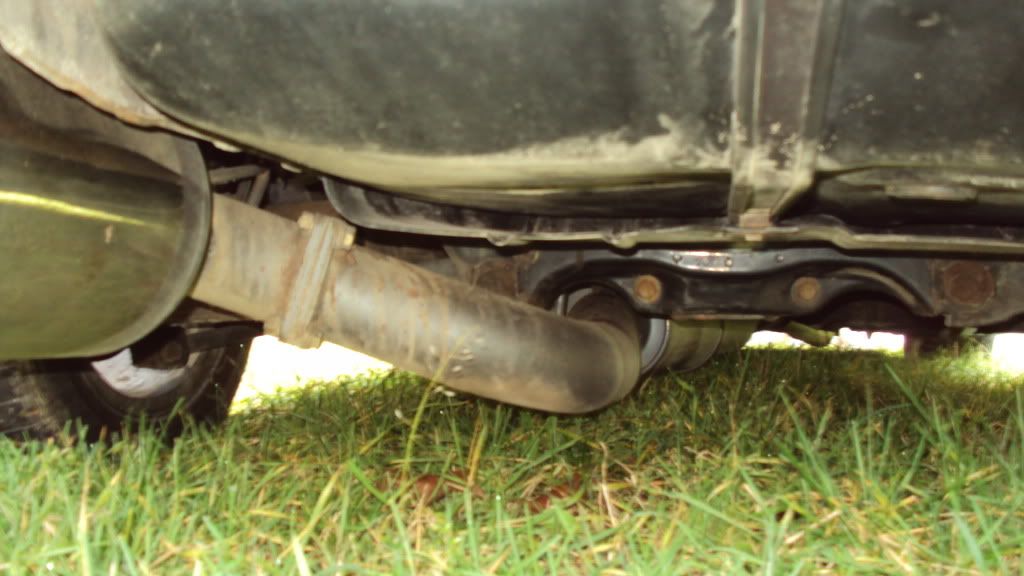

planemos
Apr 22, 2011
559
Slocan Park, BC, Canada
roundfinger
Aug 23, 2006
258
Pensacola, Florida, United States
I like the more stock appearance of the dual tip kits. I've had both the HKS and Raptor racing on previous cars and liked them both, so did my family and neighbors. I even have a raptor racing exhaust sitting in my shed waiting for my next supra to tell you how much I like them. The HKS is a little quieter than the raptor racing. The raptor has a nicer/meaner growl but still tame compared to other exhausts.
