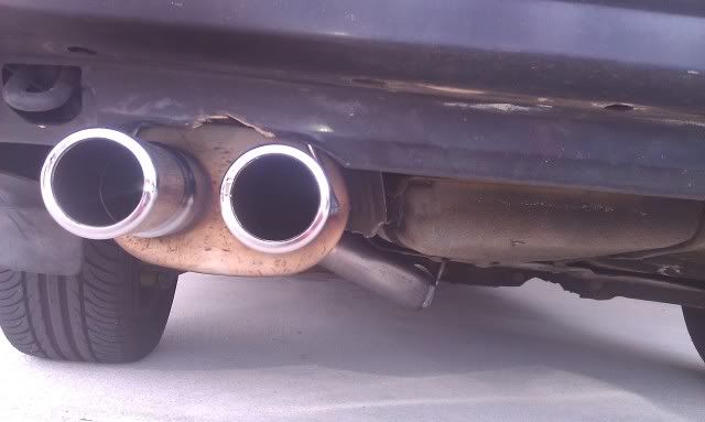

I went to a local exaust shop and had them put together a something for me. 3" from dp back. 3" cat, resonator, 3" inlet muffler w/ nice dual out stock look. Has a nice deep tone but not too loud. All for under 500 installed. shop around untill you find what you like.
