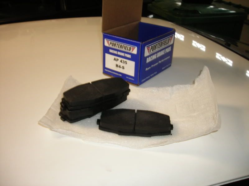

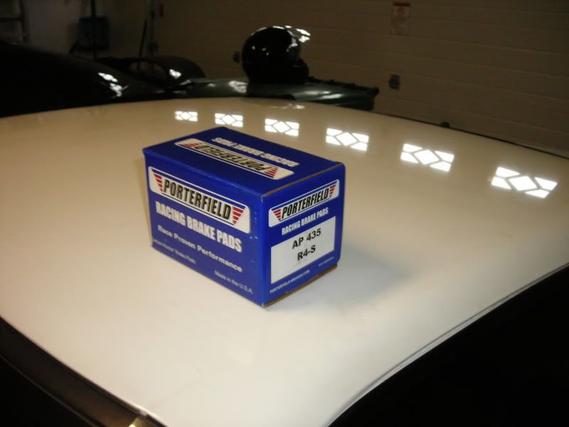

MK3Brent;973362 said:
New brembo gt blanks, and going to try the porterfield R4-S pads.
That's what I'm running.
My only complaints are they started to squeek at low speeds the other day, probably gonna rip them apart and see if I can find what's causing it. And my white wheels don't like the dust too much.
