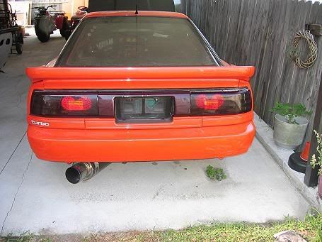

Just did mine two days ago(I did use night shades):
Seth

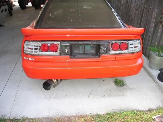

i posted a link to my step by step, that looks like a really cool light setup but i went low-tech on mine. $14 all said and done.
also, i didn't know you could pop the lenses out. any more info on how to do this without screwing everything up?

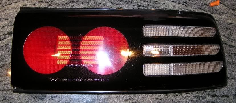

Seperating the taillight lens is not impossible. Also the center section is just clipped in place. Here is a writeup thanks to Ray(Polobai). :bigthumb:
polobai said:
First, remove all the bulb holders, and gasket from the tails. then heat up your household oven to 350 degrees farenheight and grab a cookie pan and some mits. Place the tails with the lense facing UP on the pan,(the studs pointing towards the bottom of the pan) and place in the oven for 4 minuites once the oven has FULLY warmed up. Take the lights out of the oven when done, and place on a cool surface(i used my fridge, but you can use a countertop) and start to pry up the lights CAREFULLY.Now our lights are old, so too much prying will crack the lens right in half(ask how i know) because the glue is so hard. you basically wanna pry up around the whole light and not just work from one side. keep prying the whole way around untill you can put your fingers around both sides of the lense and gently lift off EVENLY, as you lift off, you want to cut the glue with a sharp blade to remove the lense completly. after i cracked my first lense, i found it easier to use a heat gun to keep the glue melted long enough for me to pull off the lense. the second lense came off with no problems. Now to put them back on, place the light housing back in the oven @350 degrees for 3 minuites, to remelt the glue. Then once that is ready, take them out and place the lense back on the housing and make sure they are in there good(gently press then in). you should not have to use new silicone to seal up the housing, the old glue should work fine. you may use silicone if you like to be safe. To place them back on, make sure you heat up the housings in the oven, because i just did it with a heat gun, and a month later one of my lenses fell off and was lost :( -thats why i have the setup i have now for the lights(replica gains covers with custom lenses) let me know if you have any questions on this-but be careful! it helps to practice if you have a tail you dont need(like an <88style or an extra >89 style. thanks!
