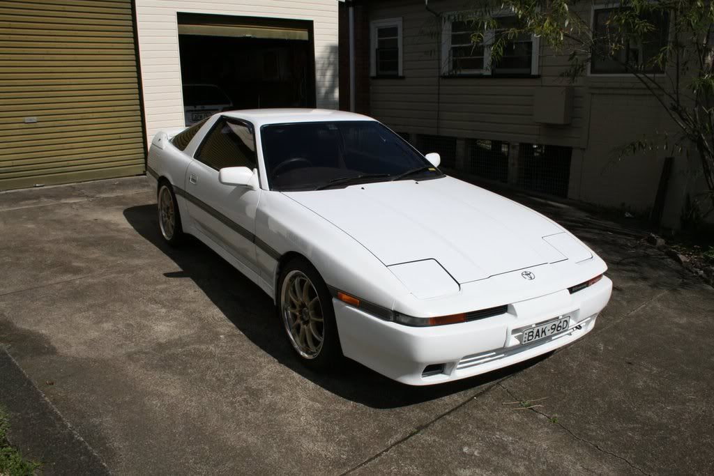

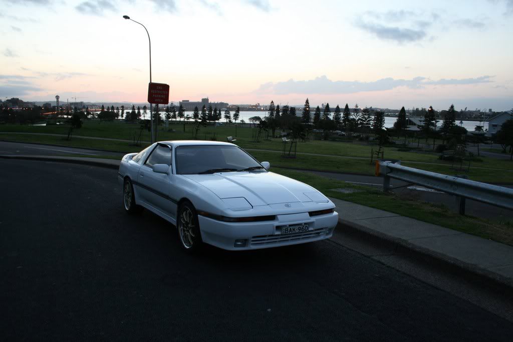

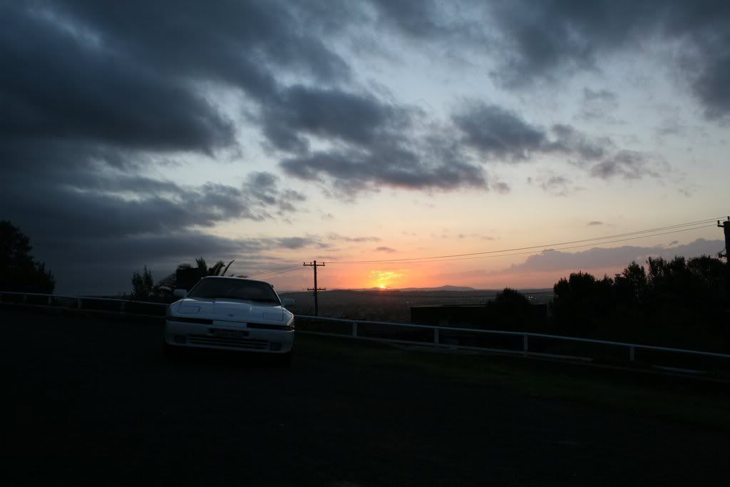

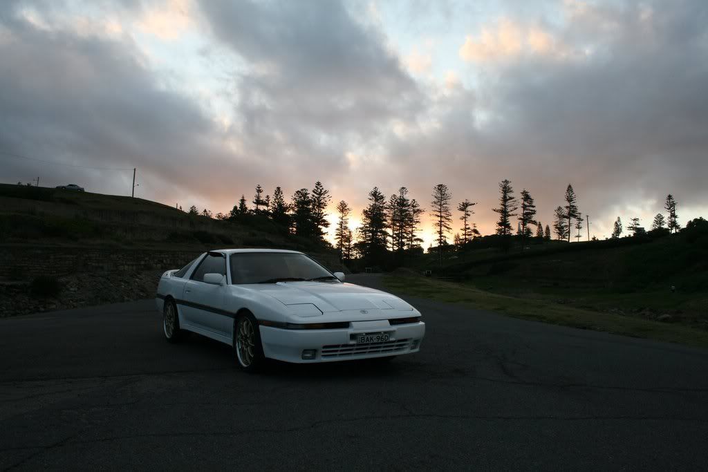

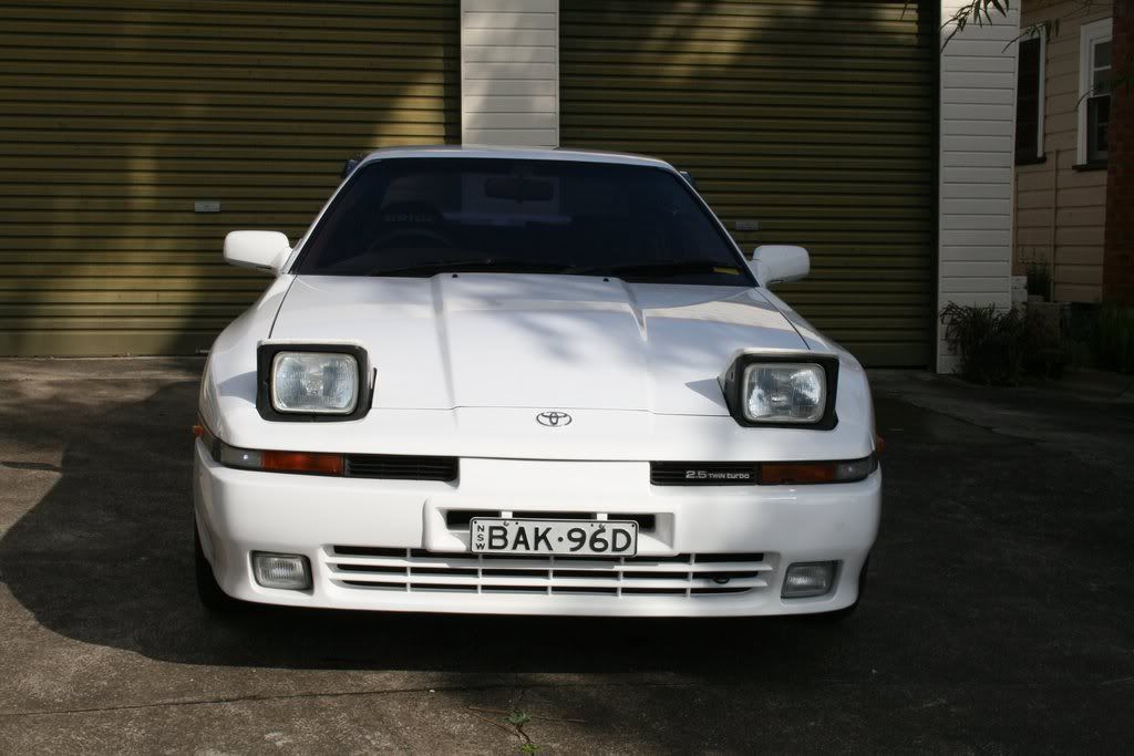

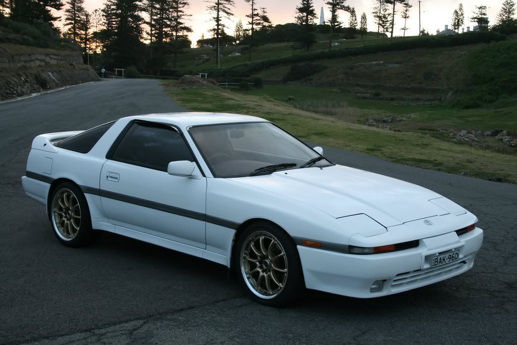

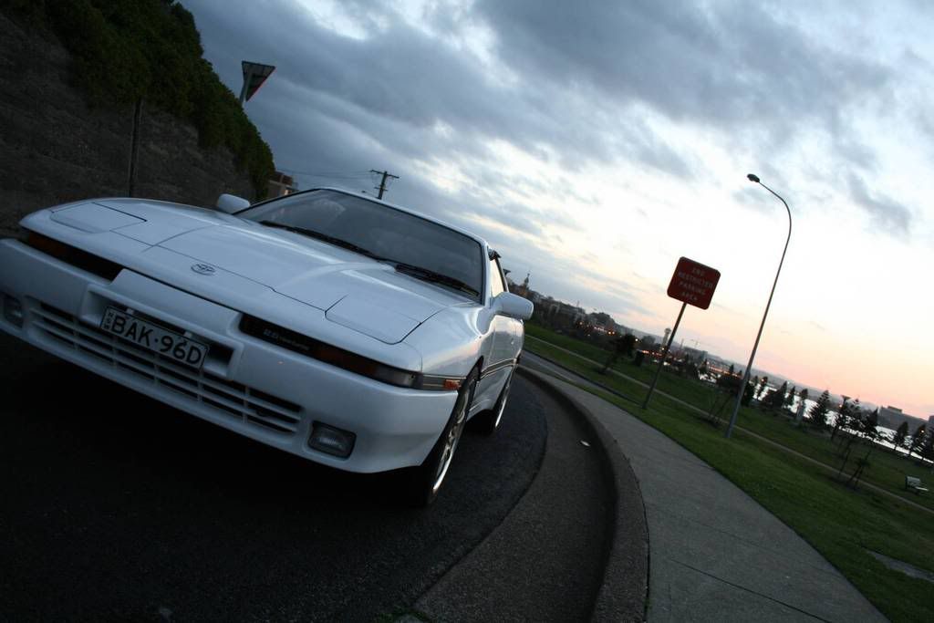

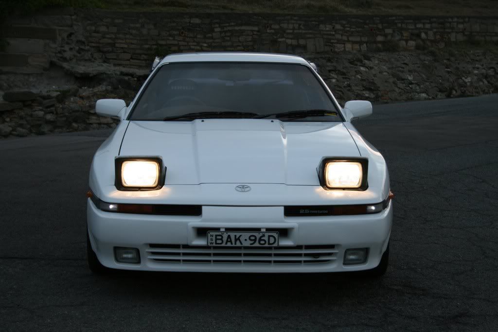

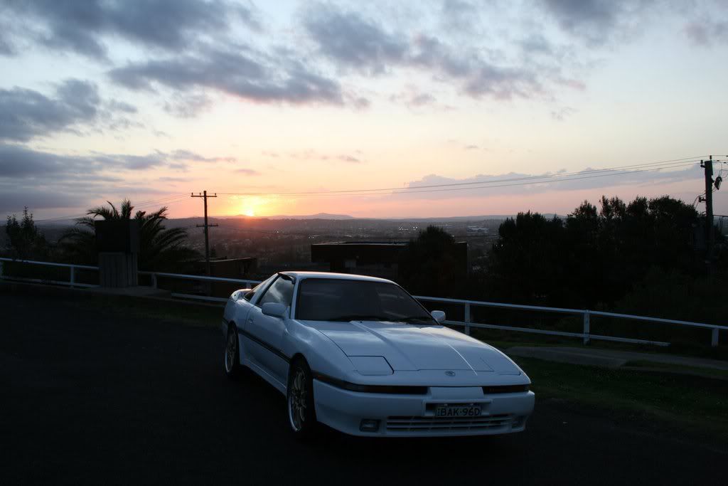

and on happier news ive got a crap load of random pics i need to offload somewhere. and u lucky ppl at supramania get them

woah pato you got a boob shake;) must be good
and def looking the goods since I last saw it... im going to have to get my arse into gear and put my duct in me thinks:D

yea its finally getting back to the way it once was.
definatly need that lip :) so will be heading for that shortly.
