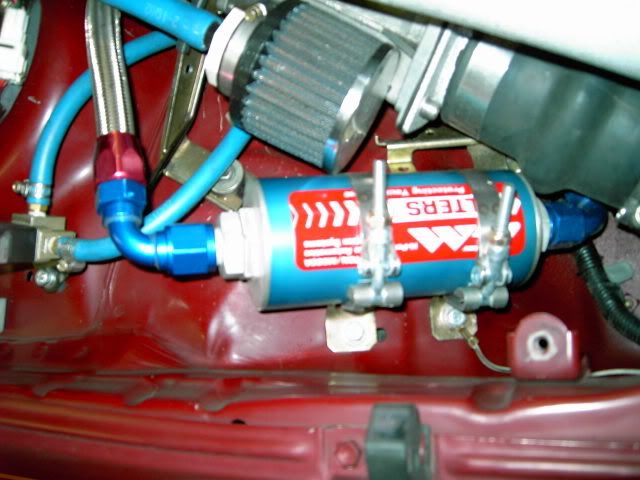

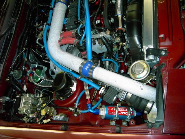

Adjuster
I love how easy the oil changes are on my car. :)
To change the filter, just open the hood, take off a few fittings, and replace the filter. Easy as can be, and if you do it right, it does not drip a drop anywhere. (Push the oil in the filter and cooler into the pan with compressed air after removing the "in" side AN10 fitting, then screw of the upper filter end, and you have a filter that is just wet with oil, and has all the crud trapped in it, but no major amount of old oil left to drip anywhere.)
When I change the bypass filter, I do the same, and it makes it so easy to change them with very little oil mess. (For that one, I just remove it completely after pushing the oil back into the pan too, then change the filter out while the assy. is clamped in my vice.)
Filter is on the apron and has AN10 lines running to it, the bypass filter is where the vapor canister used to mount, and has AN4 lines in and out. (I used the stock oil return for the bypass cooler in the pan to return the oil back to the motor with a larger fitting tapped into the pan.)
Here is a close up of the Canton full flow. I think this is the best location and filter type possible for any 7M. (Depth filters from Canton, and Bypass from Oilguard.) Depth filters don't have a bypass, so your always filtering your oil. They also don't have as much pressure drop across the filter, even when dirty. (Think K&N air filter, it's a depth filter.) The best part is how well they work. Spin on canister filters with paper, or even synthetic filter media generally don't stop stuff much smaller than 20 ro 40 microns. Wear is caused by stuff that is 10 microns or larger. (Some say 8.) The Canton full flow filter is rated to stop particles down to 8 microns or better, and the bypass filter is 1 micron or better. :)

I love your setup, Adjuster. It's the most complicated mess at first glance, but after a minute, it all makes perfect sense.
