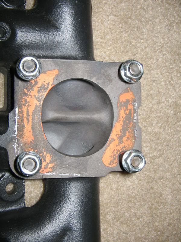

91T breezen'
ROMNEY/RYAN 2012
Apr 4, 2005
1,149
NOYFB!
This one was mildly ported. Now breathing for Grimjacks turbo!
