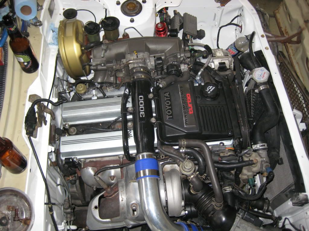

I used an electric fan simply because I had no other option.
Not much room in front of a 7M when it is in the bay of a 1st gen Celica :)
the stock fan would have stuck out the front of my grille!
