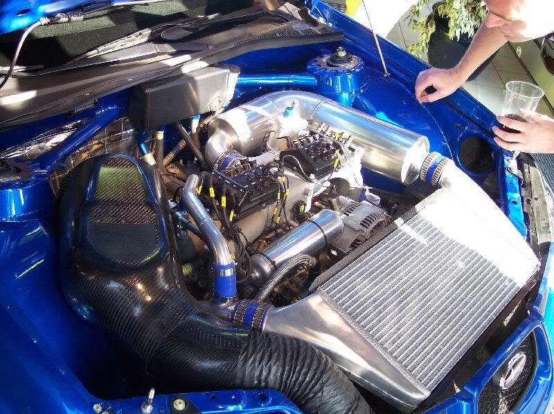

WTF are you on about?
Guess I'm an idiot and just had it all wrong....
Only reason I replaced it was it ran out of flow after 500rwhp, it was superior in every way to an A2A excluding weight.

ROFLMAO :biglaugh: that looks like a very nice set up!!! Though in a normal practical world it looks kind of funny throwing ice and water in your hatch or where ever your ice mix is located!!!:aigo: Not exactly sure on how you had your set up, though to have a big ass air to air with Co2 fogger would do just fine, also have the flexibility of using the Co2 as a fire suppressants :icon_bigg just makes more sense to me, IMO for a Daily Driven Supra thumping some power around :evil2: Super clean set up though!!! I like that a lot!!!!:naughty:
