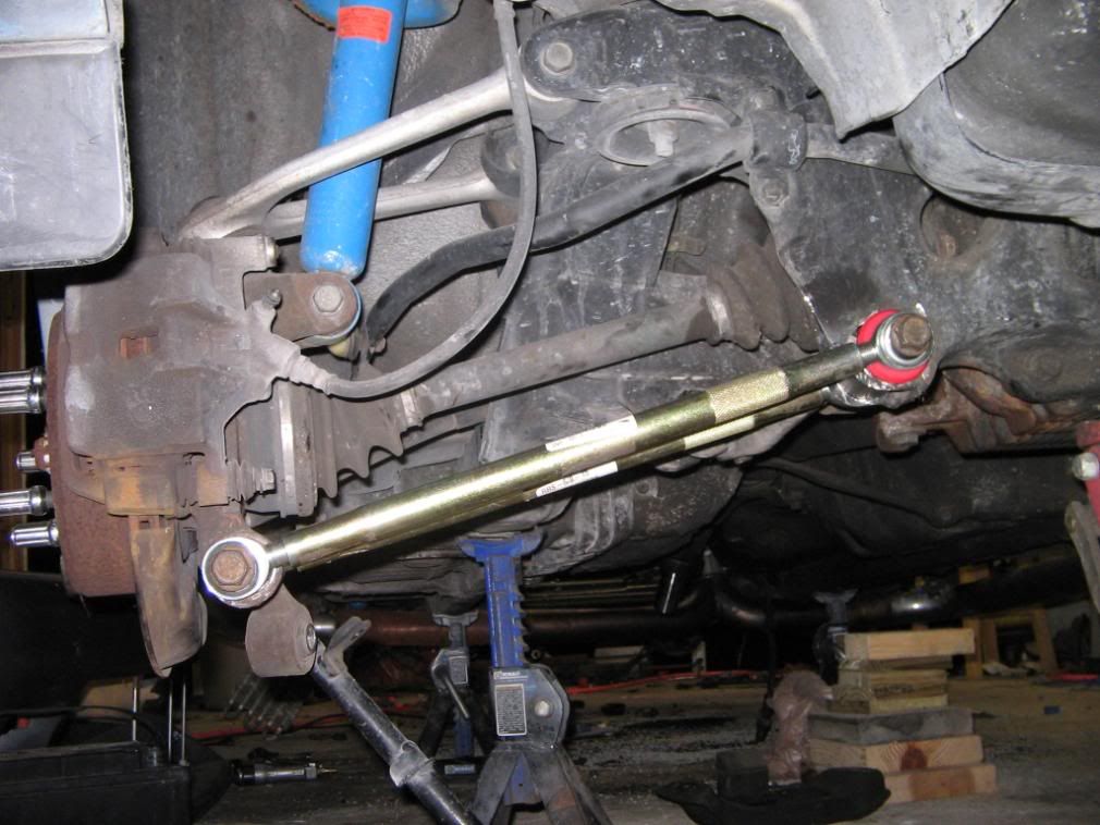

I did my own thing.. People on here dont like but it works for me.. I wanted something stronger then what was offerd and cheaper...Figured 2X the tubes should be stronger then what i could find..
Cost me about 125 or so... I ferget...
Do NOT do this.

Ive got over 5k miles on these arms.. they are in same place same shape and I dont think anyone could push a car much harder then me..Feel Free to tell people DONT DO THIS all you want... bet they are stronger then anything eles out there..and they are not Aluminum.Even the bolts are bigger then the factory ones.
