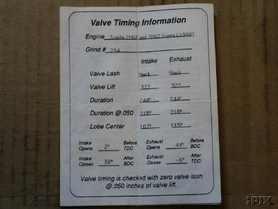

ok, found the info i was after on a cam mfg's website. now we can get reground cams and know what we are getting. schnider does regrinds for $100 each if you send them cams to be reground, or 935motorsports sells them outright with no exchange for $400. the effective duration might be diff from hks's by 1 or 2deg but i dont think itll be an issue. these are advertised duration and effective duration at 0.050"
230deg 209 effective
244deg 218 effective
256deg 226 effective
264deg 236 effective
272deg 250 effective
284deg 256 effective
from a spec sheet ive seen on 7m regrinds
lobe center for intake should be 107deg and lobe center for exhaust should be 115deg
now, its up to you to chose the grind and the lift, then send some cams to be ground or get them from 935. the 244deg cams according to robert work well on a lightly modded 7mgte. id say a 8mm lift would work well with that grind on a upgraded ct26 and no port work on the head. if you have some port work and a smaller turbo(~400rwhp) the 256 would do well again at 8mm lift. i myself and going with 264's with 8.5mm lift as i have had the head seriously worked. i would go 272's, but i plan to drive the car on the street and want the power lower in the rpm range. the 230deg grind look a lil better then stock, so i really wouldnt mess with it. effective duration of stock cams is like 201deg. so prolly stock cams are in the 220deg range from what ive found. hope this info helps some people out.and mods might want to sticky this.

IJ. said:
Will: The "lobe center" thing is a little incorrect.
Lobe center is a measurement between the intake and exhaust lobes.
You're not thinking of "Lobe Centerline" are you?
thats prolly what it actually is, but the picture of the spec sheet showed it actually said lobe center. heres the pic. also, its a lil hard to tell if the intake says 107 or 167

ok, got a reply back form schneider cams. heres what he had to say
264 adv. duration is only 220 to 224 @ ,050" 236 would be about 284 to 288 adv. welded cams $660.00 each with stock base circle. regrind only about .100 off base Jerry C
funny thing is i got those specs from another cam mfg. wonder why they say its only 220deg at 0.050" wonder if its cause of the lobe on the stock cam not having the material on it to go to that duration, or if the other cam grinder is more aggressive. ill check around with some other mfg's.
