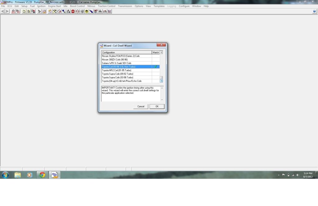

Thought I would ask to see if anyone has a similar setup and can help me out.
97 2gzge na-t (stock ignition)
AEM V1
660cc Hi imp Inj
255wb
3.5 AEM Map
GM IAT
Something to get this thing started atleast. Will be going to the tuners early spring
Appreciate it.

Use the cal file I posted on the FIRST page, you just need to change the ign setup to 2j, like this
