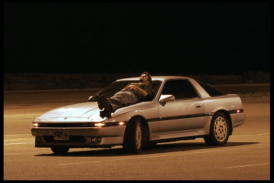

If you want low and don't really care about comfort get RS*R race springs. I didnt even need a spring compressor to get the top mount on, and they are rated at almost 3x the spring rate of stock IIRC. You could sit on my hood and the car didn't move...
RSR tokico combo pic

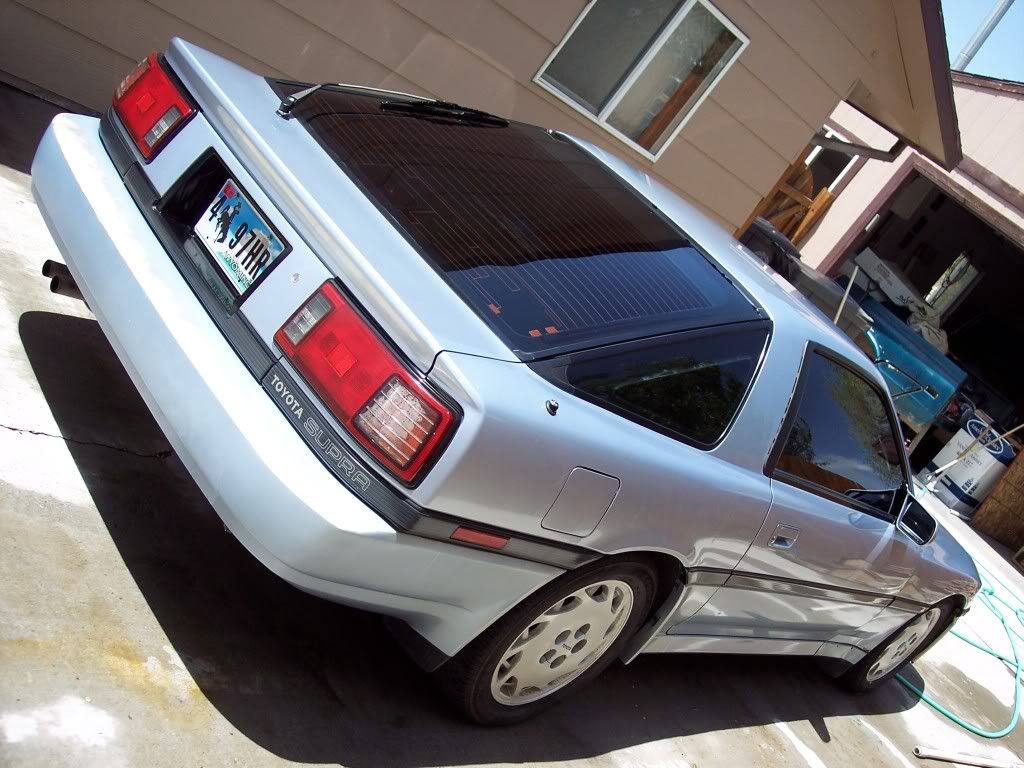

Not exactly perfect pictures for comparison, but my stock lip was BARELY clearing a 5" socket extension. This was on stock 16's.
