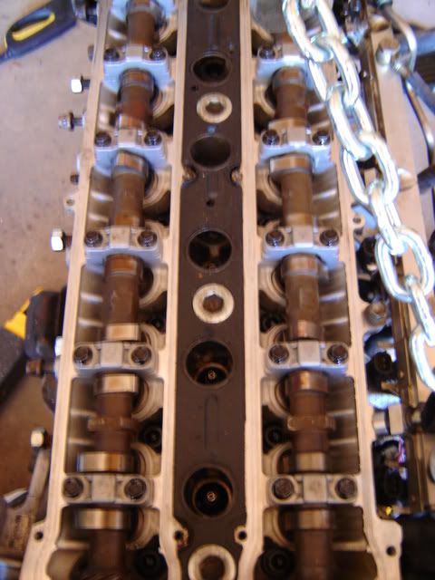

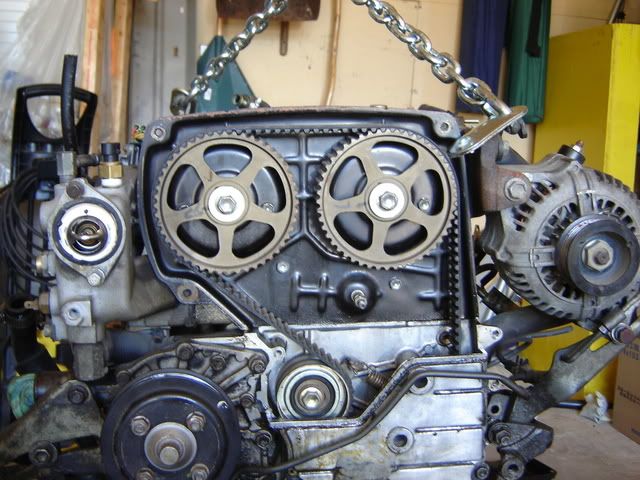

Pulled a lot of the bigger stuff off the spare motor today.
I will be calling a few machine shops on Monday to get a quote on the rebuild cost.
Pics of the motor as of an hour ago:
White tips?
The only thing keeping me outside at 34*c

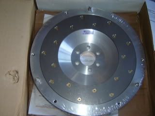

The flywheel-
your typical Fidanza

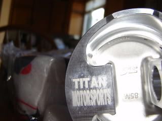

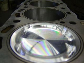

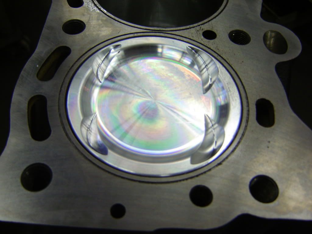

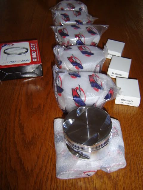

The Pistons!!-
These are JE Pistons .020" over made for Titan Motorsports!!
I was so excited when I got these I was literally shaking.
Didn't pay any fees shipping these across the border and the fees on the stuff I am picking up tomorrow is nothing in compared to what I thought it would be. I have Aaron from Driftmotion to thank for that. Like every one says he is great to deal with and works with his customers.

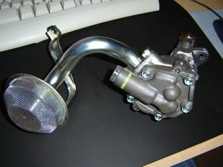

Oil pump-
Going to have to figure out how to shim this open 5mm​

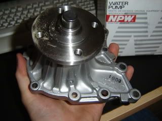

Water pump-
**What is the part number on the water pump?**
I just want to double check as it says NISSAN on the box!​

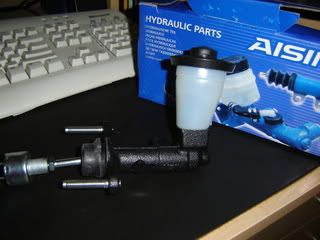

These last two are not nessesary but I thought it was a good idea anyway
Clutch master cylender-

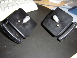

Motor mounts-
Kind of embarrassing but I only ordered one mount (thinking they were sold in pairs) but talked to Aaron and he said not to worry about it. and here they are!

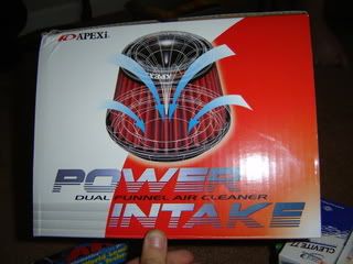

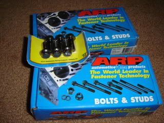

More parts porn.
Most of these speak for them self.

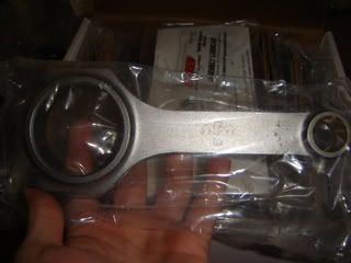

Eagle rods-

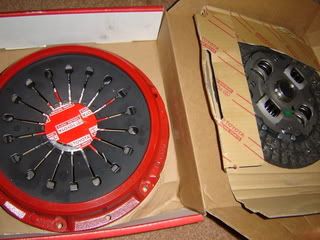

Act Stage 2 clutch-
Cone air cleaner-
ARP head/main/flywheel bolts-

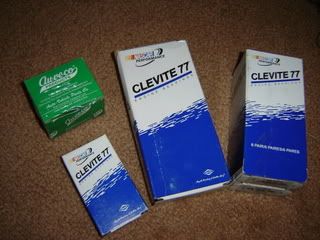

Clevite77 bearings and exhaust studs-

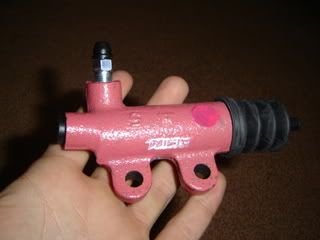

w56 slave cylinder-
Samco rad hose-

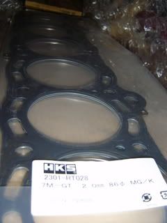

HKS 2.0mm bead mhg-

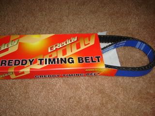

Greddy Timing belt-

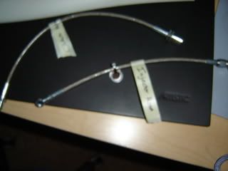

Cold start and Clutch hose-
Power steering hose- mine blew last winter during the -40* spell

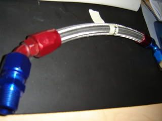

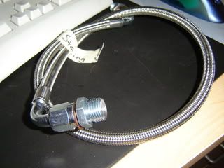

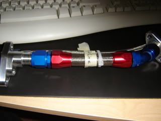

Oil Pump Hose -8 AN-

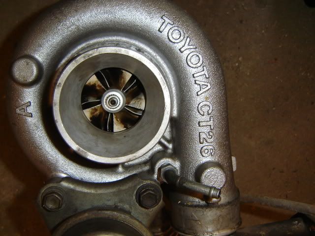

CT26 Oil Softline Kit-
I got the rest of this stuff yesterday I was just to lazy to post it.

The stage 2 because I am going to be running stock tune for a few years. and the w58 slave because.. Im a Freakin idiot.
Some how I just assumed it was a w58 I never realized it was an r154. This makes me happy and sad at the same time.:icon_conf

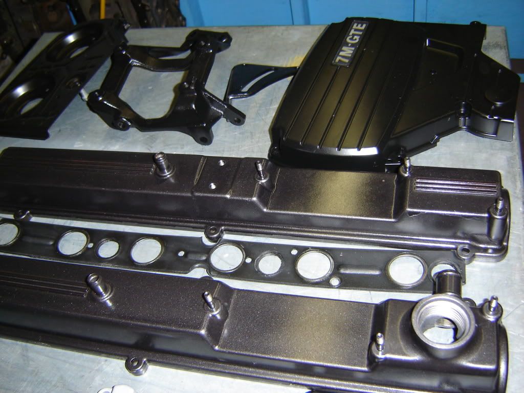

Alright, I had a little we will call it a ‘hiccup’ with the pistons but everything is straightened out now.

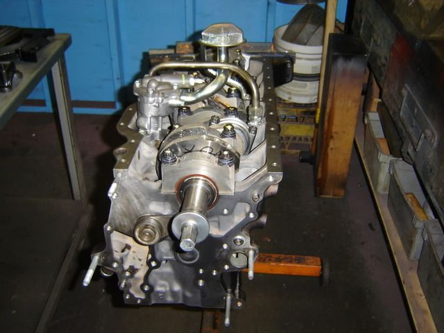

So I stopped by TBS (The Block Shop) today to see if they have had a chance to start on my motor and was pleasantly surprised.
The guy that came up front was the one building my motor, he laughed and told me he just started on it yesterday. We started talking, he was telling me about the 400hp NA 7m he is building for his 4runner (he was just pulling it out of the 87 Supra when I came in) and how he has worked on Toyotas since the ‘70s.

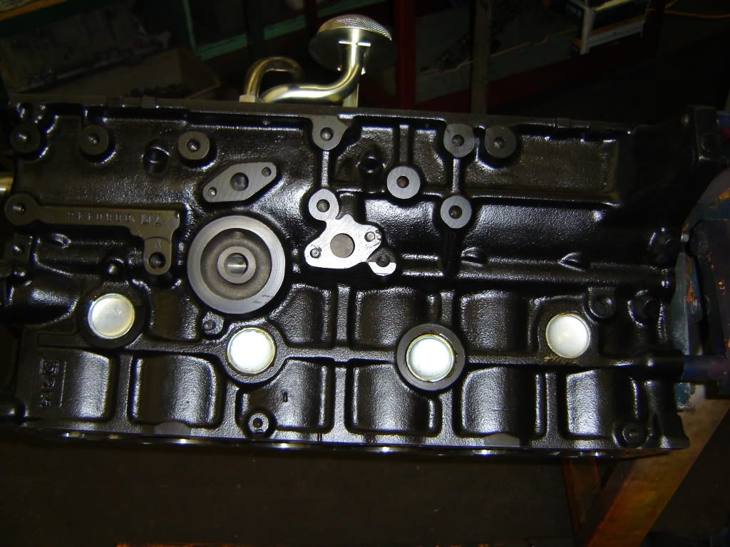

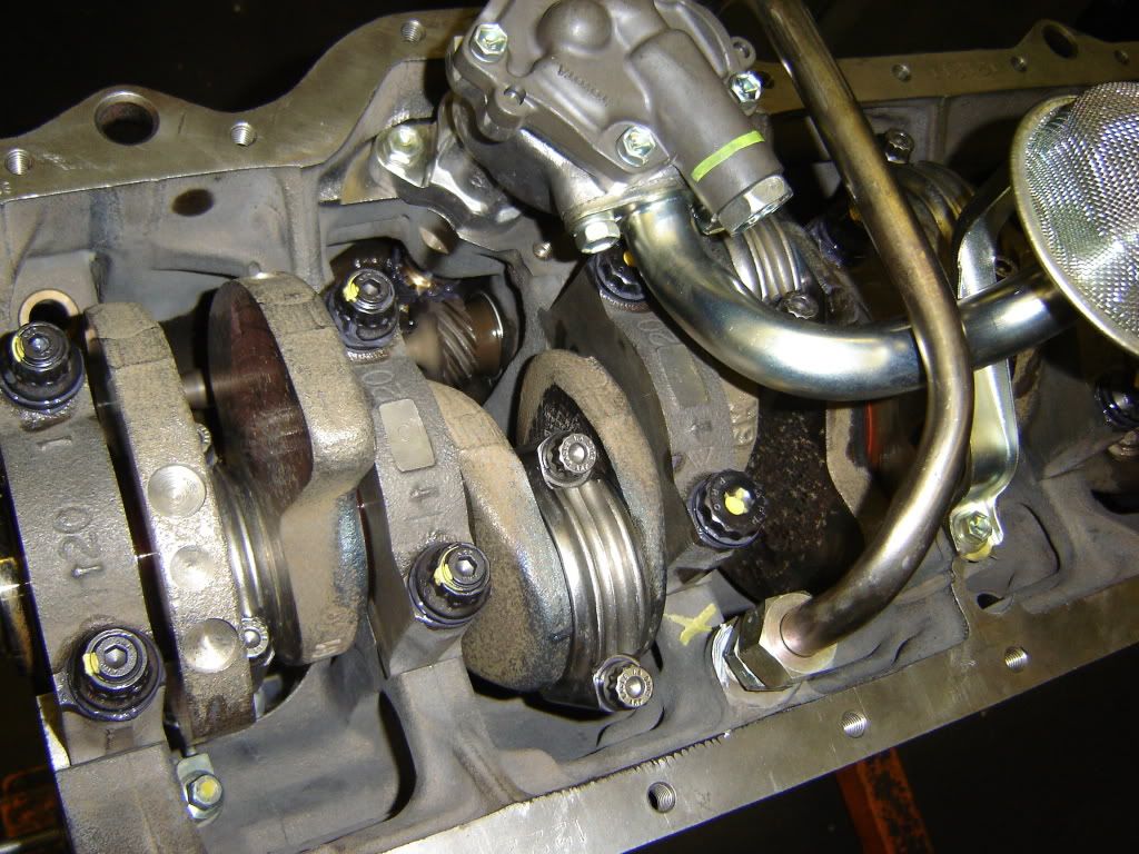

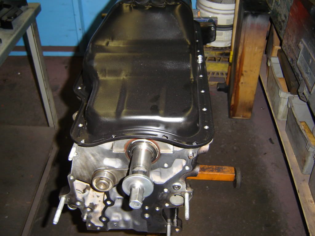

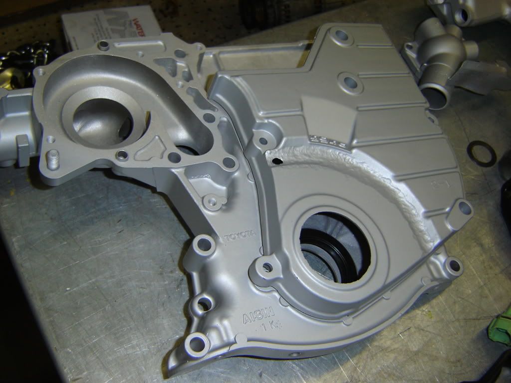

But you don’t care about that, neither do I really but it is reassuring. So he brought me back to see my motor and well.. I had to take pictures.
So Clean
So Very Clean

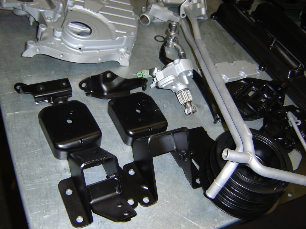

You know how sometimes the little things seem to mean the most?
I didn’t ask them to paint the valve covers, I would have but thought they would send them out to get painted and I would get a $500 bill for it. But they just did it. Same with the harmonic balancer and brackets and things. I love the color too!
Painted oil pan, dusty but painted
Balanced assembly
Everything is together
Painted block, so Sexy!
ooOOooo Shiny!
And Smooth
The guy building it (I should really learn his name) is absolutely meticulous. I should have taken a picture, he had sonic cleaned every bolt and they were neatly standing on a tray.

I'd rather be Pauters
Act Stage 2 clutch-
I hope he's disconnected the clutch switch so I don't kill his thrust bearings
Cone air cleaner-
Please make me a CAI
retorque me after 5 heat cycles please
I'm NDC's

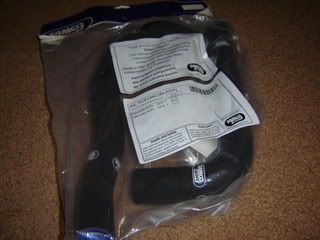

Samco rad hose-
smooth clamps please

Gready Timing belt-
I'm too young to be able to spell Greddy
we're braided
