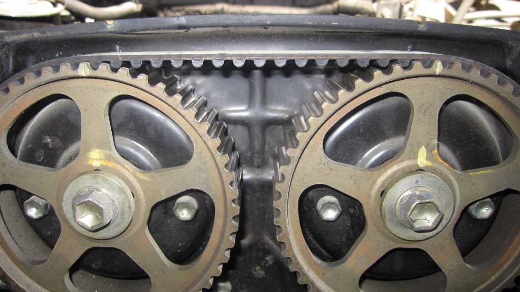

Put the engine at Top Dead Center Cyl 1, Basically look at the front cover where the timing numbers are and rotate the engine by hand with a socket and breaker bar until the line on the crank pulley lines up with the 0, now with the front timing cover off make sure broth cam gear lines are pointing straight up and lined up the the little line on the back cover behind the cam gear.. TDC number 1 cyl should look like this..
It seriously sounds like your cam timing is WAY off..

yep thats exactly what i did... idk its all timed... on the toyota manual, there was a part that said wen its at TDC u should be able to see the top of the cam lobe through the oil fill cap. I cant see the tip, but its just out of sight almost there... r u supposed to actually see the cam lobe tip wen its all lined up?
