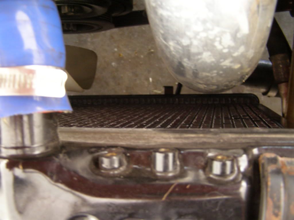

Anyone relocate the ac fans or have another solution. A/c working but won't get really cold with out the two fans. Thanks
Nopaint said:well for my 1J i was using 2 14" fans and it was working great!
tissimo said:what do you mean?
I had fal fans on my 2jz swap and it was cold.. I assume clutch fan and the 2 stock fans would pull as much air....
tissimo said:ahh.. i see what you're saying.. get a stock fan shroud, block off the stock fan holes in the shroud, and put the stock or an aftermarket pusher on the condenser.. it will work good then.. you'll be suprized how much just the shroud will do
