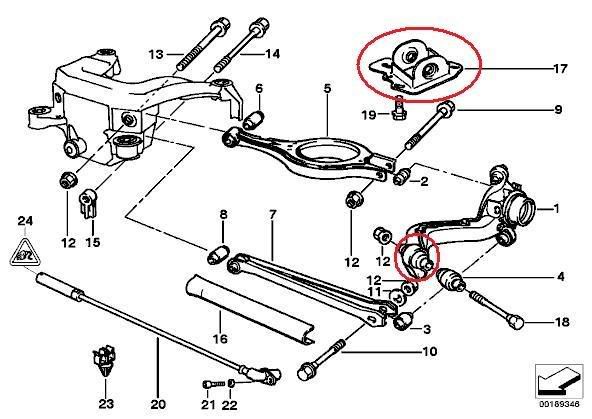

Fail. LOL. Really, they're a great looking car. I just can't get past the crap build quality.
For example: when doing my rear trailing arm bushings today- the lower circle:
That the forward most mounting hole in the unibody (there are only three) had torn almost completely out. (top circle, forward most hole for that bracket right here the #17 is pointing)
So, my cousin lucky for me, my cousin was around- he came over after I cleaned it up and removed the undercoat. Now it's securely welded back in place. What a PITA! It wasn't a pretty weld, but I'm damn sure it's not going anywhere now. LOL. (Ian- you're right- mig welding upside down sucks!)

LOL FUCK that!
I was grinding down the welds to make them flush with that threaded insert, and I got hot metal shavings all over my stomach and face- this was only a few minutes after he finished welding it so it was hot from that, AND from grinding! Not fun!
