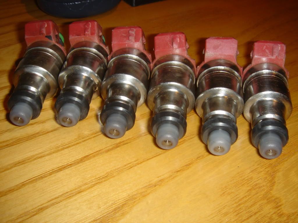

the whole reason i started this thread was because i came across this:
ND made some low impedance 550s which are direct fit for the MKIII's fuel rail. Their part number is: 195500-1370. BE CAREFUL! for some reason ND used this same part number for their high impedance 450cc injector too. How do you distingush between the two? Look at the notch on the top of the injector connector-if it is in the center its low impedance, if its offset to the side, its high impedance.

That weird, this throws me all off.
The seller DID say they were flow tested. no results of that of course.
Looks like i gotta send Nippindenso an email.

Sorry Rob, i got very irritated after reading that info about part number misconception.
Frankly, I don't know how it came about based on some more info i found with these ID sheets.
http://www.robietherobot.com/Storm/fuelinjectorguide.htm
http://www.injectorrx.com/densotf.html
i'm thoroughly confused about this whole thing and didn't want to spend more money to flow test them, but based on this info, ithey're supposed to be 550s.
I'm gonna get them flowed and report back to straighten this out.

UPDATE:
Yesterday i went to a speed shop near me to get my injectors looked at, flowed, cleaned if necessary. Was an old school carb shop, cool people.
I got a call back today. The guy asks me where the hell i got these injectors. He says he ran them on the machine and they overflowed his machine! He was warning me about washing out my cylinders and that last time he seen injectors that flowed like this, they were alcohol injectors.
I never really got a number of what they were flowing but he says they were all consistant and even. He pulsed them at 30 or 40psi (i forget).
He said fueling wouldn't be a problem, but i really wish i had a number to go by. Im just a little confused on how i thought they were smaller than what i got and here i find out they're some kind of super injectors..
They put new O-rings and grommets and pintle caps on em.
