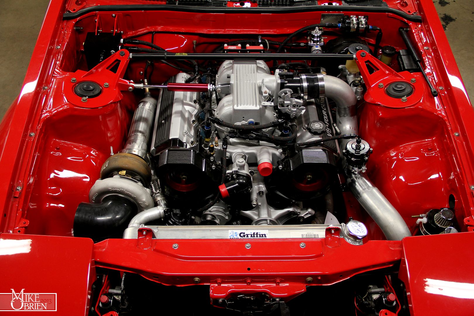

Check out Mike O'Brien's 1uz build
http://www.celicasupra.com/forums/showthread.php?56444-Mike-s-(Supersubs-s)-Big-Boy-Build/page42
Chambers
Now you know
Sep 9, 2007
981
34
Baltimore County, Maryland
/\ I wish i had that much room in my engine bay! Plumbing a single turbo is still a pita, I tried. Although the SBC isnt nearly as wide, so it may be much easier.
There is a website floating around where a guy built a 350 Supra with two turbos mounted down on the sides of the block, that puts a new definition to "block huggers" hahaha. I wouldn’t begin to think about doing anything like that with the 1UZ without hacking the body to shit, and I just won’t do that.
