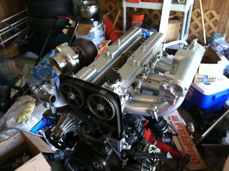

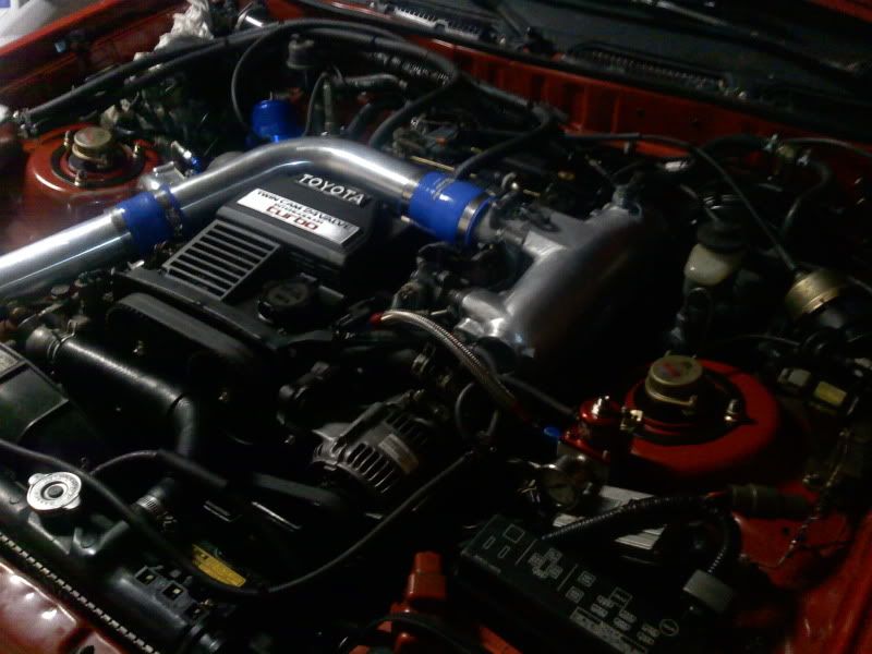

Got the valve cover and intake manifold back, look pretty nice. Got a little more done today after work.

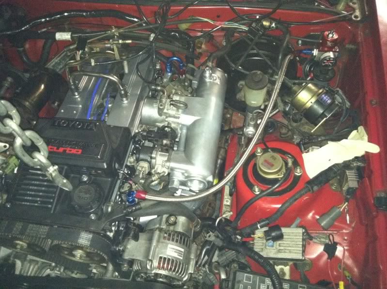

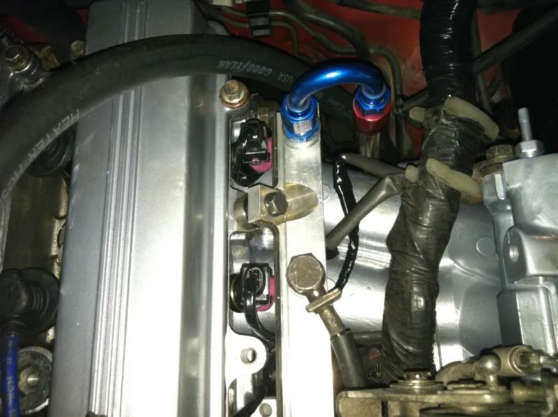

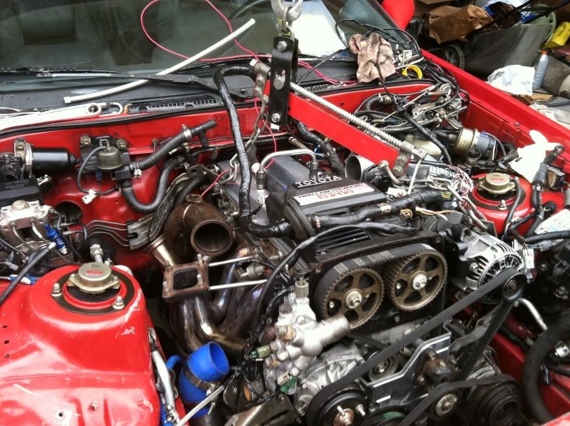

Little update. Didnt plan to get alot done today, went under the supra bolted some bolts and the drive shalf to the trans. Redid my feed line, re-route my regulater and lines. I think this look better than before.
Before...........
After.............

Looks good. Did you Switch to a dual feed setup? Or is that the return? I am also building a 67 7m with 880cc injectors and am wondering if i should go with dual feed...

No, not dual set up yet. Just a single walbro fuel pump at the moment. Just planning to push around 500whp. But will upgarade later when i throw in another pump and a better engine management. If u are planning to push over 600whp and with those big injectors u should go dual feed line and two pumps.

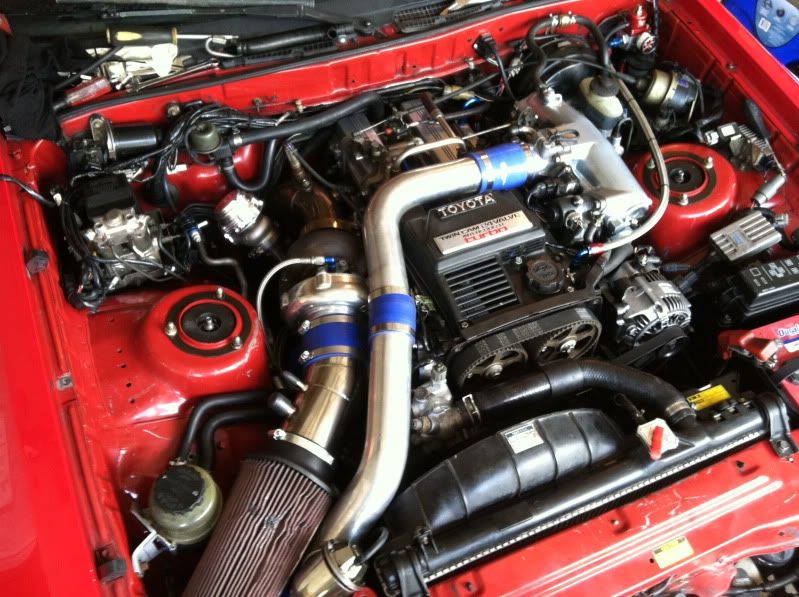

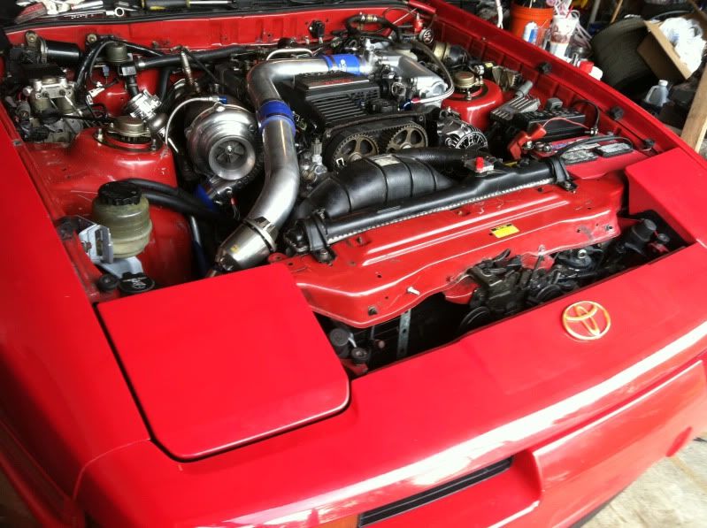

Did some work today, almost done with the supra. Put most of the parts back together. I converted to the non turbo power reserver, look better now. Before I had the reserver by the front and it was making noise cause its lower then the factory spot. Also did some tuck in wires and clean up a bit in the bay. Almost done, just got some more wires to rewired and some oil, coolant, power steering fluid, trans fluid, clutch fluid, and the supra will on its way.
