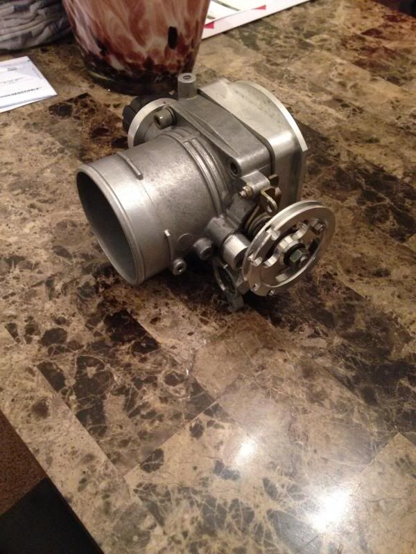

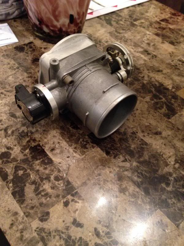

mk3turbo;2004461 said:
Did a little modification to the q45 throttle body. The throttle body cable bracket was hitting the power steering pump so i modified it like this to clear it. This is a very tight fit. Also the tps has to be custom fit.
Any insight you can give me about the throttle body bracket? I am running into the same issue where it is hitting the power steering
Btw. Nice build. I'm almost done with mines, just running into small little issues to address.
Thanks
The factory q45 bracket was hitting the power steering and lower runner so i use an aftermarket tb wheel bracket.

So you just removed all the old brackets and the new one just bolted on? Did you have to modify anything? Also if you remember where you got it could you provide a link?
That wheel tb bracket is from an ebay 90mm tb i got laying around. There is a few things i had to modified, drilling and cutting to make it work.
