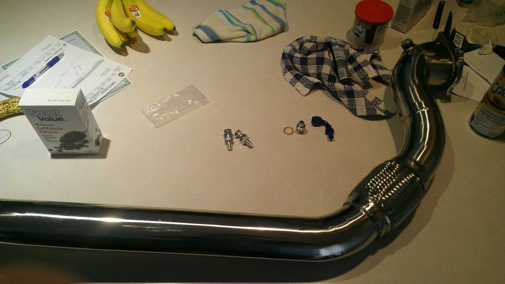

I didn't get any pictures of the little adapter I had Lincoln Clutch and Brake make me, but that's because its quite boring. I did, however, get pictures of NEW SHINY THINGS!
So, Driftmotion 3 inch widemouth downpipe, 17x1.5 ~ -6 adapter, 16 mm crush washer (fits better than the 17), a -6 ~ pushlock adapter, and nuts and bolts for the downpipe. Not a very big package, but fun none the less.
So back to the fuel line story. SOMEWHERE along the line, somebody misplaced the banjo bolt for the fuel feed flex line. So after getting very pissed off (more so than I should have...) I decided to drain the coolant from the block, because I'm switching from green to red. It's not Toyota red, but something along the lines of Valvoline G-01 rings a bell... But the coolant drain plug just will NOT bust loose. So after getting frustrated with that, I decided to try to hook up my power steering cooler.. And I didn't buy enough hose. :: angry :::: angry :::: angry ::

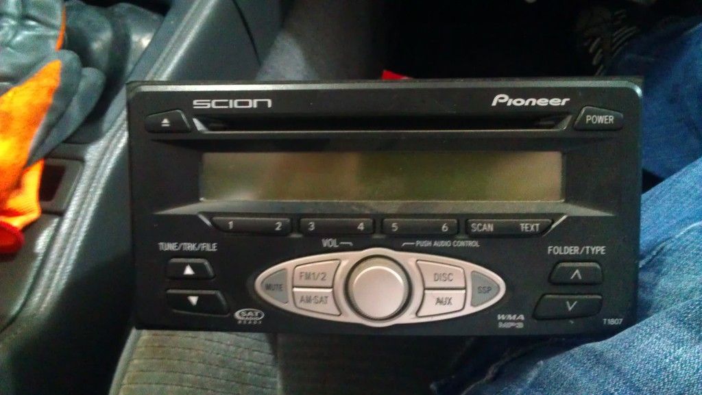

So now I have another choice to make.. My lovely midrange JVC headunit, or this lovely pioneer head unit. I have subs, so I would rather use RCAs, but using speaker level doesn't really bother me much.. Unless somebody can persuade me otherwise. The only thing that would bother me is if the Scion head unit doesn't output all frequencies. Like say it stops at 30hz. That would bug the ever living shit out of me. But, on the other hand.. It does output sound to all SIX speakers... Which is very, very nice. I'm honestly torn between both head units.

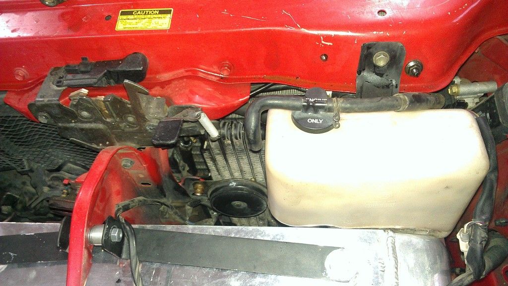

So, I started off the day with mounting the factory oil cooler as my new power steering cooler. The front end is filling up very quickly! I'm pleased with how factory it looks, and how perfect it fits.
I'm surprised at how many people complain about relocating things. It was very simple to heat up the coolant res and deform it a little bit to make room for the intercooler, and it just took a little bit of creativity to think of how to relocate the oil cooler.. I bolted it from behind the horn mount with a long bolt, and then bolted the horn to the part of the bolt protruding.. Simple really..

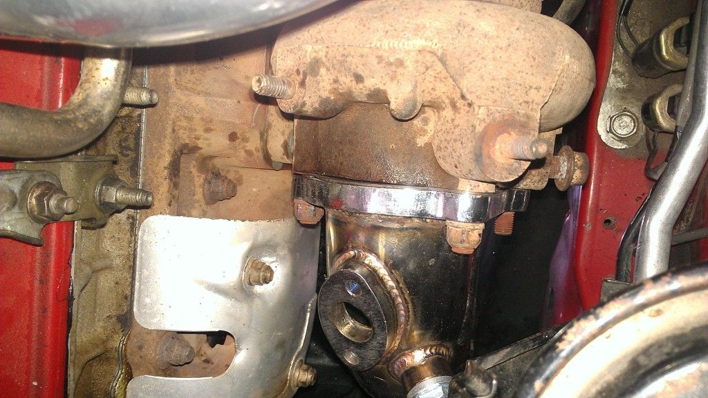

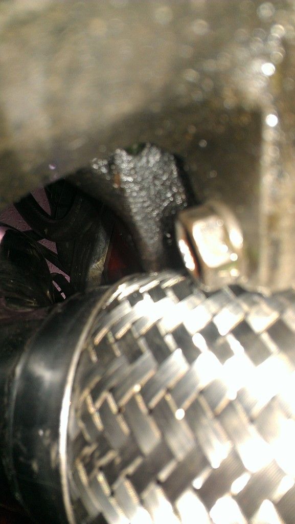

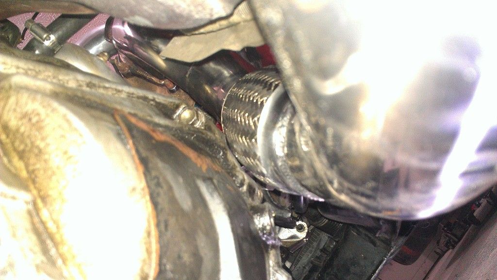

After that, I decided I would mount my DM downpipe. This was a true disappointment. I didn't think it was all that bad at first, and I called Aaron regarding the fitment, and he said the cat back will hold everything in the place it will need to be. So trusting him, I bolted it up. The gap between the dp and the turbo never closed completely.
Wondering why, I crawled under the car, and this is what I saw.
It's within a millimeter of hitting the bellhousing. While this wouldn't really be a big deal, as I could have just ground a little bit off the bellhousing, THIS is what is going to make me return this downpipe.
The flex section hits the block hard enough that if I ground enough away, the bolt hole for the transmission would be far too weak. If you look closely, you can see the flex section actually deforming around the block. This is simply unacceptable. Hopefully it was a manufacturing defect and Aaron can send me a new one free of charge...

I read that the turbo outlet flange tends to be deformed during the welding process, and it causes it to have gaps. The solution was to have it resurfaced.
I would expect that if you had the face of the flange resurfaced slightly, and so that it angled towards the outside edge(side facing the inner fender), that it
would also cause the entire DP to move away from the block. Should you have to do this? No, of course not. I would call to return it on DM's dime, and have
them ship you a new one, also on their dime, and let them know that if the next one doesn't fit right, it's going to cost DM another shipping fee to take it back,
so they MIGHT wanna verify it's fitment first...

Aaron said I could PROBABLY hollow out the bolt holes on the downpipe and shift it over a little bit.. but I'm thinking of just welding up the crack in the factory downpipe, and exchanging the DM one for one that fits. The only reason I'd bother with fixing the factory downpipe would be so I can drive my car..

It's not just the flange being warped, it's just the fact that the downpipe is hitting the transmission and that's not letting it bolt up completely.

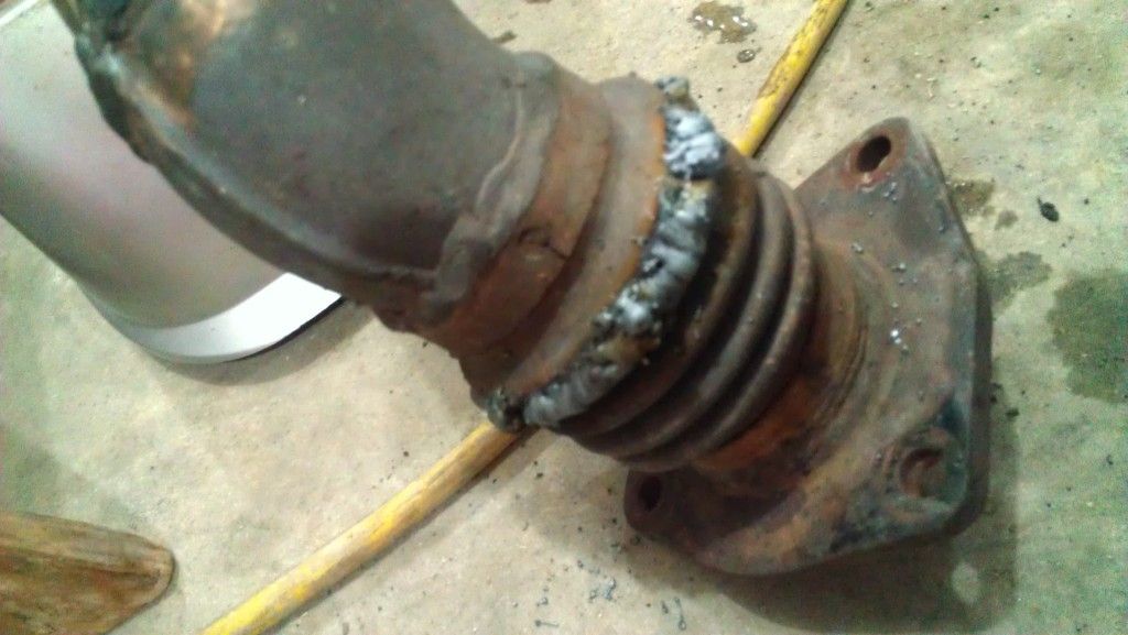

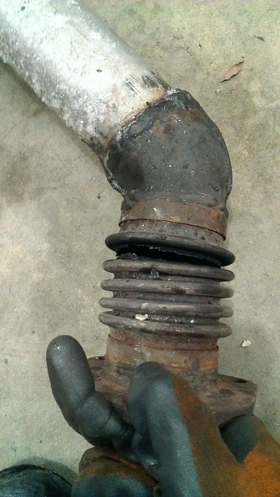

Well I tried flattening out the flange on the DP and it was the same fitment. I also elongated the bolt holes and yet again, nearly the same fitment. So I'll be having DM send me a new one on Monday. But for the time being... The problem:
Even though my welds are quite possibly the worst welds in the world, they will seal better than the giant gaping crack. Feel free to laugh.
It's only temporary, right? Haha
Anyway, I bolted up the downpipe and elbow and wired in my 5.0 Mustang O2 sensor, and this ensued.
