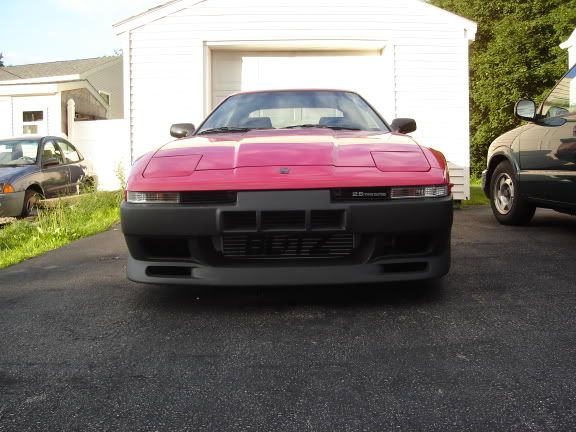

does anyone have any tips to removing this part of the grill? i have a shiny new frontmount, and i would like to show it off. is it doable, or am i better off just buying a whole front bumper? or should i just be modest and hide my fmic

The easiest way is to get out your cutting tool of choice and just start cutting.
Of course that will leave these ugly "V"s in the bumper where you made the cuts.
Some people have used Bondo to fill in the "V"s but bondo doesn't flex - the bumper does - and they fall out pretty quickly.
The correct way is to use a filler that is made for urethane bumpers.
I used this - http://www.urethanesupply.com/mm5/m...ore_Code=URE&Product_Code=5210&Category_Code= - to fill in the holes but it doesn't feather out nicely...
So I sanded that lower than the rest of the surface and then filled in with this - http://www.urethanesupply.com/mm5/m...e_Code=URE&Product_Code=2000-T&Category_Code= - This will sand out nicely and then is ready for painting.
The problem becomes that the lower lip now has no support. I have a beam in mine

i wouldn't cut that bumper,looks way to nice.i have a white bumper you can play with before hacking that one.

yes modest is the way to go...
even though cutting it out and filling in the hack marks can be done, like Keith said, your bumper will be lacking support on the lower half and will look terrible if you dont take the time to do it right.

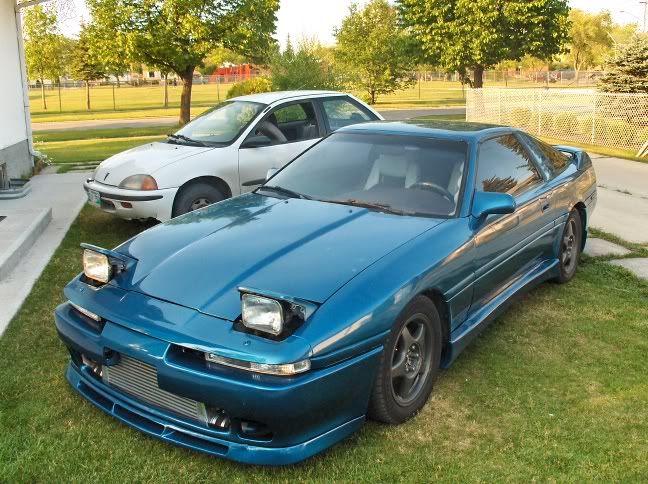

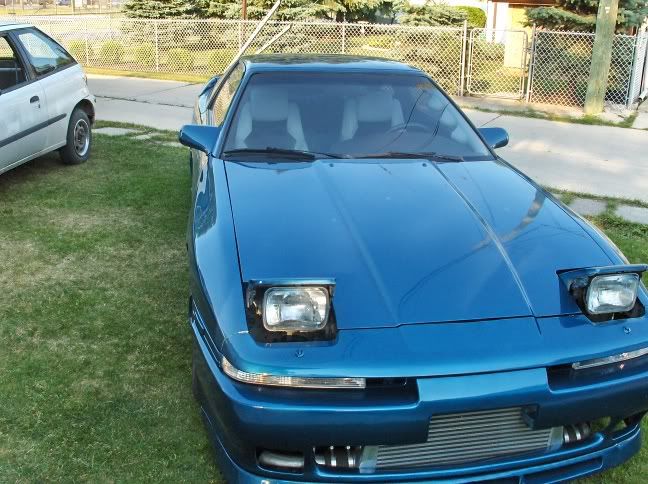

if u do it right it doesnt look bad and looks sick with the front mount!!
here's some of my old soupie!
i personaly think it's worth the effort
