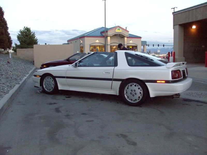

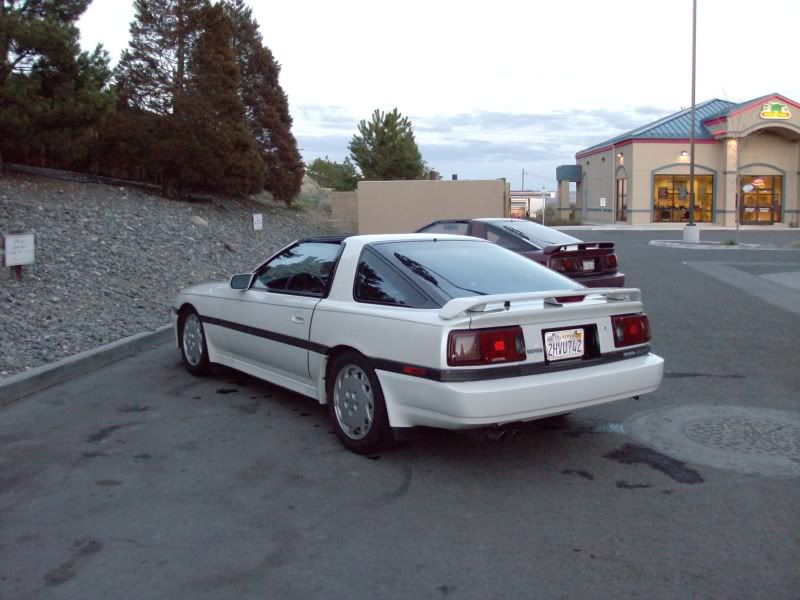

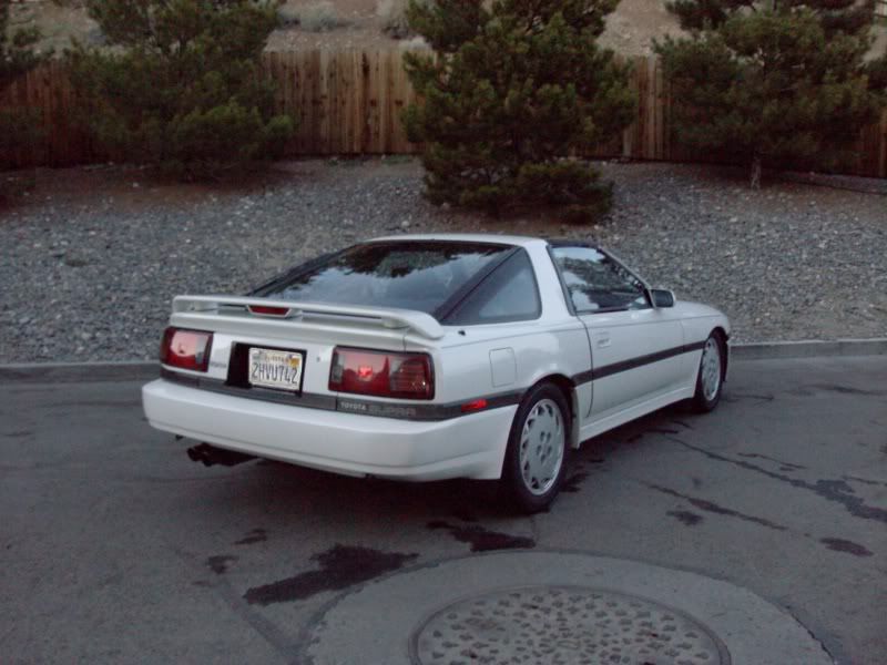

Well I finally got pictures of the drop. Gosh its so nice having her back. I had to keep her in storage in the bay area over winter. I didnt want the cold to toast my motor...and I also found out turbos, traction, and snow arent very good friends. Haha!

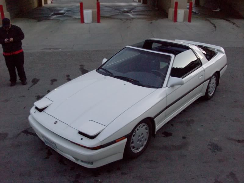

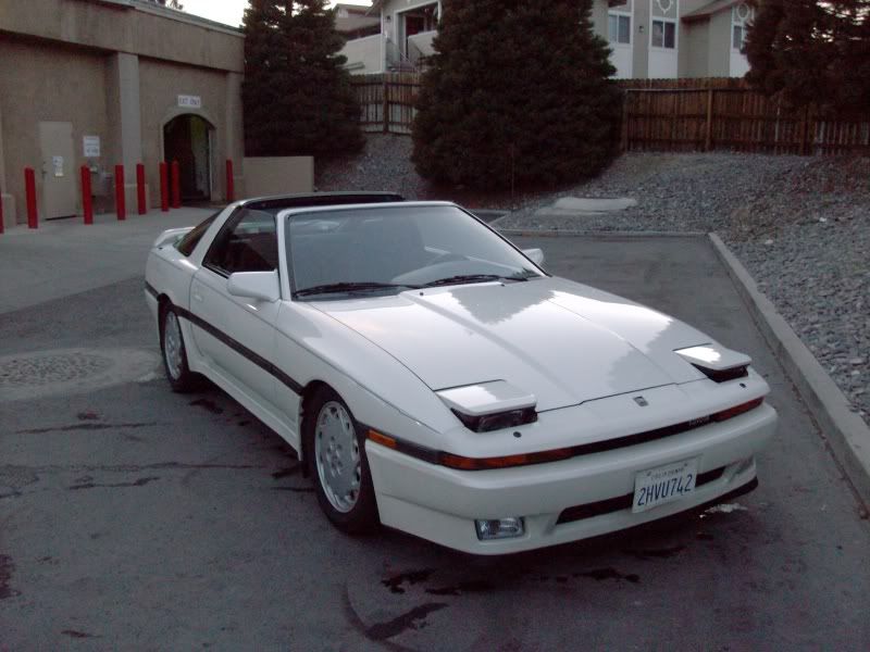

It was getting to be dark and she had a long day so she was tired. :) Haha no I think they look cool for some shots and others not so much. So its just if I think it looks better at the moment or not. I havent hacked any wiring or anything to get them like that.
