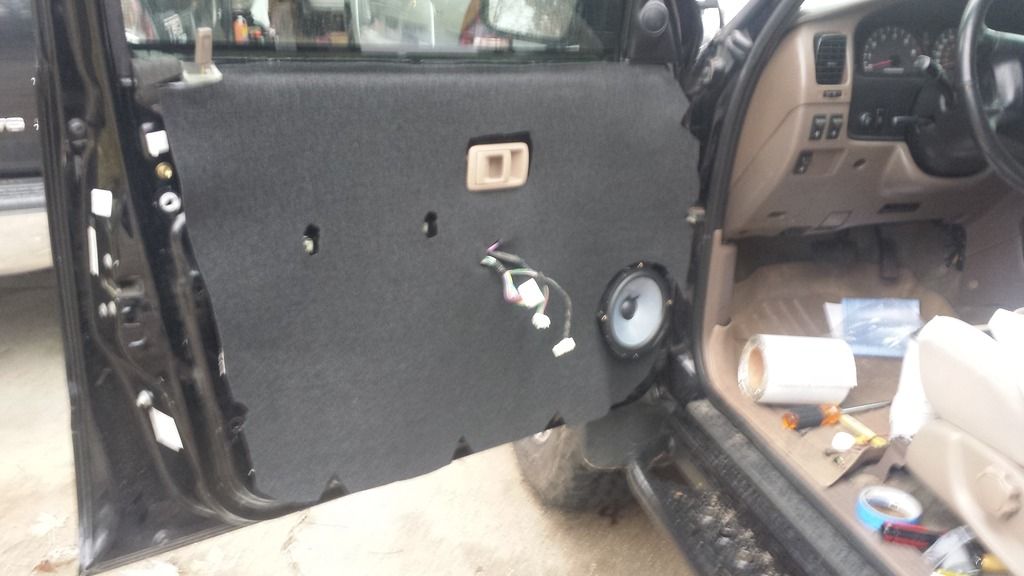

I'm about to order a bunch of sound deadner materials for the 4Runner and Supra together at the same time and hopefully do that this fall, maybe that will help with the slight drone from the exhaust. I also ordered all the parts to do the timing belt, water pump, tensioner, idlers, radiator, and some other maintenance stuff on the 4Runner. I'm gonna do that myself and save the $1500 extra everywhere wanted for labor. That will be my first big project like that, and the 5vz in the 4Runner is really easy to work on, so if that goes well I will probably order the stuff to do the timing belt and valve stem seals on the Supra as well and try and attempt that myself to get rid of the oil burning every time I start it.

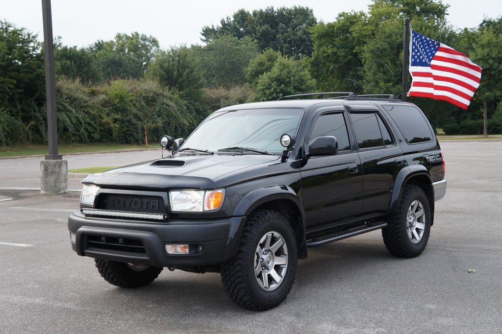

In August I drove down to Gulf Shores flying the best flag in the world behind me all the way.

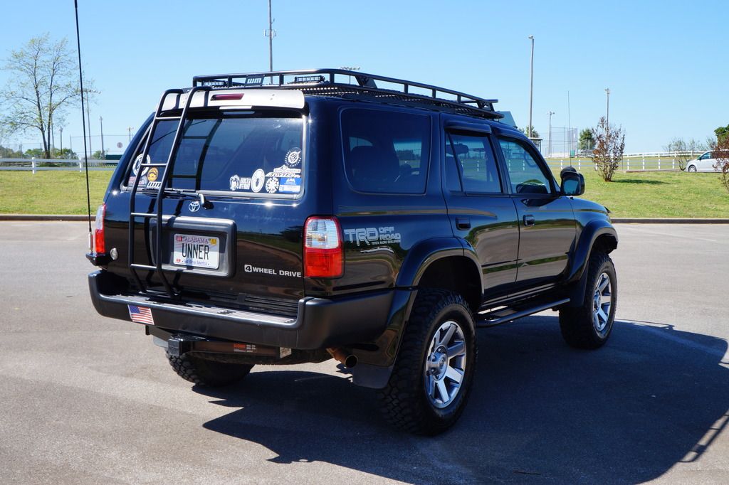

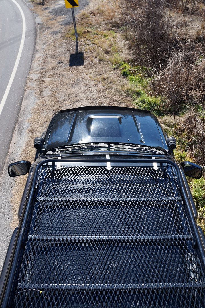

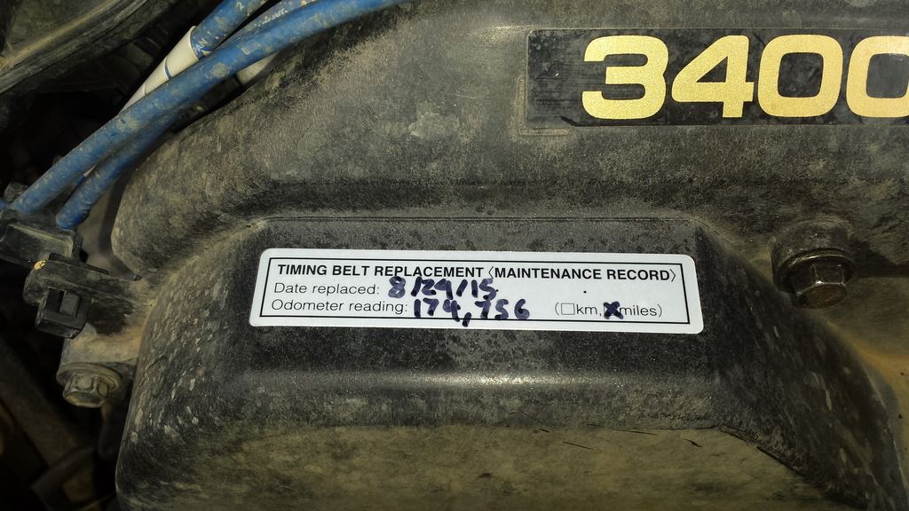

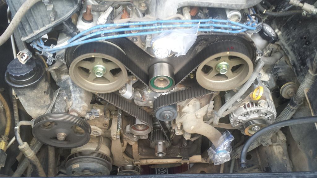

Then in September I picked up my full length roof rack and made my custom wind fairing for it. Did a timing belt, water pump, radiator, all that good stuff at some point too. I also added an amp to the radio and put JL components up front along with sound deadening. Also installed an accessory fuse box and rewired the battery, alternator, and all the grounds for them.

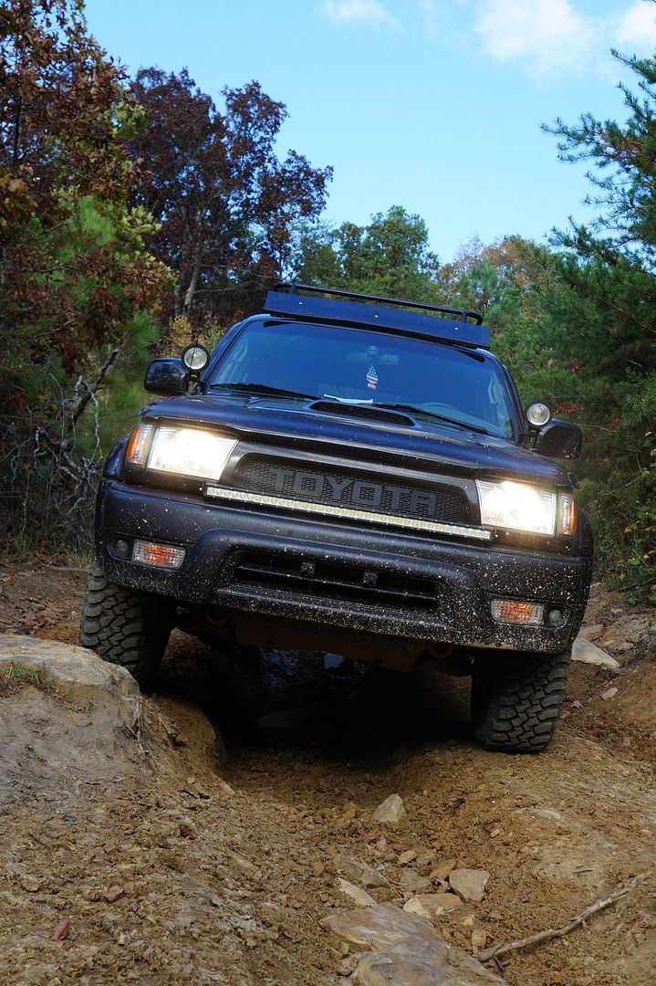

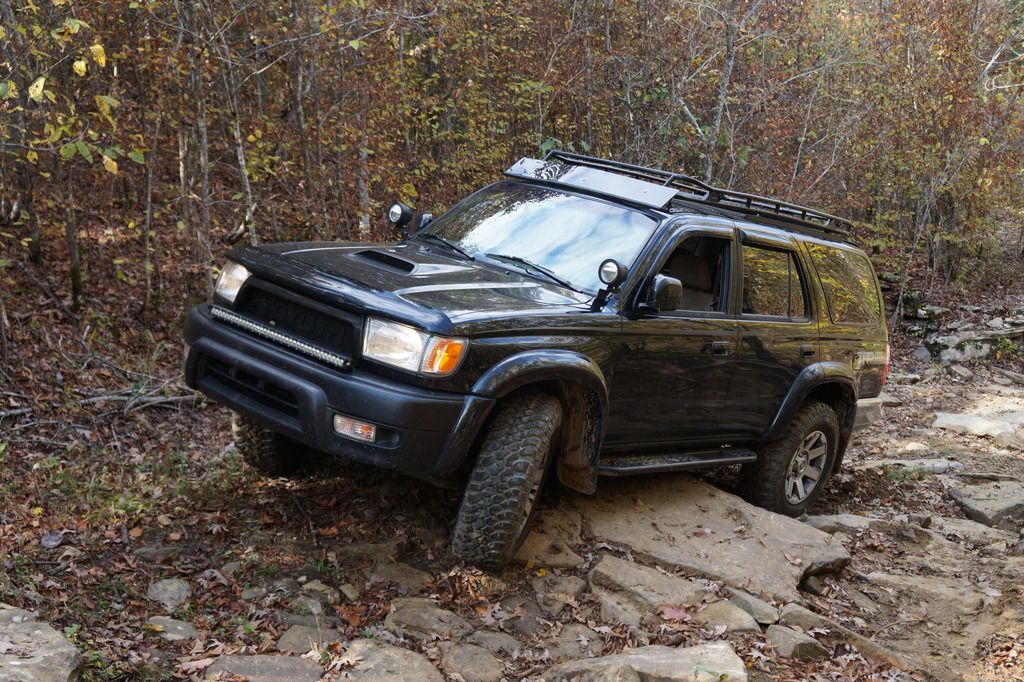

Then in October I went off-roading. Decided she needed more upgrades at this point.

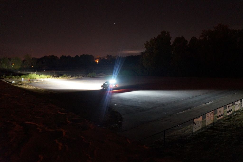

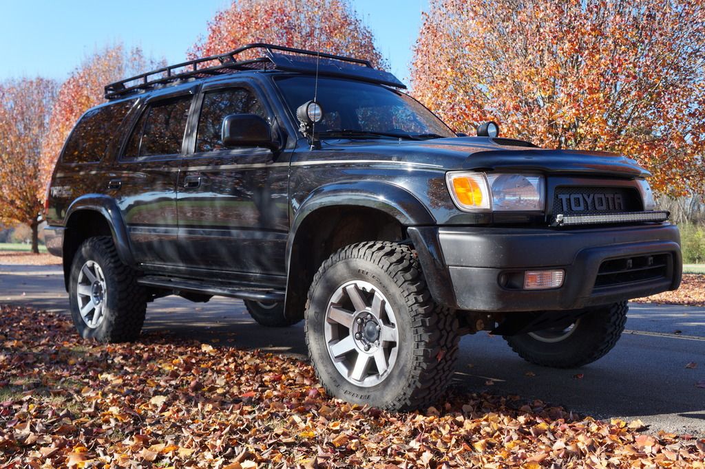

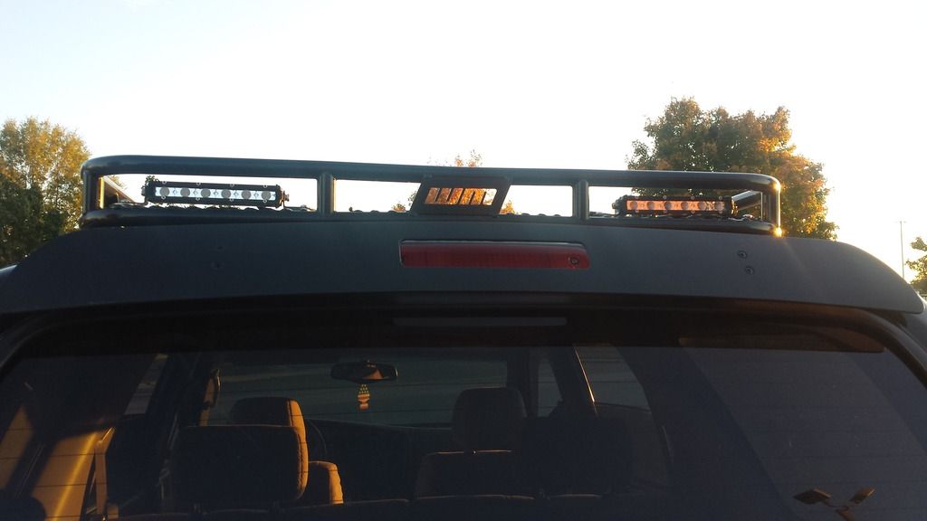

Then I added reverse lights to my rack.

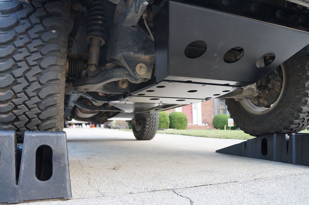

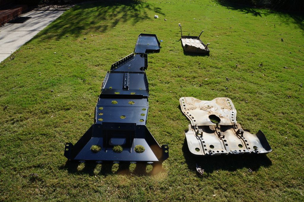

Then I added some real protection for the underside in the form of 3/16" steel skid plates.

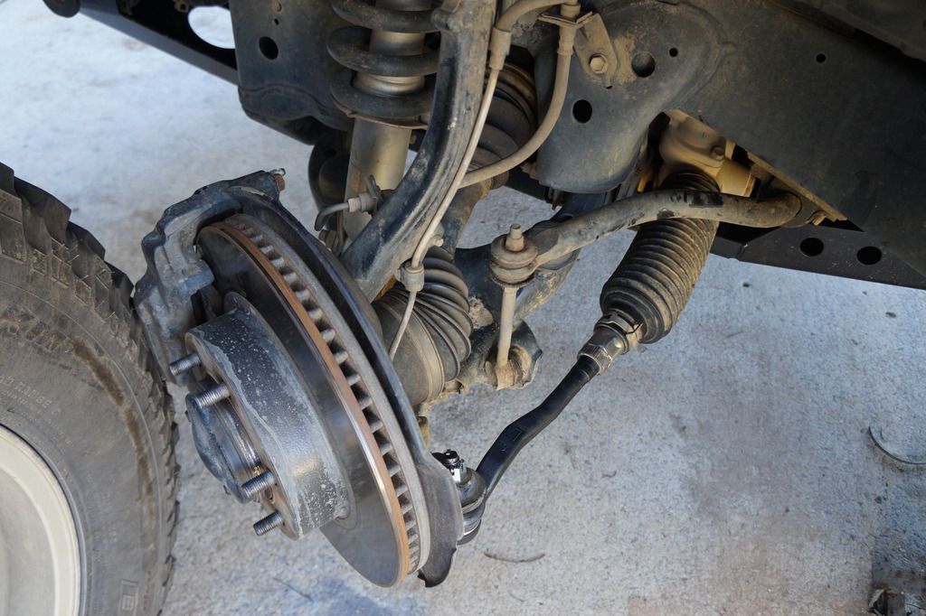

Put new inner and outer tie rods on.

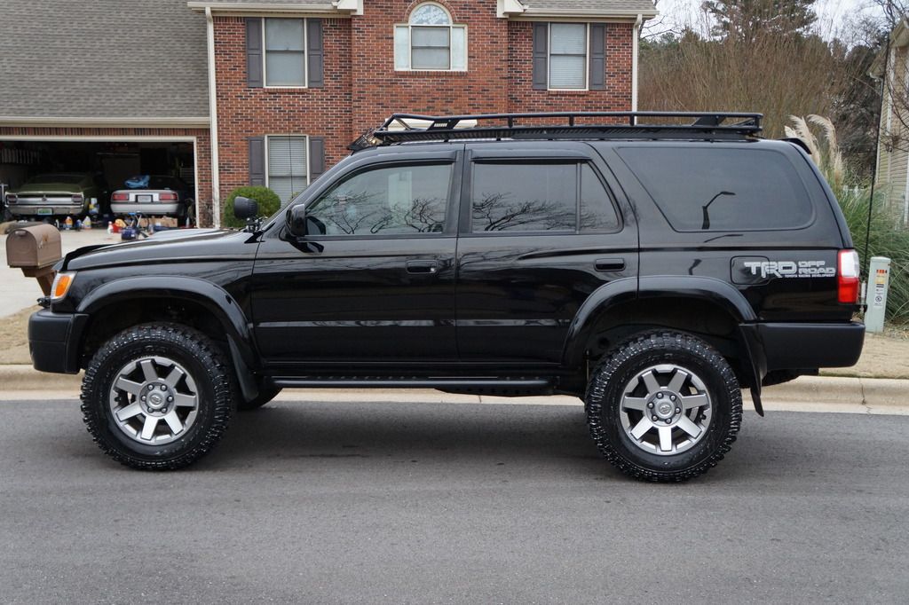

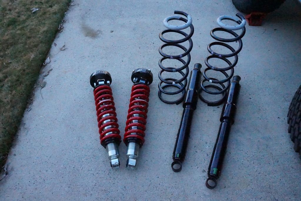

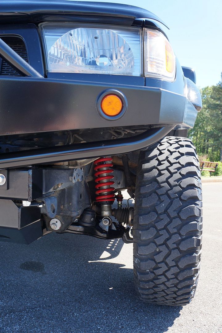

Then she got lifted, coilovers up front and long travel in the back.

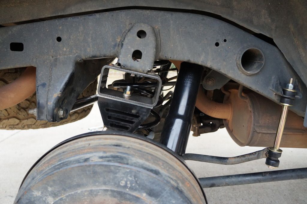

Fabbed up some extended bump stops and sway bar links for the rear.

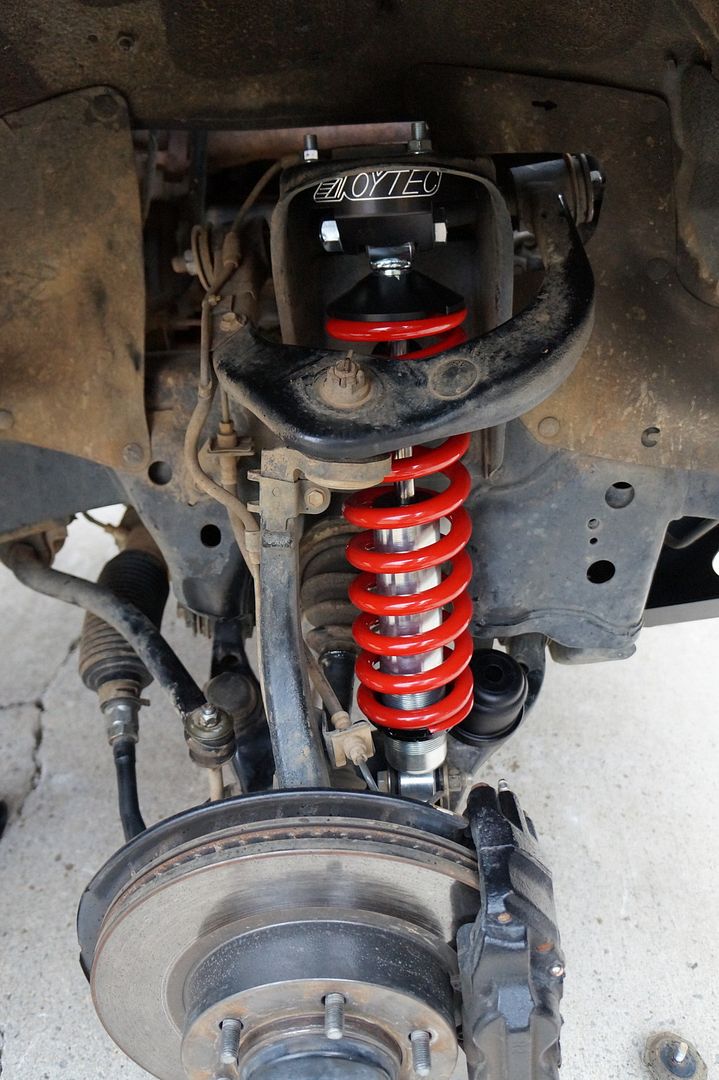

All the front suspension goodness. Coilovers, BBK, soft bump stops, new OEM Lower Ball Joint and Tie Rods

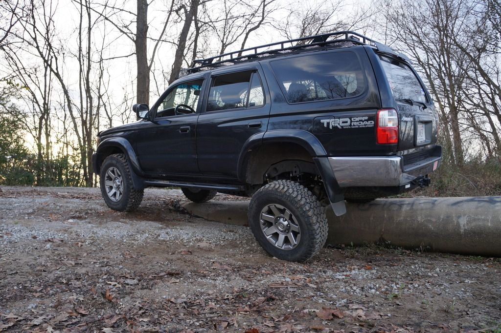

Really flexy in the rear suspension now with the long travel

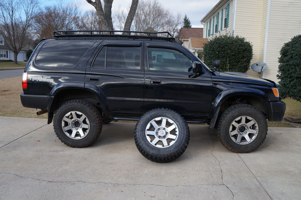

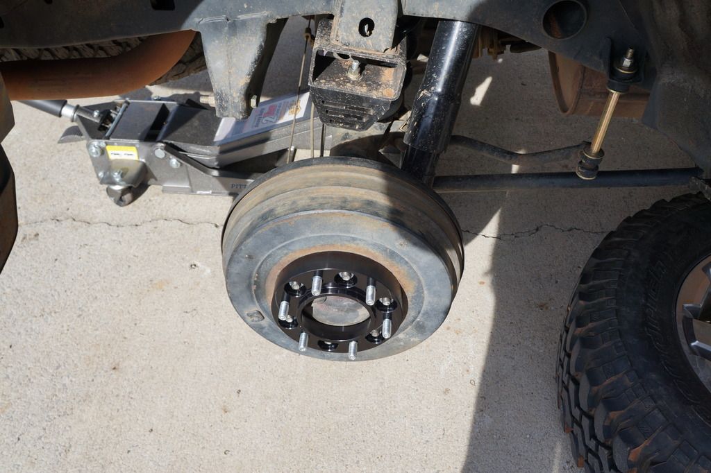

Installed 1.25" spacers to get a little more stability with the lift.

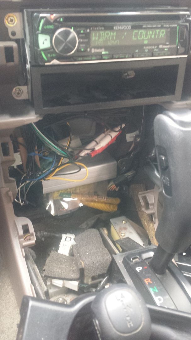

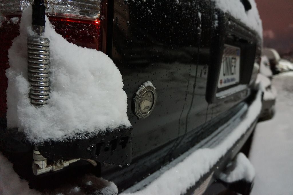

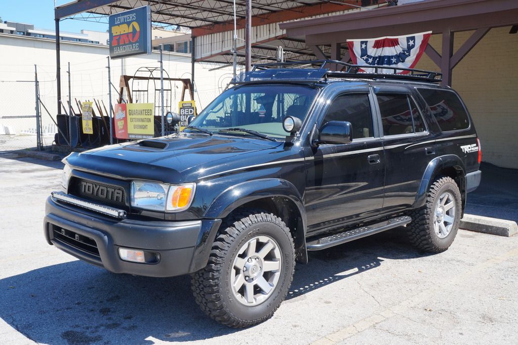

Gave her a bath, polished and waxed, debadged the rear, put my own "custom" badging on, installed a CB radio.

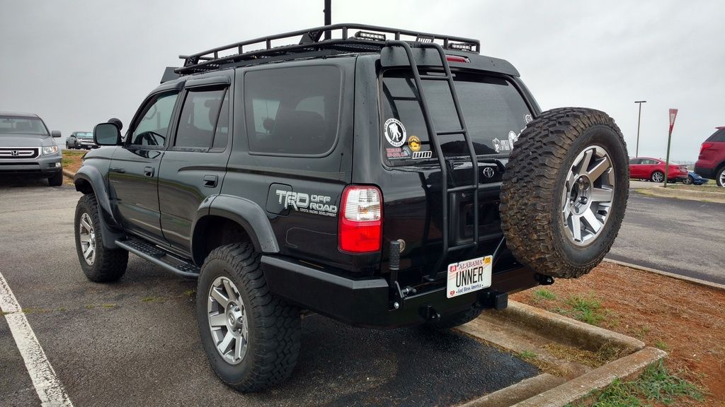

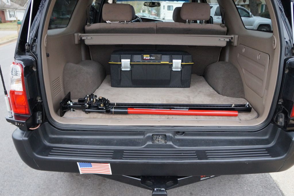

Mounted a Hi-Lift in the back.

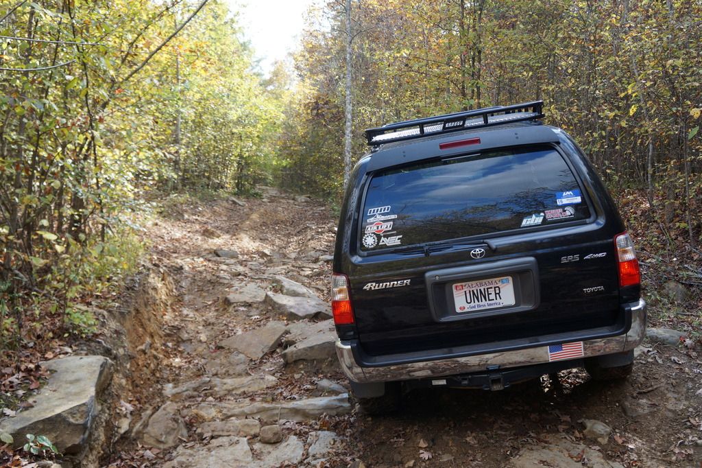

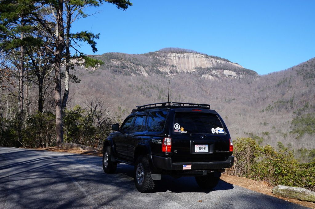

Took her up into the mountains last weekend.

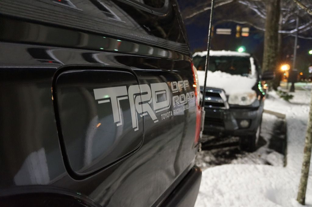

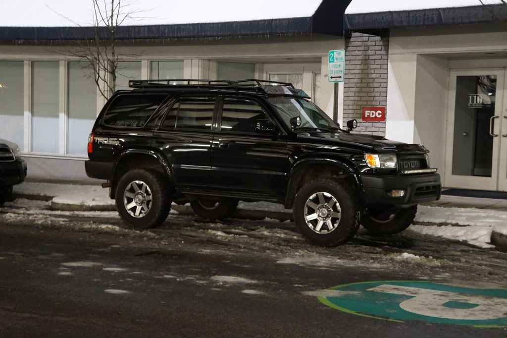

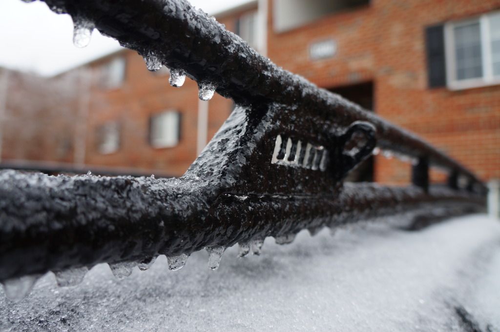

And today I'm stuck in the house due to an ice storm so I took a couple pics earlier today.

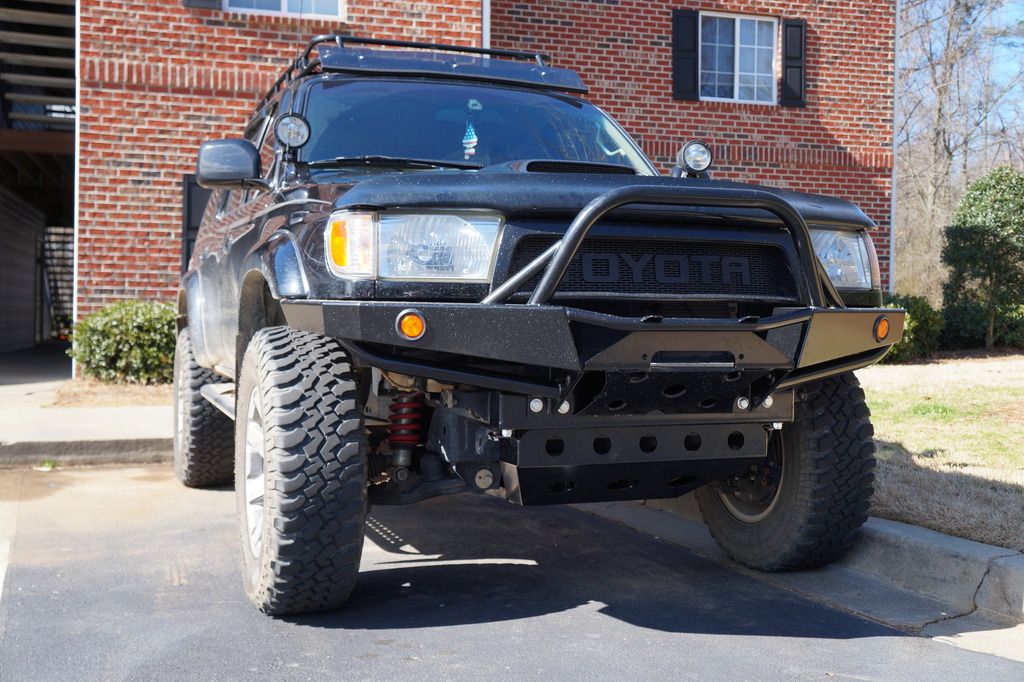

I know that's a lot but it pretty much sums up my last 6 months in terms of vehicles. I've got a front plate/winch bumper on order for the 4Runner, and I'm looking for a locker and TRD supercharger for it possibly. Plus some other stuff like a rear ladder for the roof rack and a rear bumper with a swingout tire carrier. She's at 183k miles and runs like new. I love Toyotas.

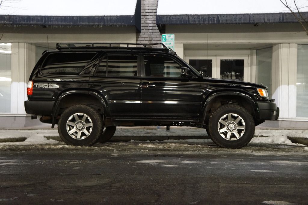

Thanks man! Pics of said Land Cruiser? I'm a lover of all Toyota trucks. My 4Runner's got a little Land Cruiser in her too, the rear lift is all OEM Toyota Land Cruiser Parts. The front coils off an FJ80 actually fit perfectly in the rear spring seats and the rear shocks off a Land Cruiser bolt right in too, providing longer travel and a bigger shock body than stock.
Can't wait to get my front bumper in. Hopefully sometime in the next month or so.

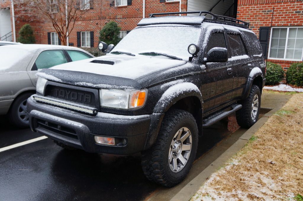

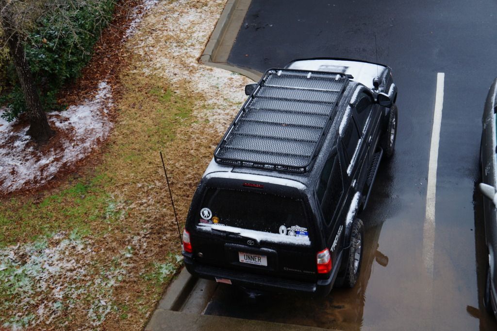

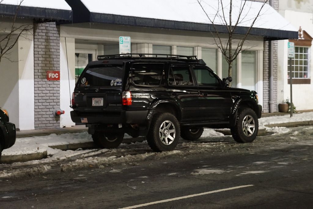

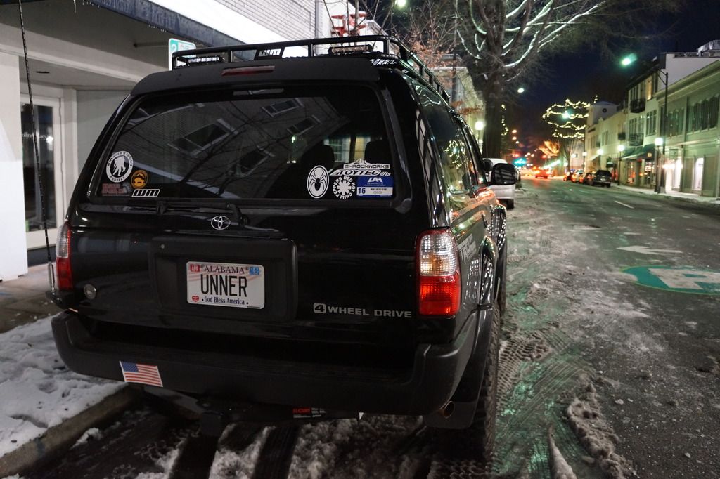

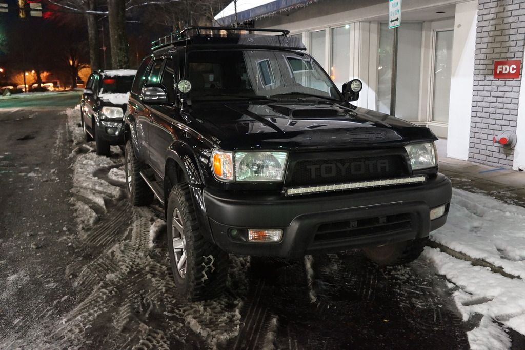

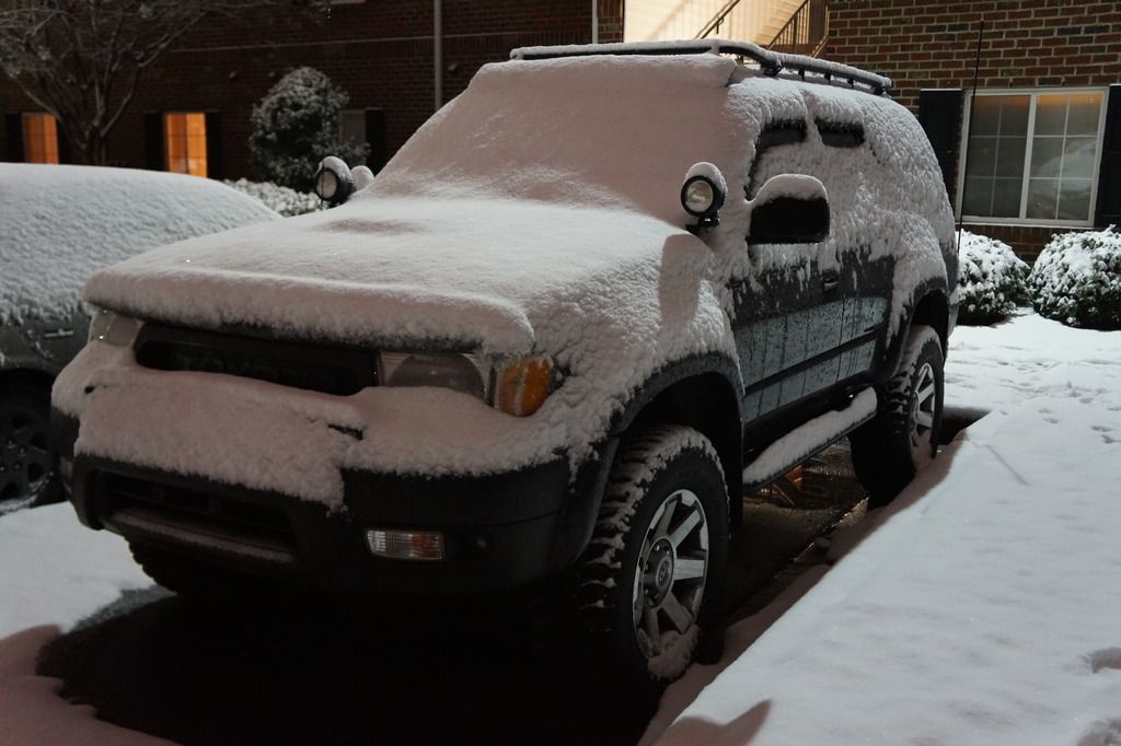

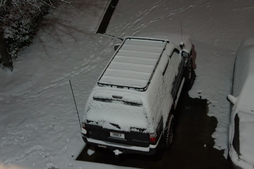

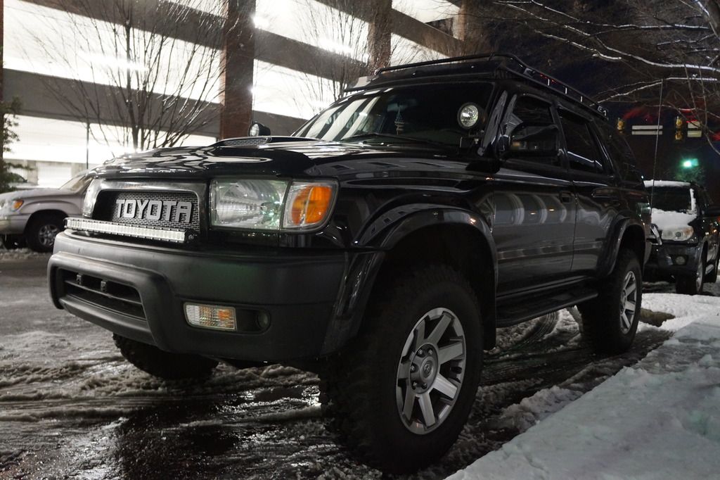

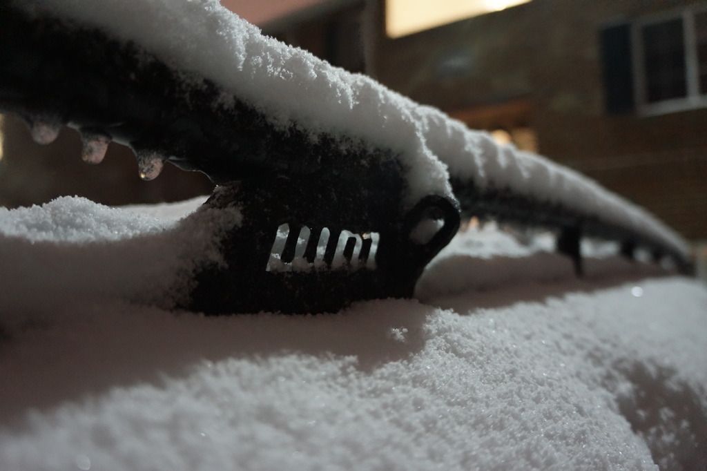

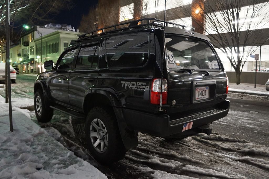

Here's a couple more pics I took today in the snow. This camera takes pretty good night pics, didn't use a tripod for any of them. I'm impressed. The last ones really show off the shape of the rack too. I kinda have a problem with taking pictures of my truck...
Came outside this morning to find this. My truck was the only one in the parking lot that had this. It doesn't bother me because they didn't hurt anything, but I still prefer a look but don't touch policy if I'm not around and I don't know you.

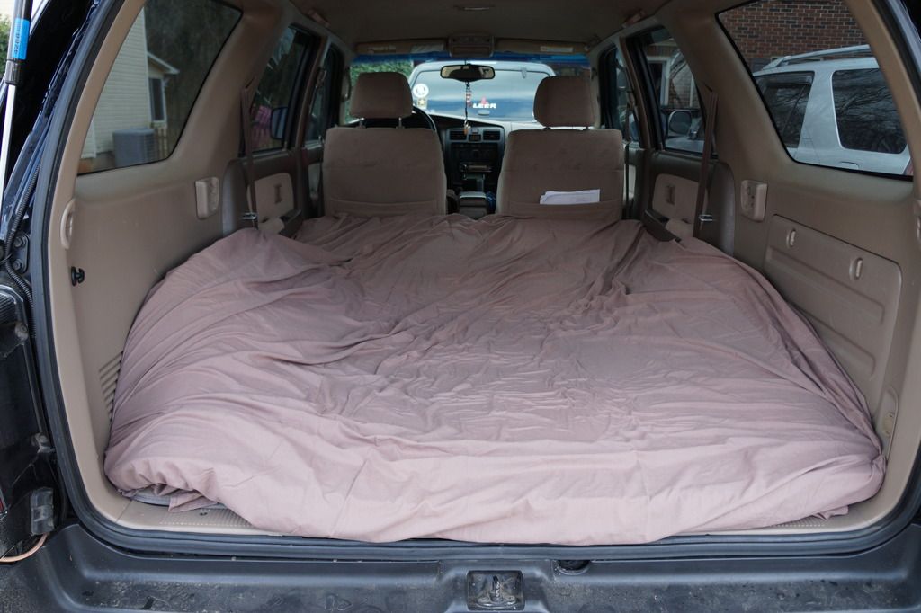

Turned it into a camper.

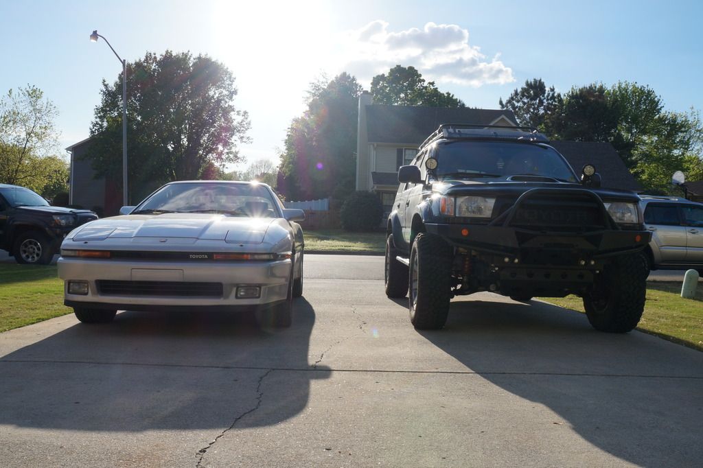

Here's a few pics from the other day when I had her out. She's so planted and quick compared to the 4Runner, I forgot how fun the car is to drive, even if it is only a N/A.
