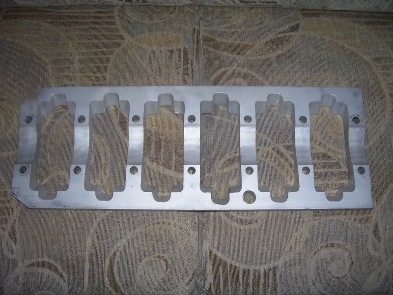

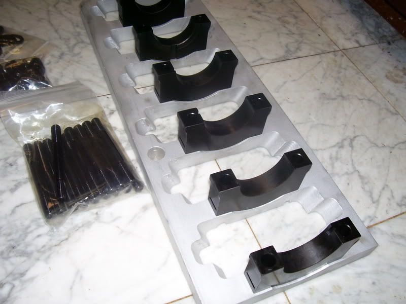

Hey Steve, thanks for the link in my email. Looks real good so far.

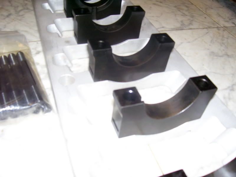

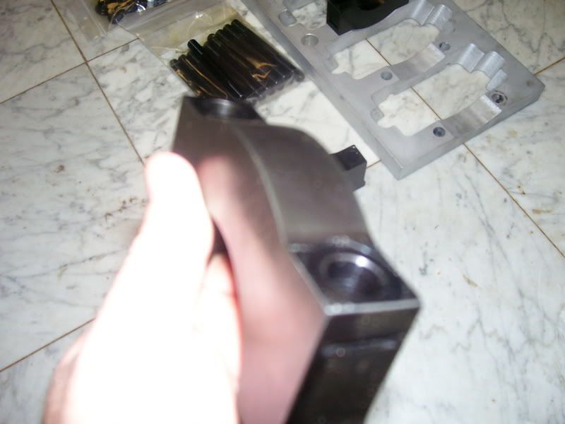

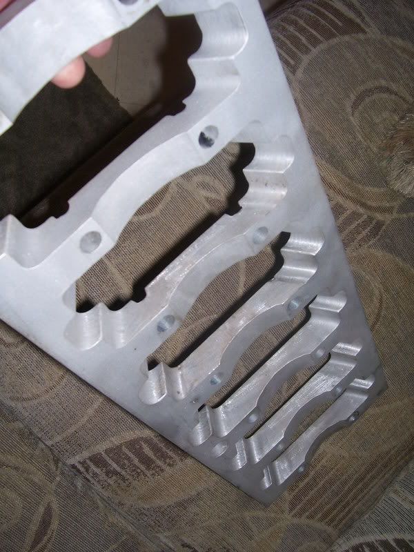

I have made girdles before for the billet mains, here are pics of the one I made for the malta dragster
mk3_7m
Jul 21, 2007
536
melbourne
^^ i didn't know you had these...... Unless these were custom made then ok.
Anyway goodluck with the build :D. Make us 7m fans proud ^_^
Sweet I'll have to talk to you about making one with the TMS Billet mains.

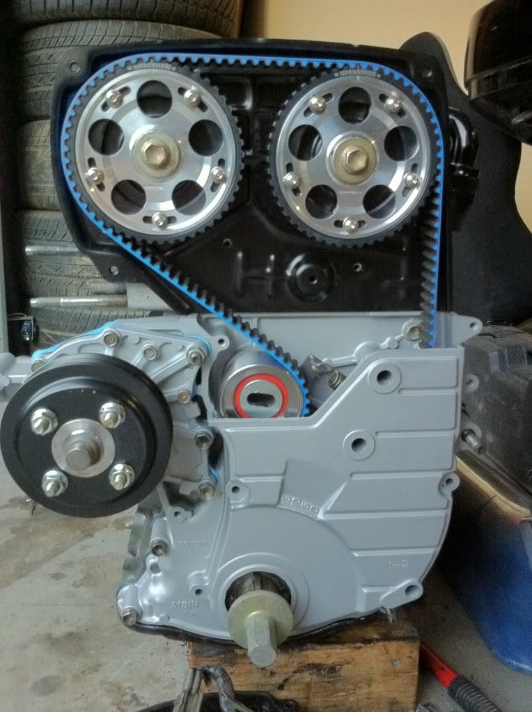

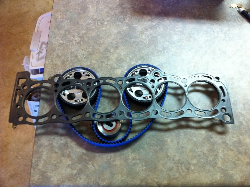

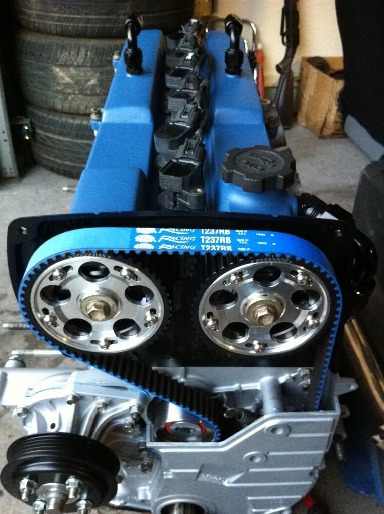

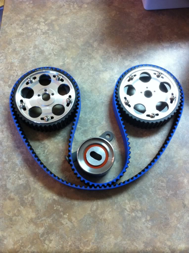

New parts came in today.
SIP Solid Timing Tensioner
SIP 1.3mm MLS HG
Gates Blue Racing Belt
TMS Adjustable Cam Gears
The solid tensioner looks a million times better then the stock one, any 7m I build will definitely have this on it.
