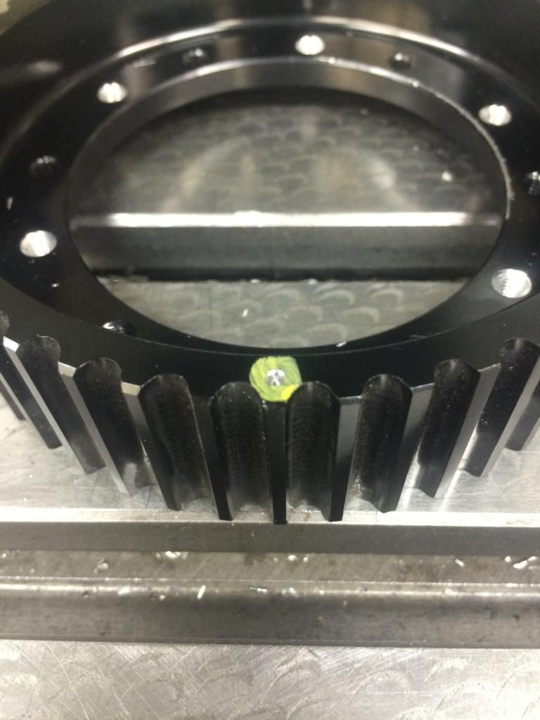

Nice work! Ive wanted to make a water outlet for a while now but havent been bothered yet. Looks like you are running EWP or a dry block? (No thermostat or bypass etc)

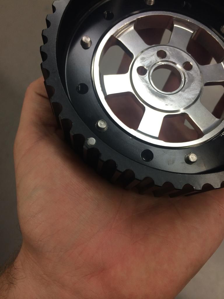

Arent those cam gears alloy? How are you going to trigger the pickup?
The cam gears are aluminum. I'll add in a .080-.100 diameter ferrous slug For the pickup

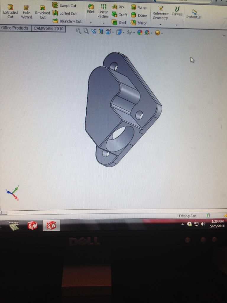

Are you going to sweep the turn on the water outlet? I'd probably put in a slight ramp so there isn't much turbulence in the water outlet. If your solidworks has a flow motion simulation, you could see how much it'll cause.

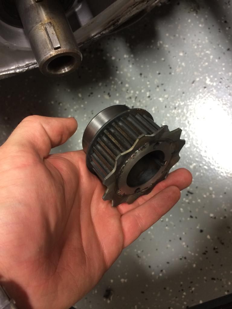

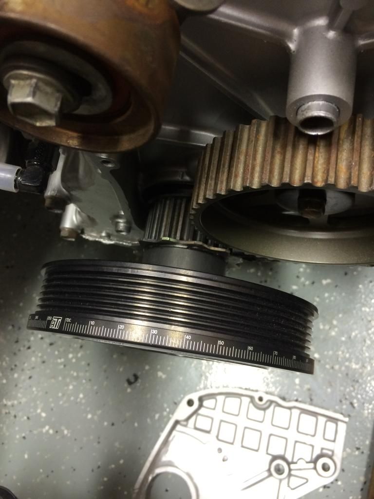

Crank sensor setup. Steven used a JZ trigger wheel, and machined the back side of his 7m wheel and tack welded it on. Then added a hall sensor and bung to the lower timing cover. Works out awesome and is out of view.

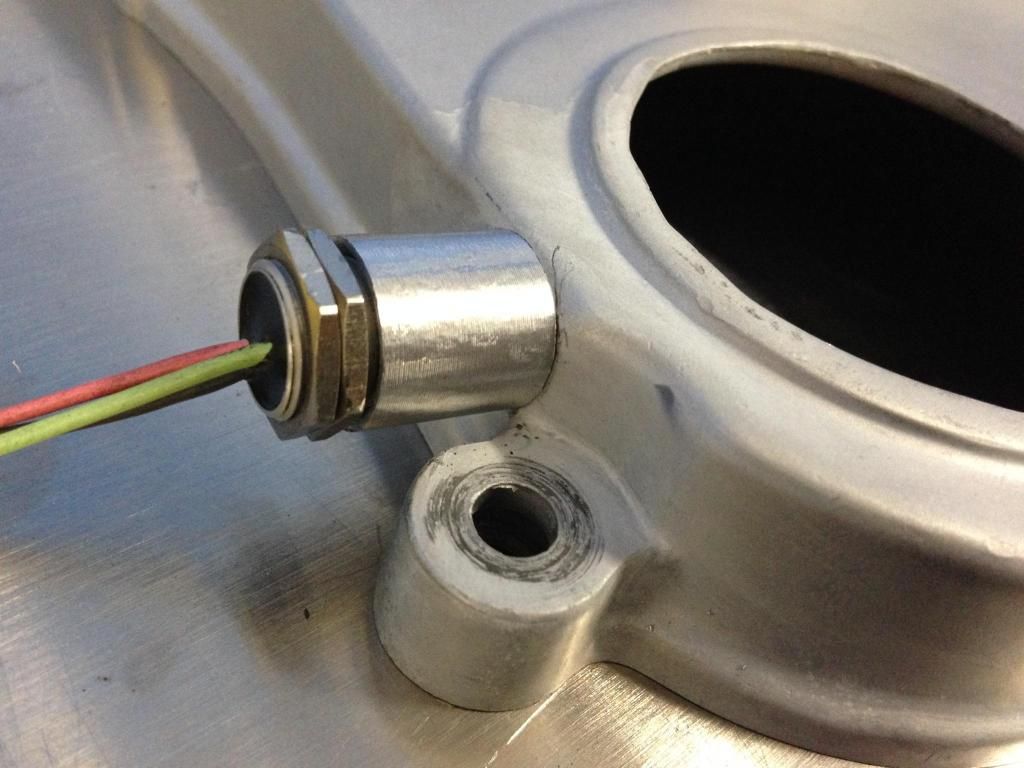

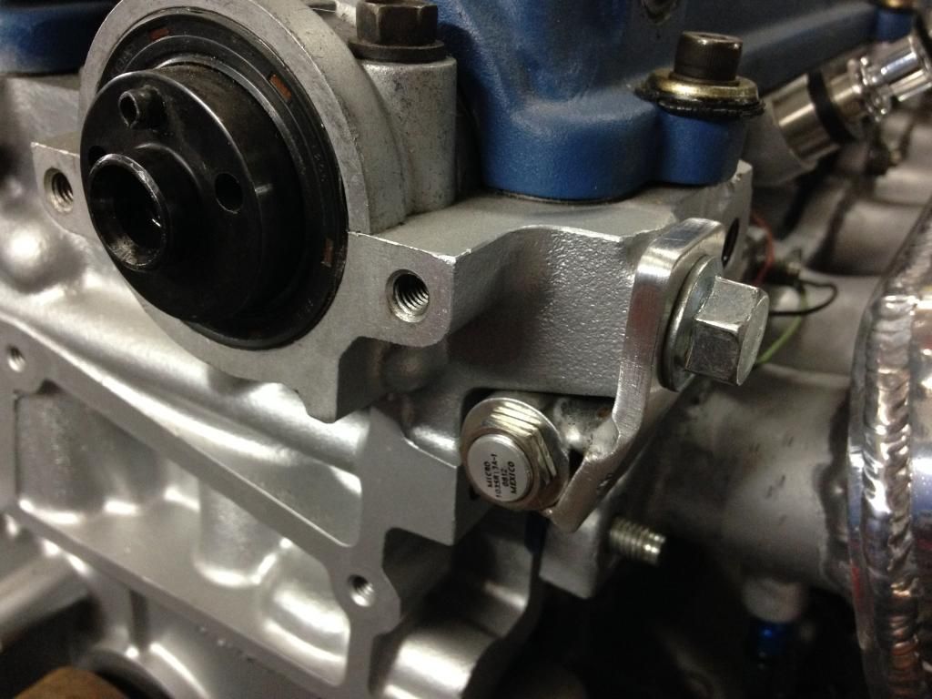

Then he worked on the cam sensor setup. Which consist of a bung behind the cam pulley that's bolted to the head. Again, out of sight. I milled his cam pulley and tapped in a .125 slug for the pickup reference.

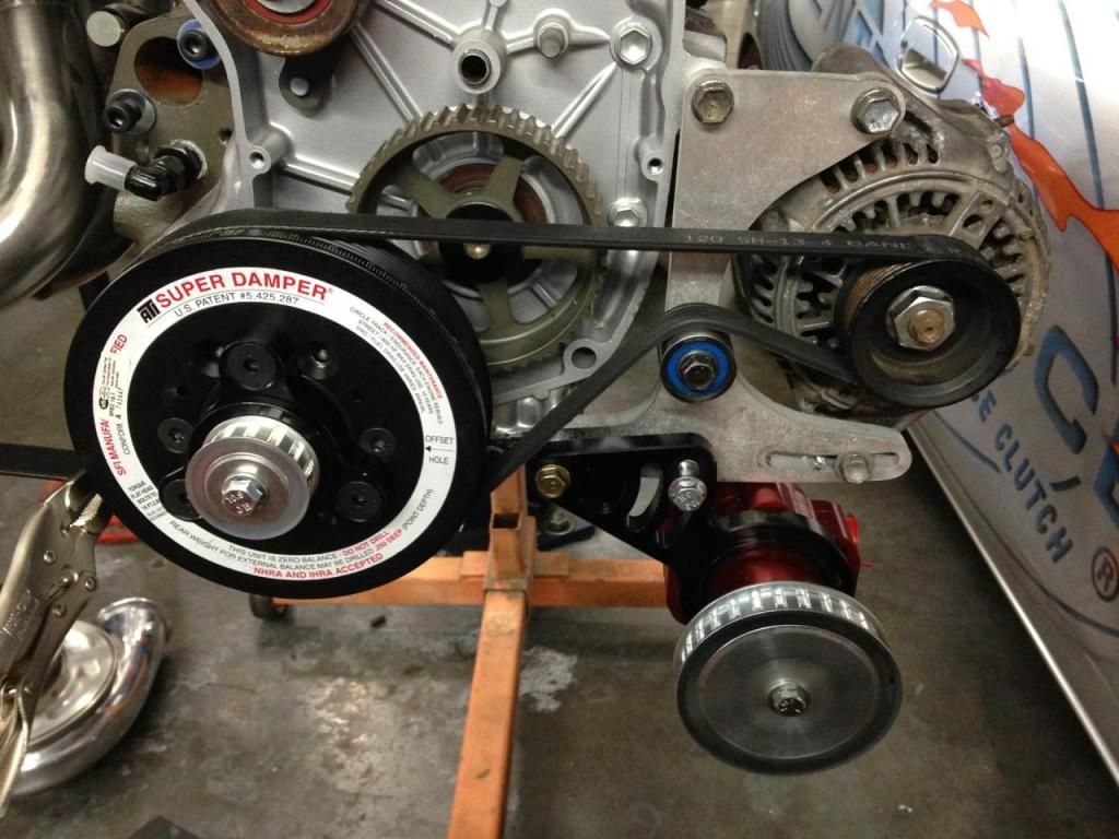

Then Steven modified an alternator bracket that Dustin made to accept his mechanical fuel pump.
