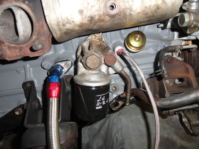

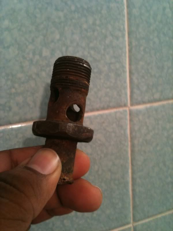

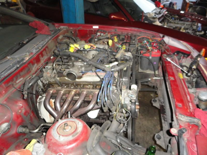

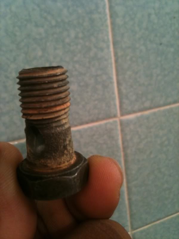

Anyone know the thread size for these fittings?
Fitting for back of head to heater valve
turbo water line
turbo water line
just wondering if someone already knew before I go measure them out. I'd like to make these an fittings

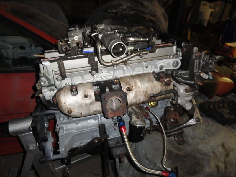

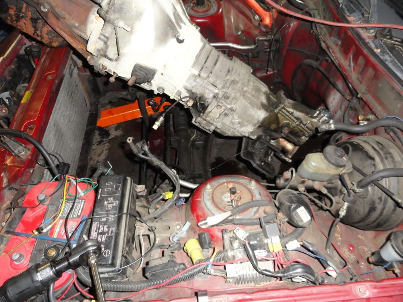

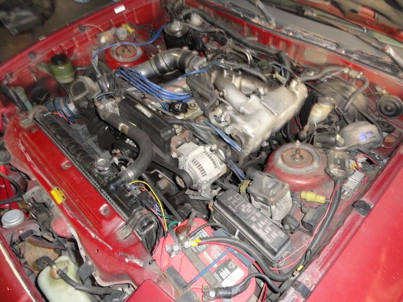

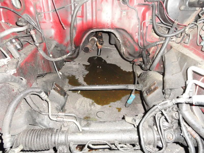

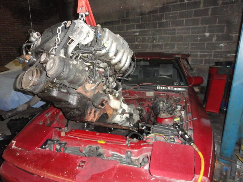

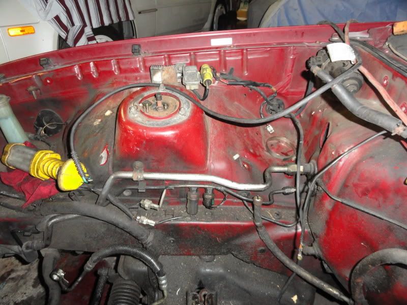

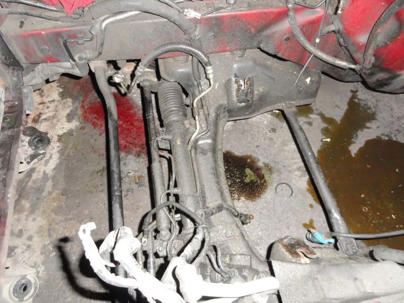

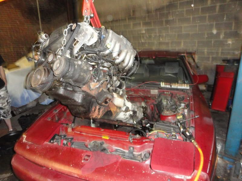

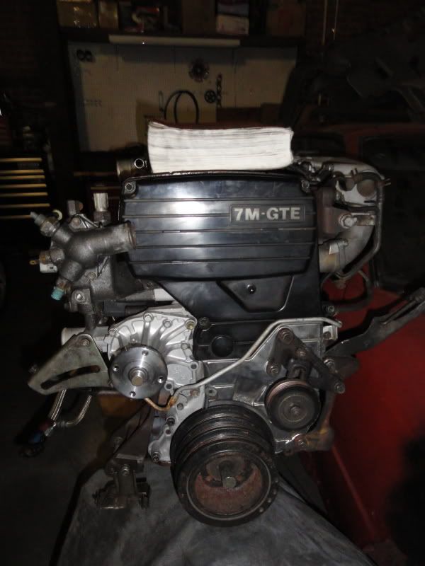

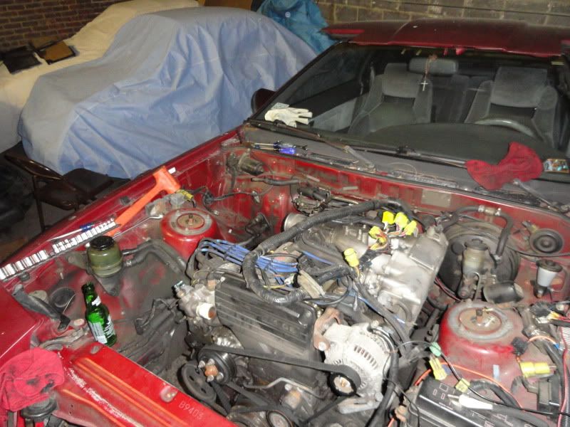

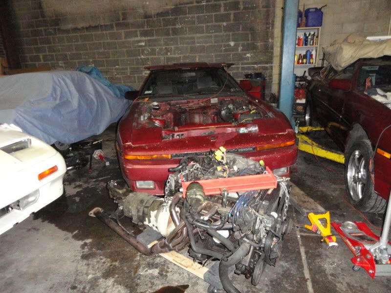

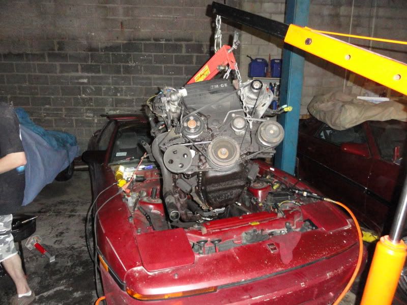

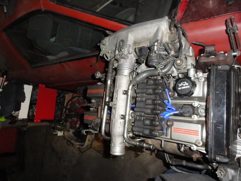

The motor is pretty much ready to go in. Just need some parts off the current motor (ps pump, egr cooler and other knick knacks) So I pulled the motor yesterday after work. Pics.
I hate gear oil!!!

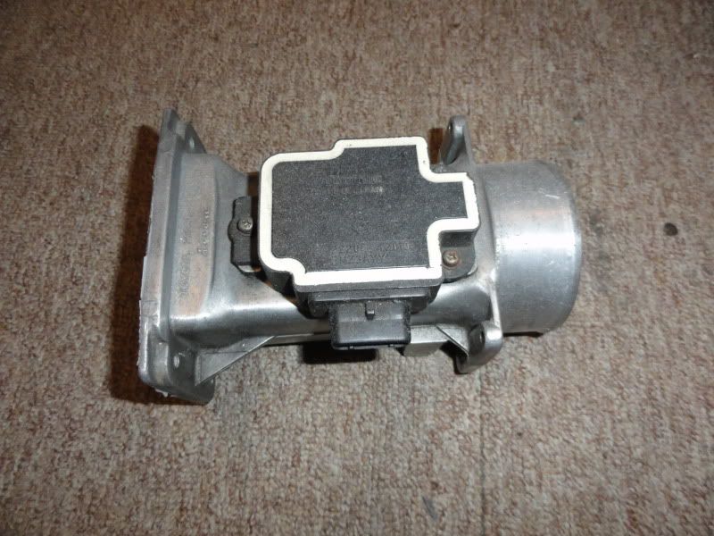

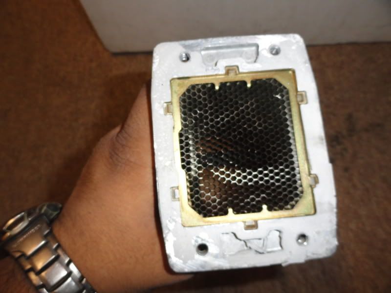

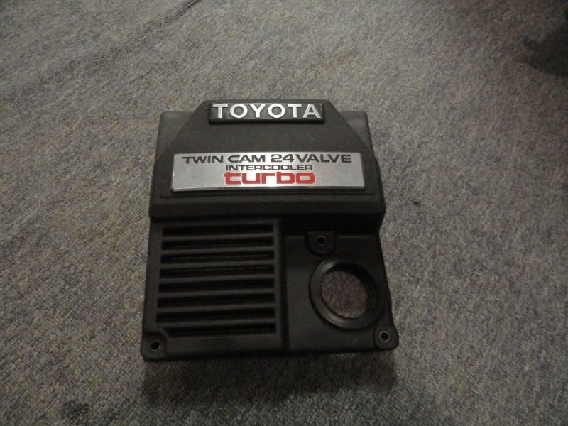

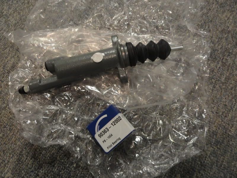

Some more parts came in. FMIC, Gates Coolant hoses, Slave Cylinder, Pilot bearing, AFM, coilpack cover.
I also have a lexus AFM lying around somewhere but I thought I'd break the motor in with the stock toyota afm.

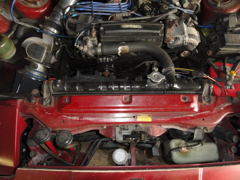

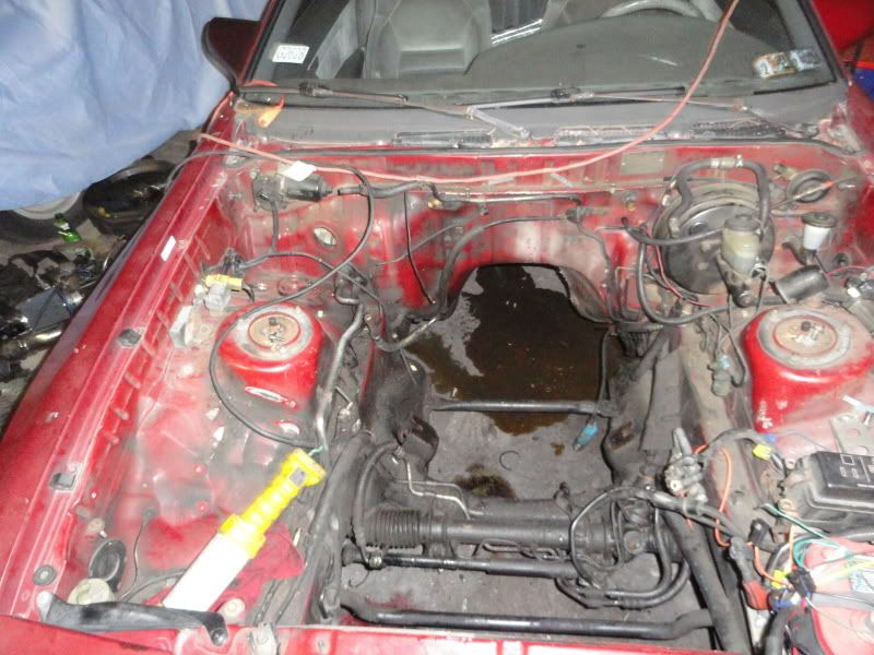

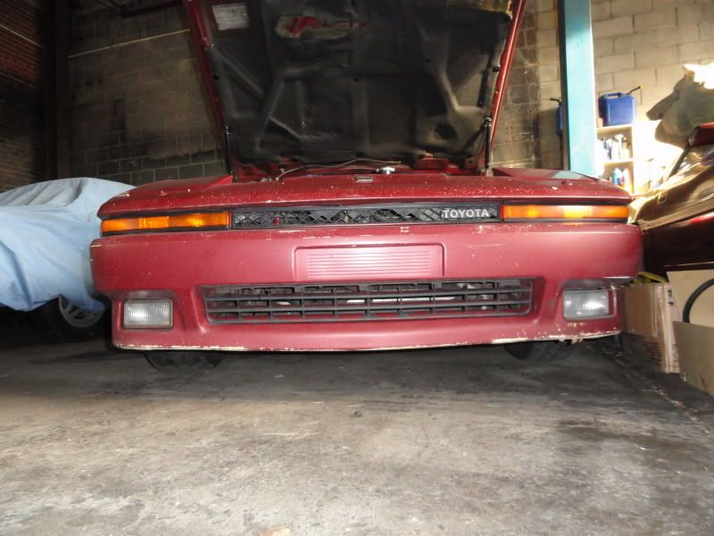

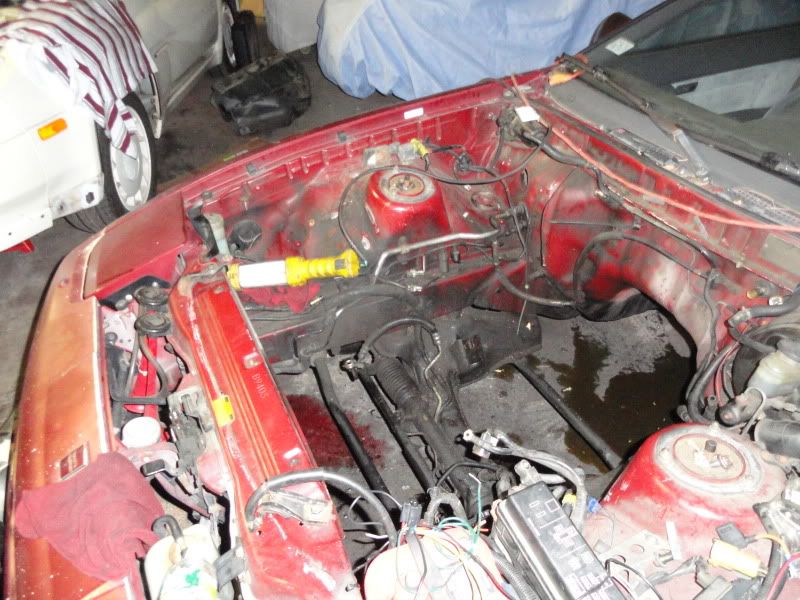

I think I'm going to try and pressure wash it. I don't have enough time to go around and purple power it with a tooth brush this time around. We'll see. I'll post pics of before and after of the bay. Gonna be a big job!!
supra1008
May 2, 2007
1,179
Philadelphia

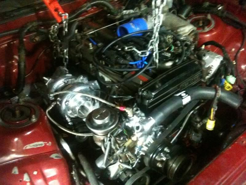

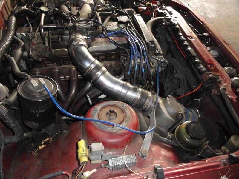

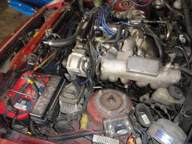

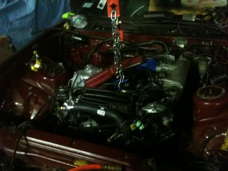

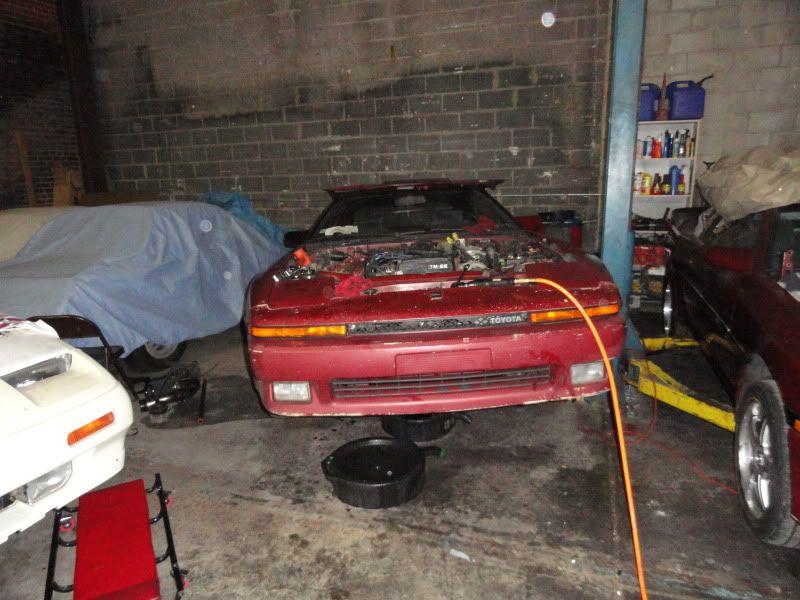

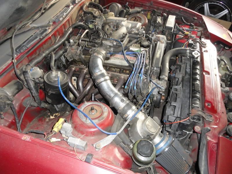

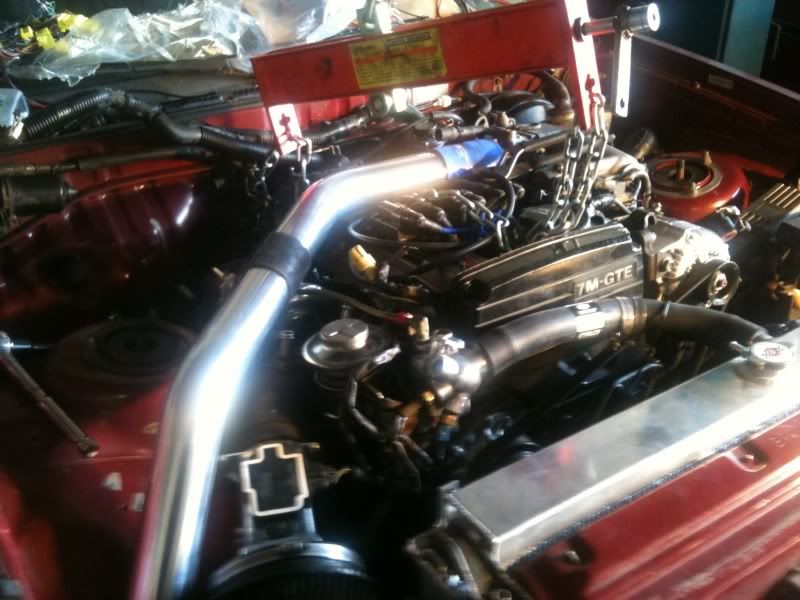

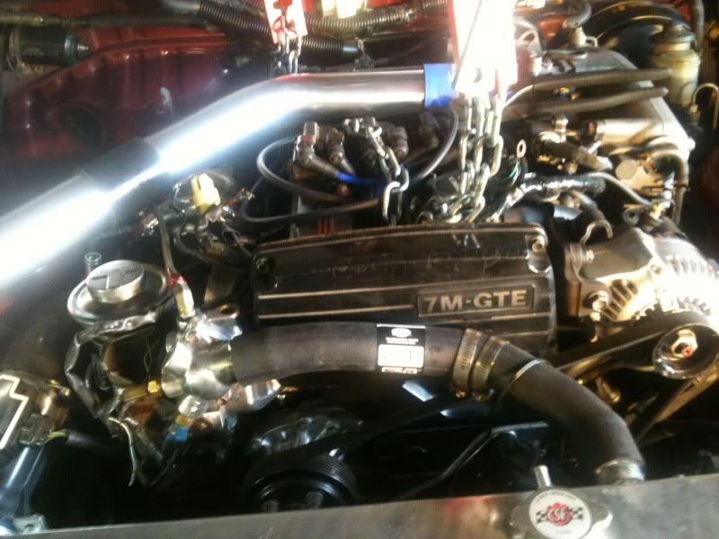

So I bought a decent pressure washer, soaked it in purple power and sprayed I down. So much quicker!!!! Next day I dropped the motor in. Started mocking up the ic piping.
Pics.
supra1008
May 2, 2007
1,179
Philadelphia

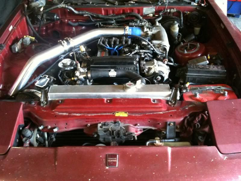

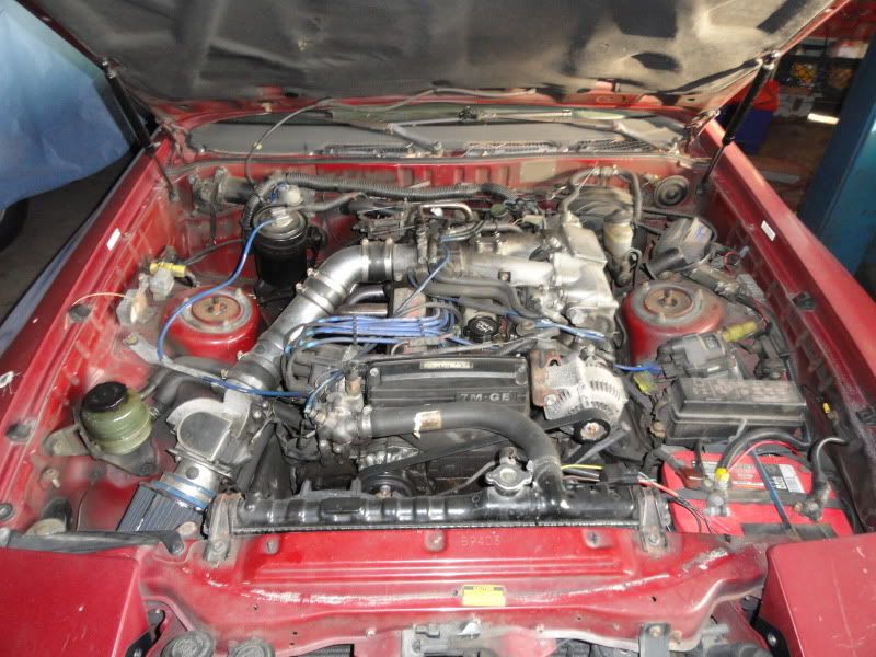

So haven't posted in a while. Finished the ic pipng and test pipe. Starts and runs. Have been breaking the motor in. Also took it to the dyno to break it in. Just some kinks here and there to iron out. Boosting good. Need to buy a boost gauge. Ordered a gauge pillar and bought an AEM wideband and an s3 short throw off emp. Thanks J! Just need to install it. It is throwing two codes. iirc they are 24 & 51 which i believe are afm and sensor. I'm guessing it's the cold start sensor since it goes straight to 800rpm on cold start. Once it warms up it's fine but has a weird idle. Might have a missfire. Gotta check. Also needs back left caliper. Other than that she's running nicely. Put almost 600miles on the motor now. I think I have some pics and a video of first start up.
