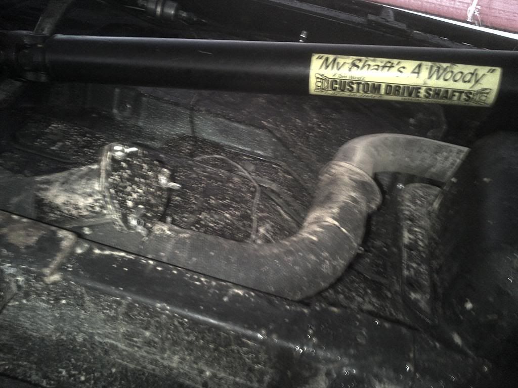

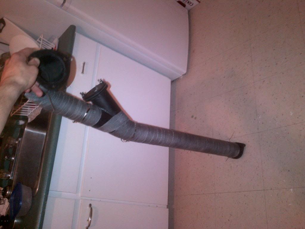

Here is the 3" exhaust with the Dump Tube.
Heat Wrapped

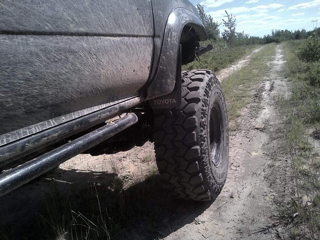

Removable Rear Mud Flaps
Minimal Front Mud Flaps

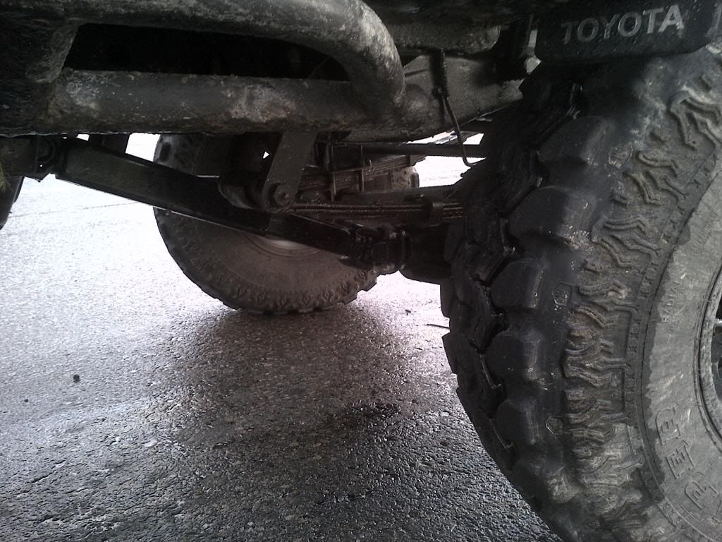

The Latest addition, the one I have really been waiting for, square front driveshaft.
