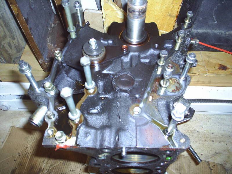

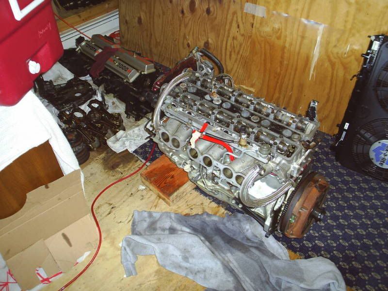

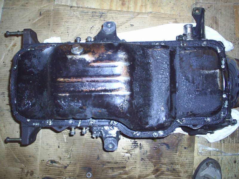

well first thing to be done.........tear apart the donor motor. A 7MGE. I will rob the head from it as well as the crank.
It was the original motor out of my car, its been sitting for about a year and a half, so its a little rusty.... also, i completely detest the stock headbolts being an allen wrench.
heres the progress so far

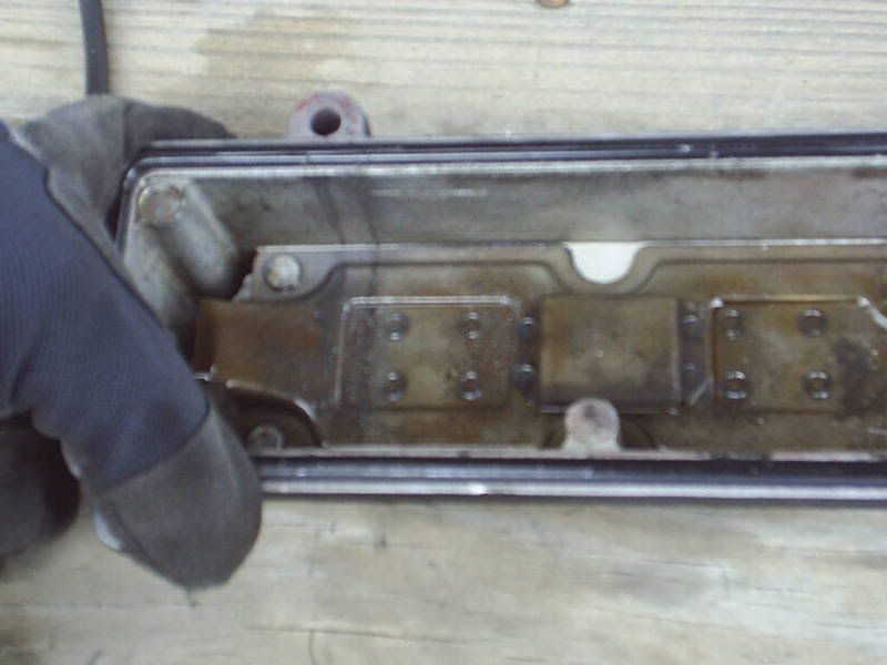

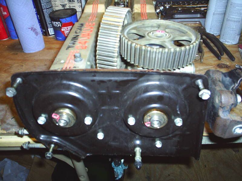

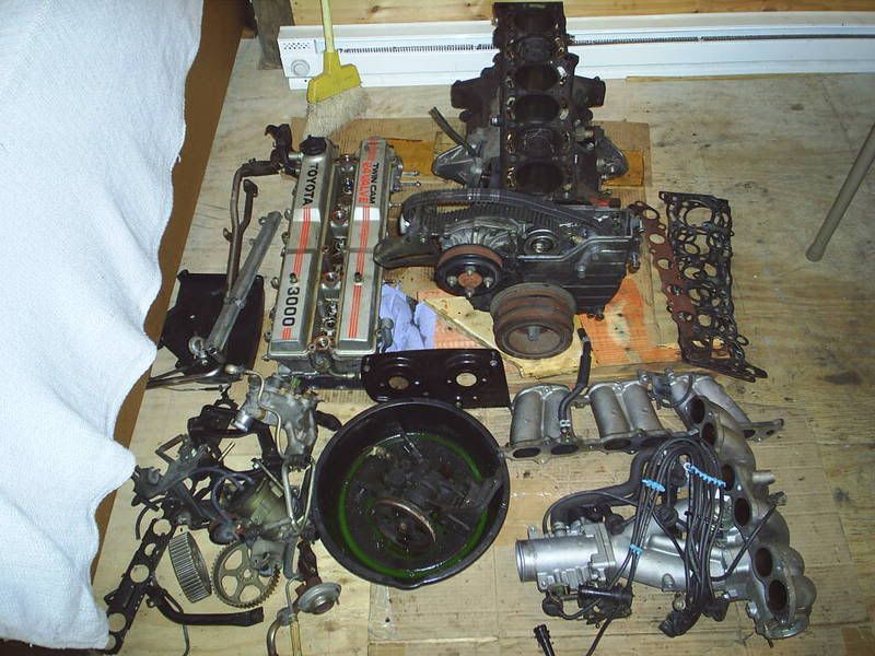

so anyways, more progress.
some more knuckle bustin( i got smart though and bought gloves, works like a charm)
the head before stripping
the cam gears on this head are practically new
head ready to get machined and cleaned. the works.

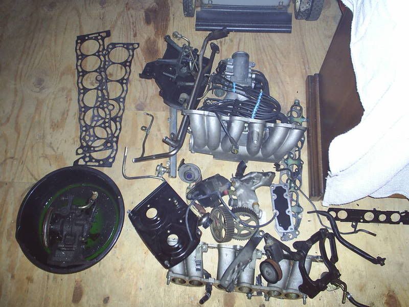

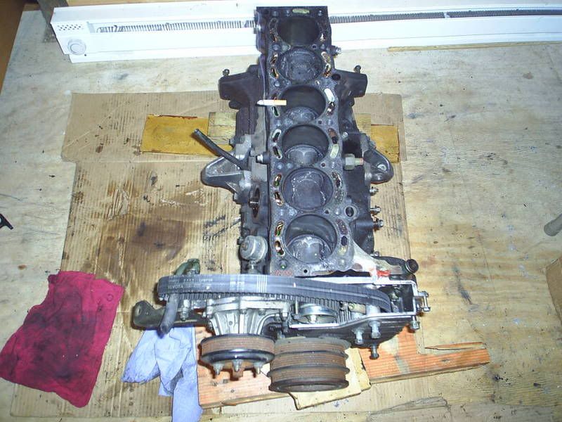

block about 80% external things removed
the arsenal of parts removed so far
and it continues...........
its a neverending wait for that almighty boost.

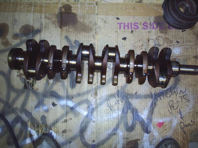

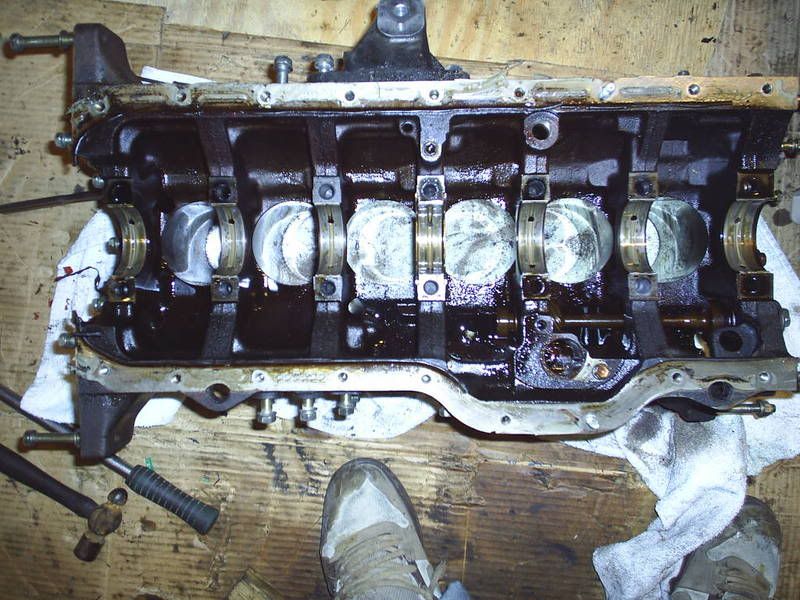

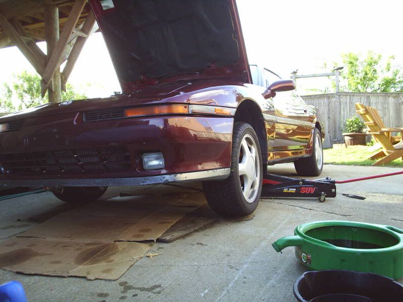

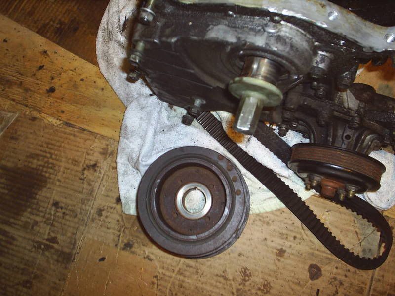

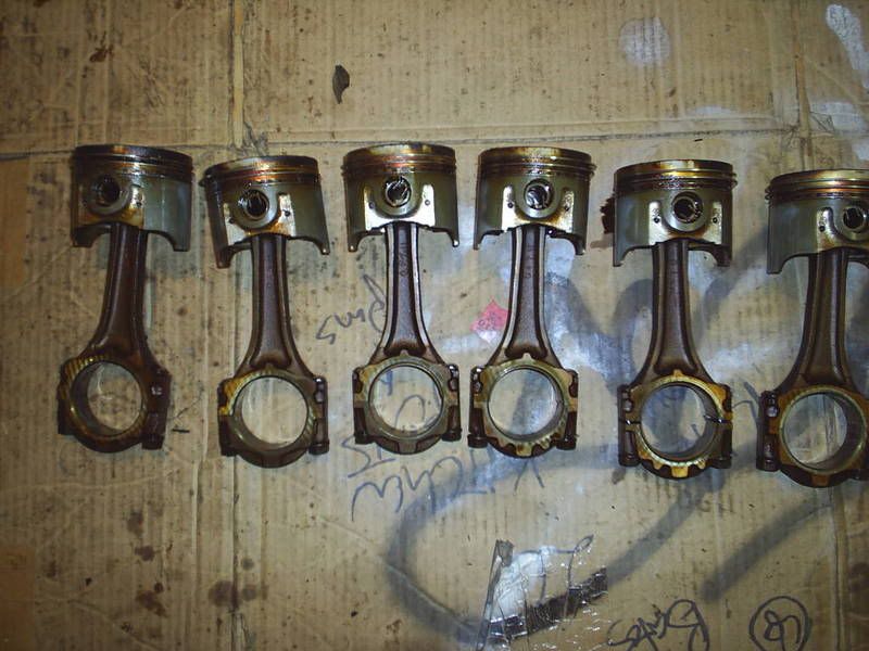

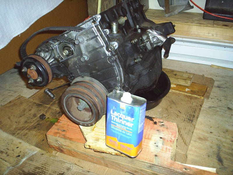

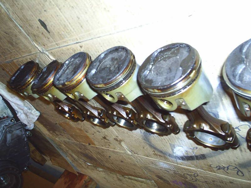

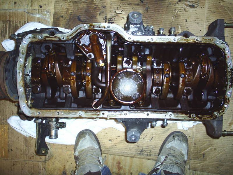

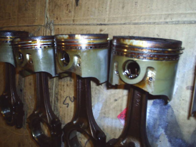

So yes, the crank pulley bolt was a bitch. and after that, the pulley didn't want to come off. but i got it in the end.
busted 3 ratchets, and a 1/2 to 3/4 adaptor.

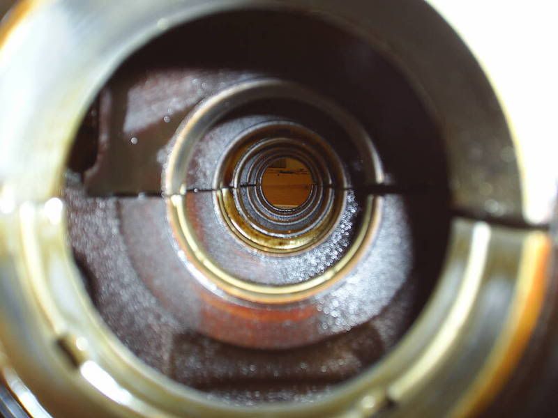

drained the block
and finally after i went and bought a breaker bar........

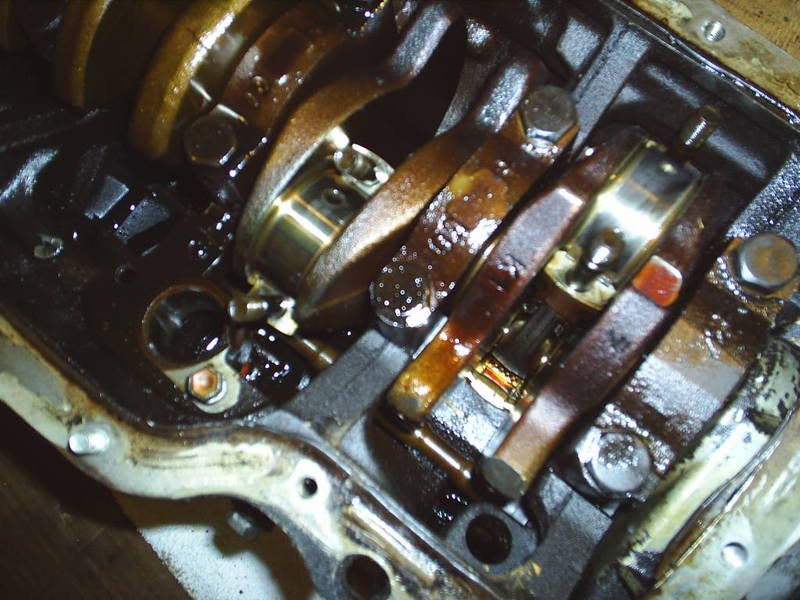

starting on the removal of the pistons

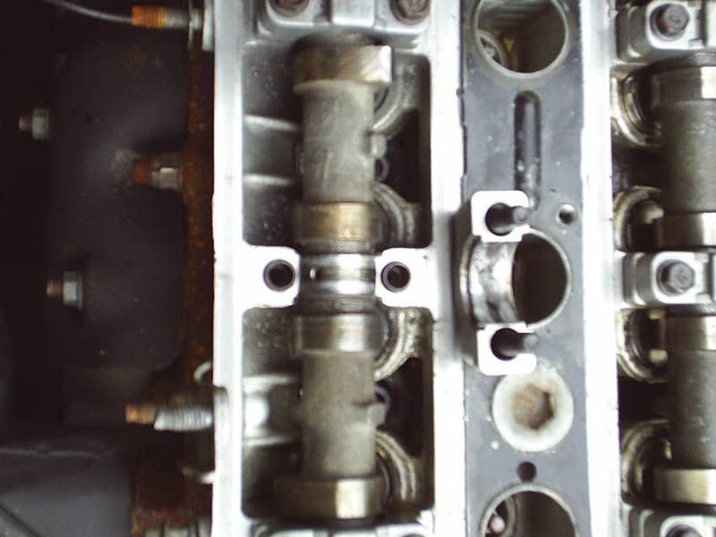

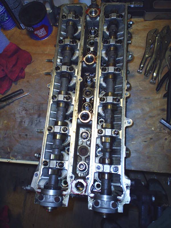

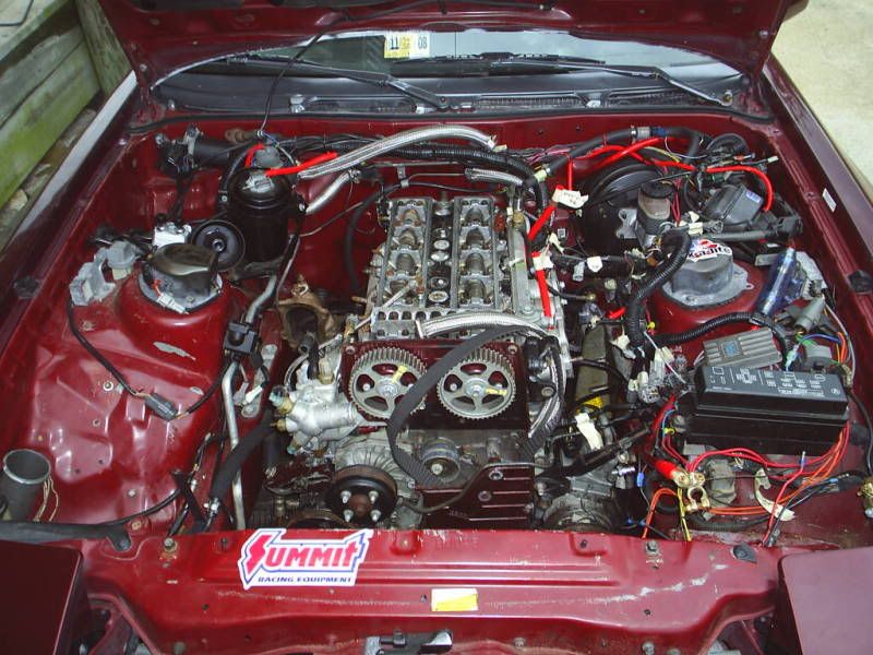

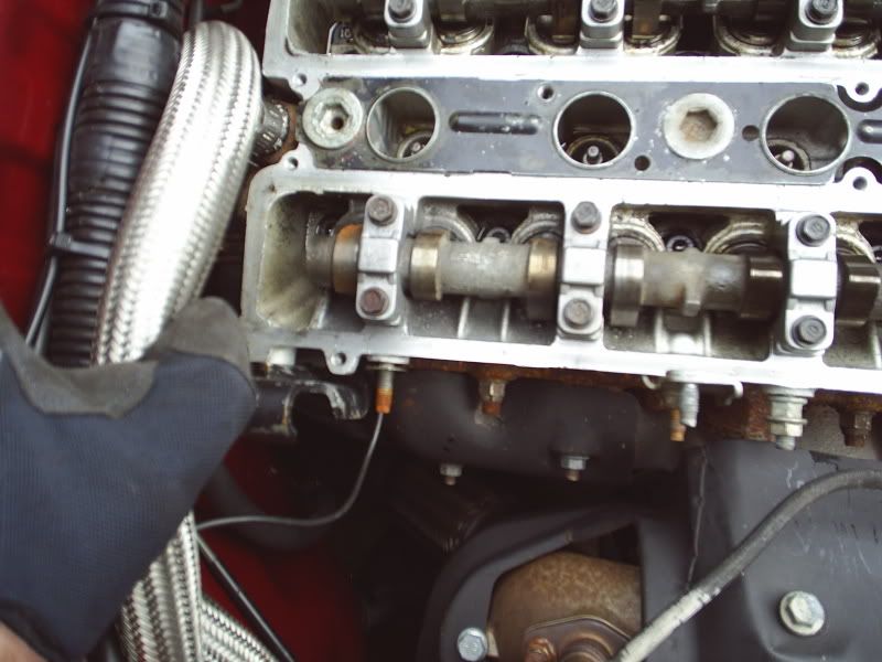

Sup guys. Sorry i haven't been around lately. Been kinda busy and whatnot. Also been procrastinating on the car too much. so today, i went down and finally opened the hood. And started picking through the mess and got down to the head.

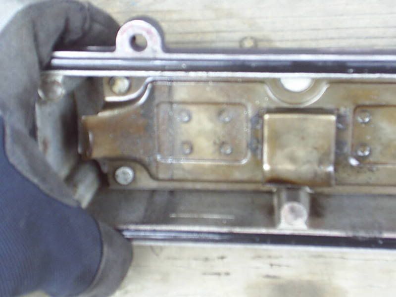

The back two exhaust cam journals were Fried. Period. The camshaft basically melted through the aluminum, digging itself into the head. There was alot of metal shavings for only being driven about 20 miles.
the cam journal sitting on top of the head is all warped and the aluminum has been shredded.

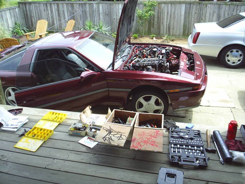

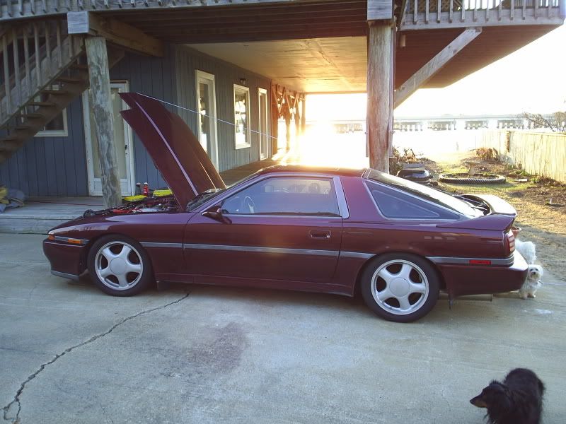

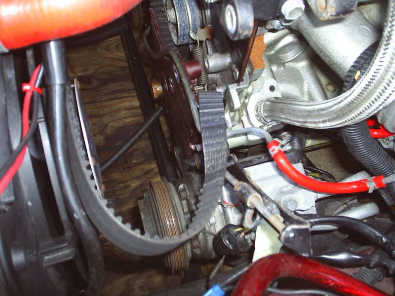

So, i got some more ambition and on a Beautiful Day, started on the car again.
When the camshaft seized, it ripped the teeth off of the brand spankin new timing belt.
Workin outside with all my dogs, the sunset was beautiful
i will do more in the next couple days

If you remove the passenger side windshield wiper(it's just one nut), you can tilt the hood all the way back to the windshield.
Supradude7mgte
Throttle happy teenager..
Oct 14, 2008
191
Norfolk VA
i know, its very simple. but there was a slight breeze now and then, so i just tied it up. i don't want it to crack the windshield or slam down on me.

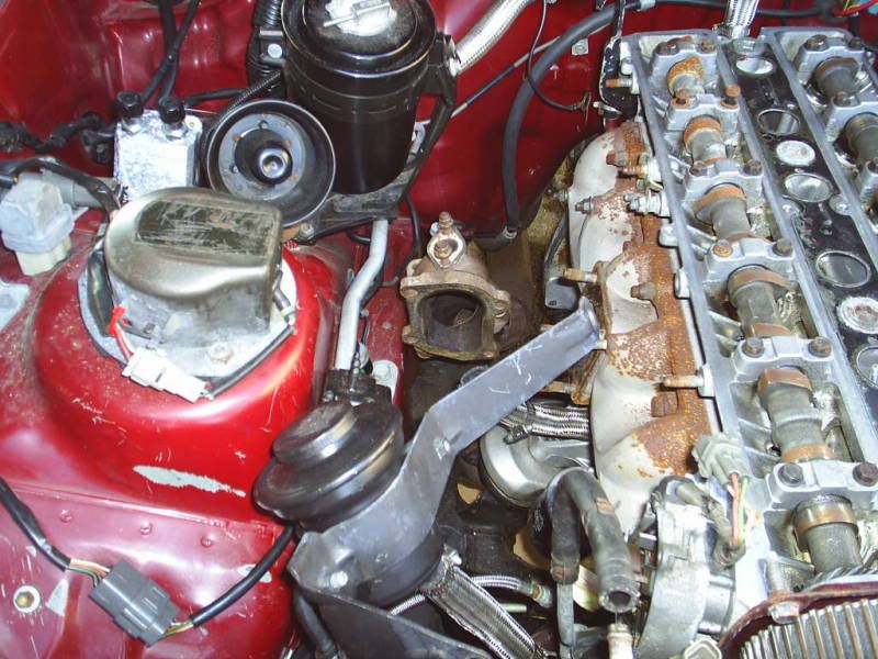

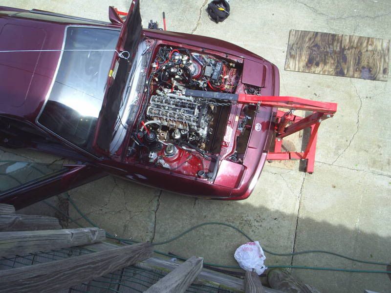

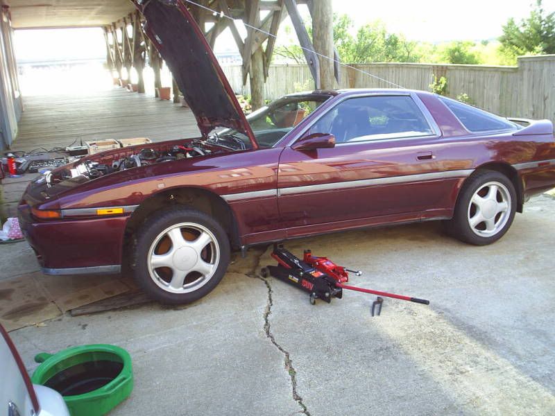

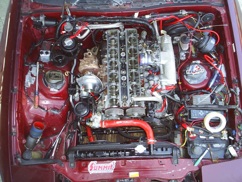

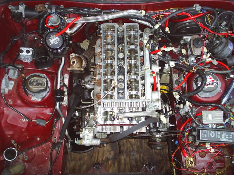

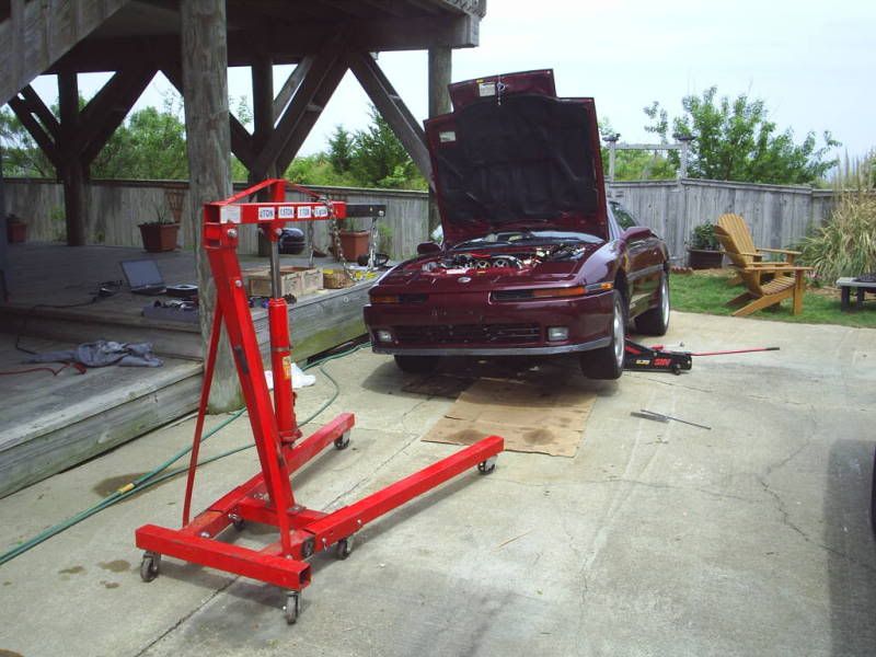

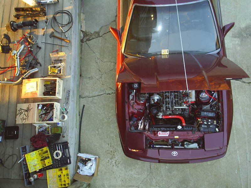

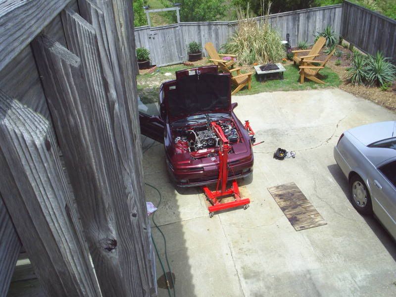

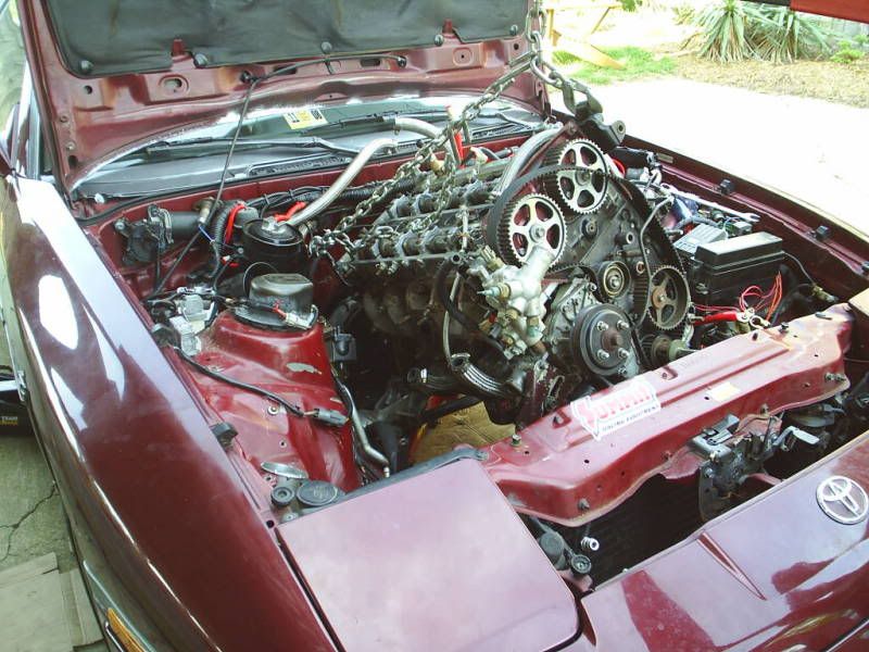

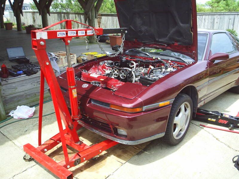

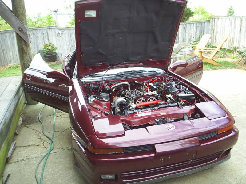

Wow, long time no update guys.
been savin up and finally got a cherry picker, and some new tools.

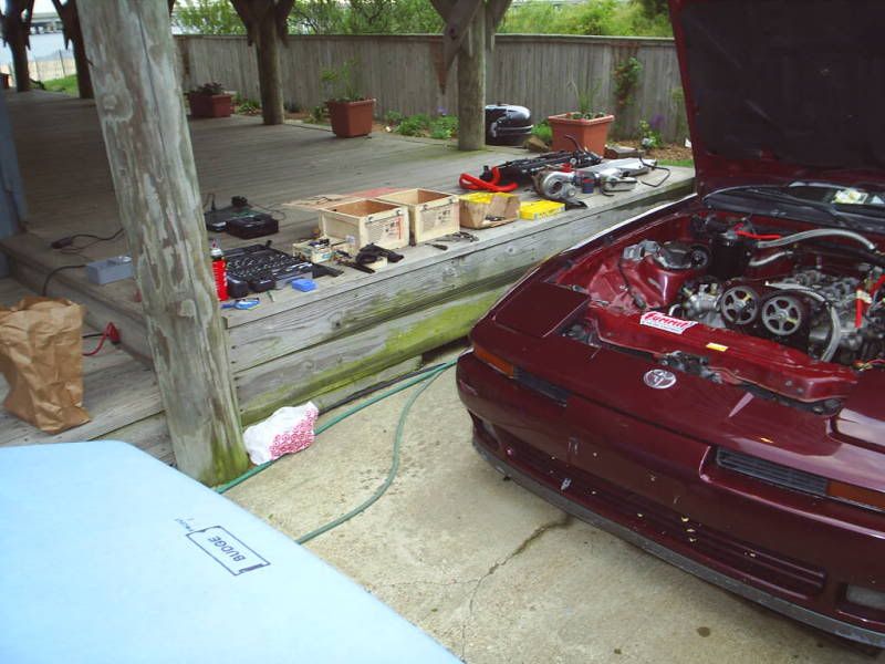

so it was nice outside today and i decided to show the car some love.
Tommorow im trying to pull the motor. Depends on how many people i have with me.

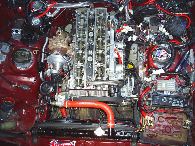

I hate having it outside in the elements. my turbo looks so crusty on the outside........ Lotsa paintwork comming as well. tidy up the engine bay while its open.

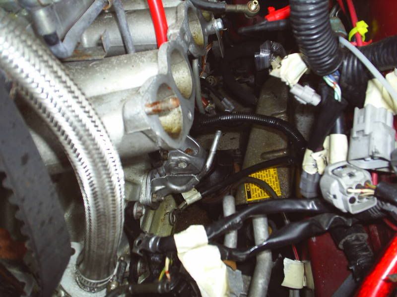

turbo taken out and left side of motor 90% ready
taking out the radiator and fans makes so much more room
Almost ready
the workspace

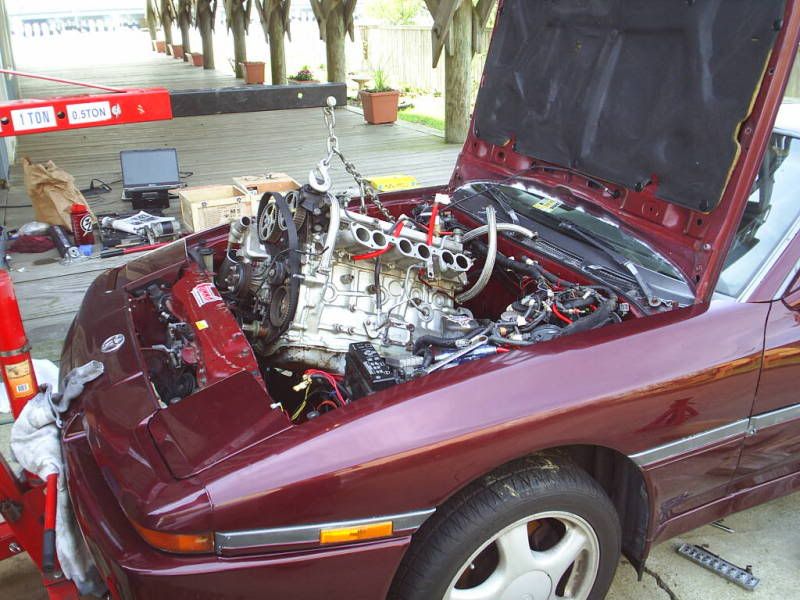

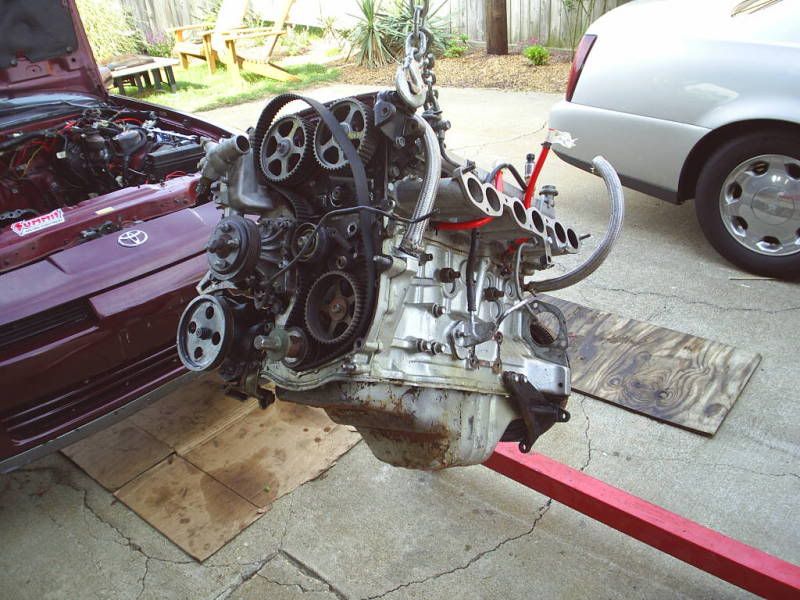

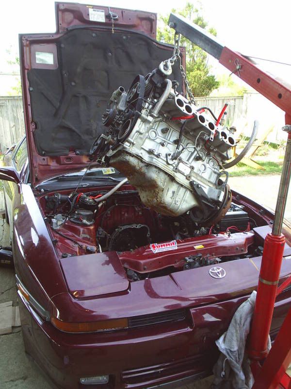

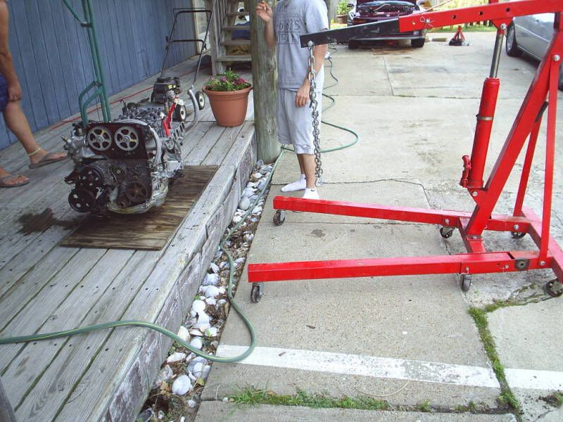

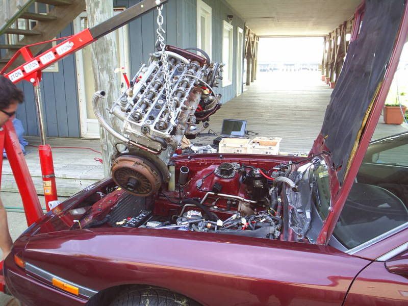

Success!! A long day of toiling, and i had a little trouble taking off the clutch fork in the bellhousing. but i got it.
but its out finally.

since the old crank has damag to the crankshaft pulley keyway and nub, have to use the crank out of the n/a. its the heavier one.
i have to have the rods balanced with the crank.
