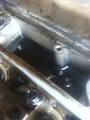

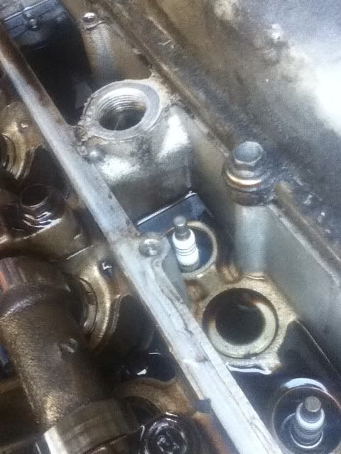

i just did mine today valve covers and valley cover i had god awful loads of oil in most plugs. mostly in the 6,5,4 cylinders..peep the pic :(
My friend was like god how come you werent misfiring? lol.

That's about how much oil I have in mine, I don't know how I wasn't misfiring as well!
I also figured out where the coolant was coming from, I blew a coolant hose on the back of the motor awhile back, and some ended up in there with the oil.
