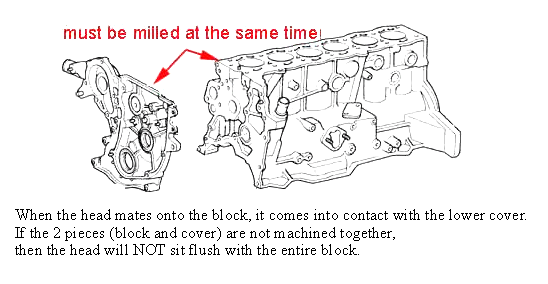

pulling from another thread
Don't forget the RTV on the two places on the top of the rear timing plate too.
Speaking of the rear timing plate, was it machined at the same time as the block? (I hope so) The top has to be even or just slightly below the block deck surface for the MHG to seal.
don't know if you are going metal head gasket or oem but I would personally want them to be even especially if its already sitting slightly higher
