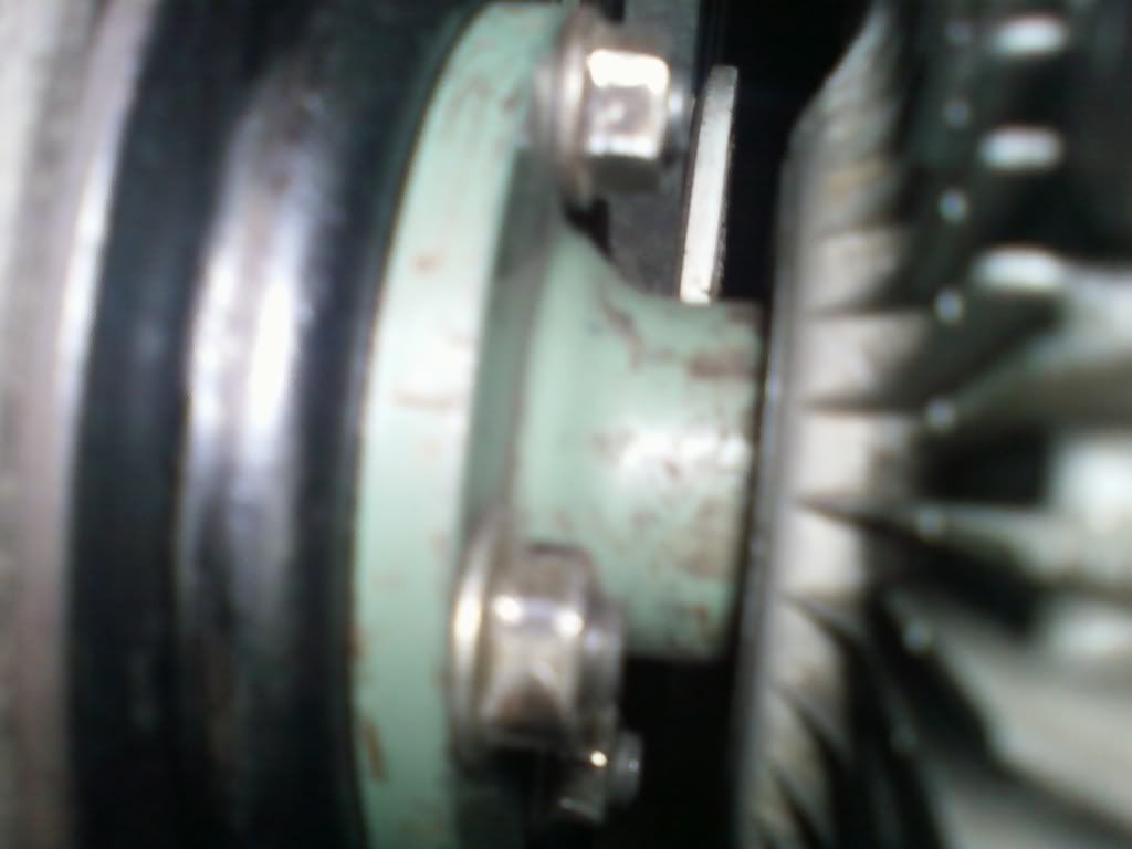

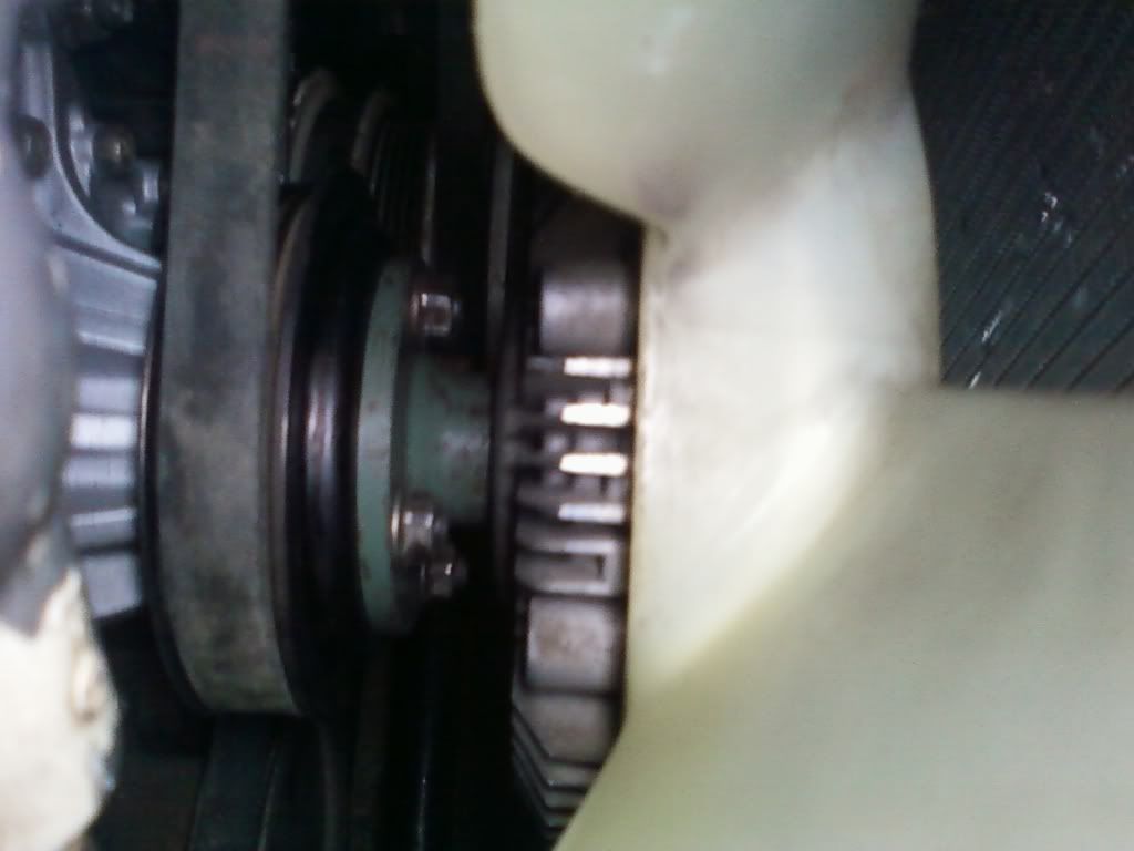

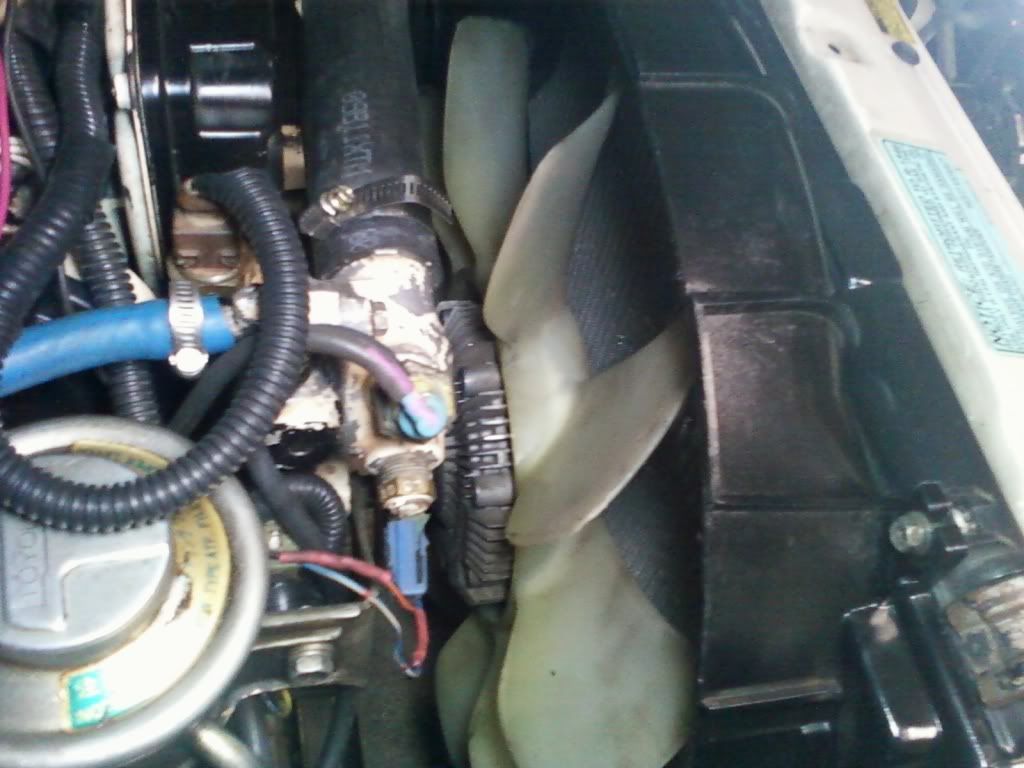

Odd... my fan clutch Hub is green & i took off the GE fan & put in the GTE fan & installed the fan shroud on. NO RUBS or clearance problems & DEFINITELY no cooling problems. o_O ill take pictures

Indeed but before 20 degrees hit, it was 70 to 80 degrees & i drove it like i stole it & blew the turbo's cooling hose, It literally split in two, almost as if someone slashed it & i lost a gallon of coolant & the temperature gauge rose to half & i of course got that fixed fast. I was in fact hoping that switching to a GTE fan would make the car heat up a bit more but it doesn't pass from the 3 lines on the Temperature gauge. At first when i changed the fan it heated up a bit more but it got quickly put down. I even have a lower temp thermostat & nothing. Idk whats up with this engine, it just stays COOL... :dunno:
---------- Post added at 08:29 PM ---------- Previous post was at 08:20 PM ----------

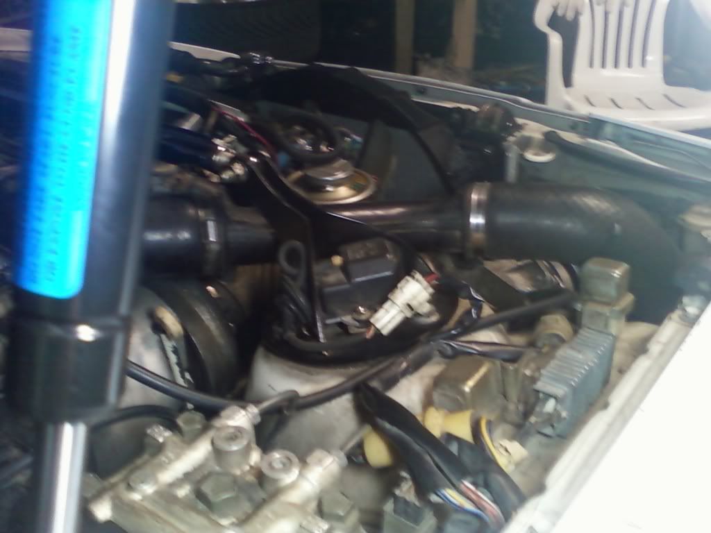

Pictures to prove! I got lots of different angles.

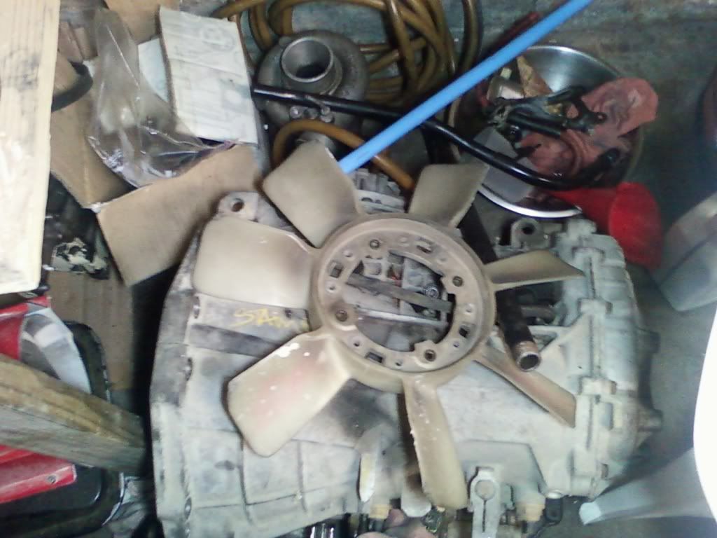

THE OLD 7MGE FAN!!
& AGAIN
Fan clutch Hub is green

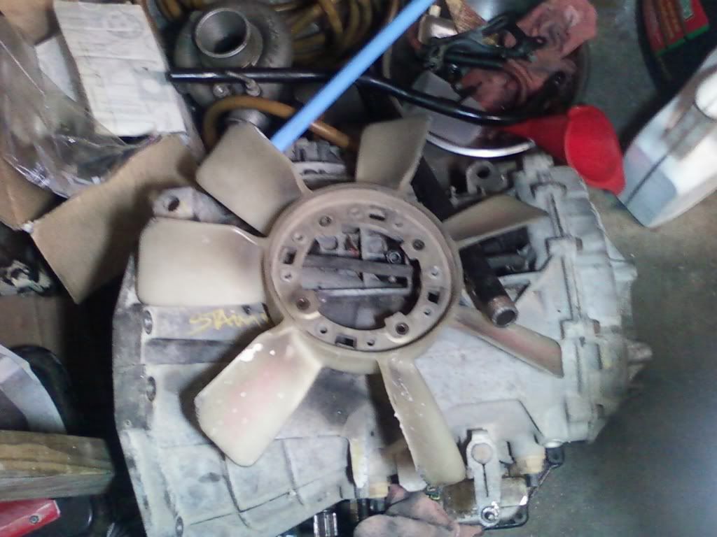

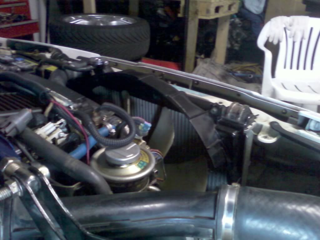

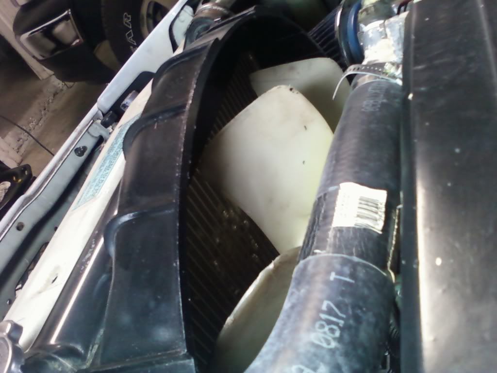

More pictures of the GTE fan installed

Odd i have the N/A Fan clutch with the 10 blade fan on it (i posted pics on this thread). Been running for a month or more now. Maybe the fan clutch isn't from a 7M but from a truck's?
