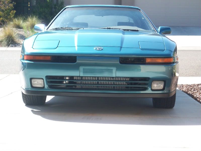

I used the cxracing universal kit and this is how it turned out along with a egay intercooler.
The intercooler I used bolts onto one of the stock brackets, that made it easy.
once i figure out the accordian pipe the top pipe will sit level.

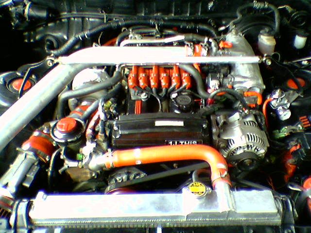

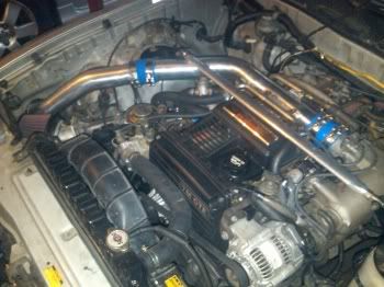

Did you put the intercooler on backwards...? Just curious... I used a CXRacing universal kit with the Spearco Replica from Driftmotion. Fits pretty well with my 2jz, but I'm not using powersteering or AC. The lower pipe runs underneath the alternator lines and coolant line like a stock 7mgte, but minus the 7m gayness :biglaugh: Just kidding. Gotta love my 2jz :evil3:

i almost got that kit, but the tiny core size steered me away from it. if it was a HKS or greddy (or other namebrand) FMIC i wouldnt have thought twice about it, but with the cheaper fmic i want the bigger core area. almost went with a 4" core but 3 should be enough for my power goals.
on a side note, the cxracing bolt on fmic that my buddy got had a cast elbow welded to the endtank not the 90* welded one thats there in the pics. maybe they updated the design, but not the pics.

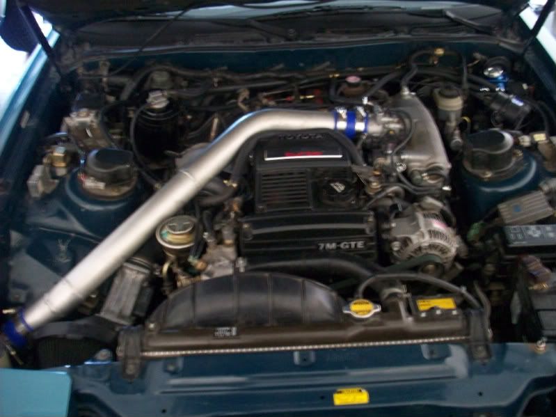

Maybe I should have mentioned my cars RHD that is where the stock pipe runs where else could it fit?
Holy lack of room, batman! :aigo:
That does complicate things quite a bit. How did the stock piping run through that mess?
I'd try to replicate the route of the stock piping as much as possible, if there's room. Chances are, you're using a bigger pipe than stock so that may not be possible.

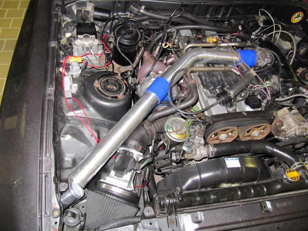

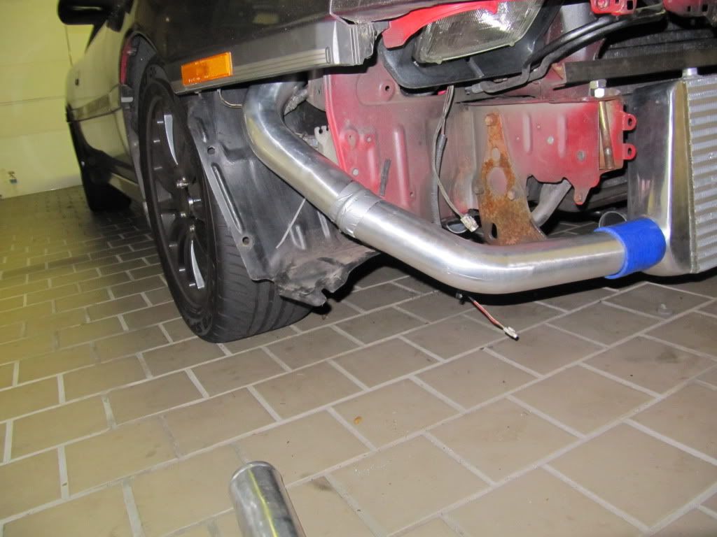

Heres my kit, 220$ is all it costed. Full aluminum piping to replace all the stock piping, all couplers and clamps included. 4 pieces only too!!! 3 From IC to TB, 1 from turbo to IC!!!
I have since then adapted it to a spearco replica by using 3 2.5 inch 90degree couplers, 1 2.5 inch straight coupler, and about a 2inch piece of 2.5 pipe to connect 2 2.5's together, and then liek a 6 inch pipe to extend the one from the turbo to the ic so it reachs. Id get more pics but my mechanic is wiring in my safc for me (I dont trust myself with internals/electronics)

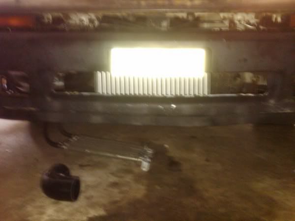

Heres also a picture of it with the FMIC mocked up, and the bumper slid on but not everything bolted back on etc, (Notice the trans cooler laying on the ground lol)
But for 220$, i seriously don't think you can beat this kit!

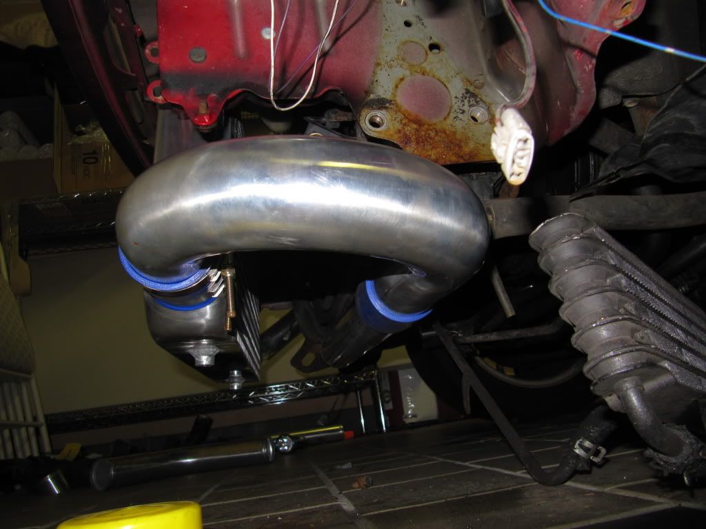

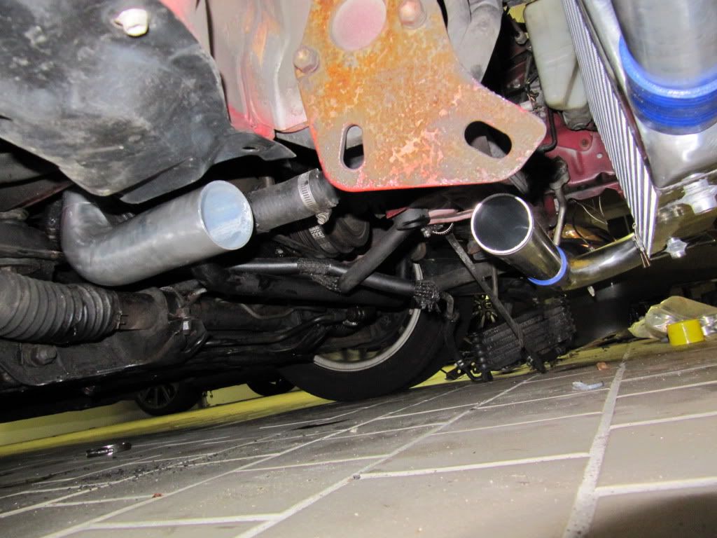

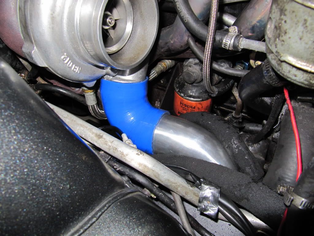

Ok round 2

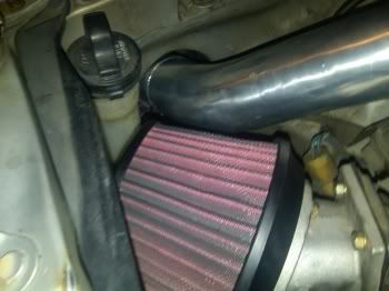

I mite shorten my intake pipe a bit to pull the k&n away from the pipes a bit
What do you think about running it this way??
my concern with this route is its very close to my air filter :( I cant seem to win its just too dam tight to run it underneath without relocating all of my power steering lines
kotu100
Nov 23, 2006
1,899
Easton, Ma
along with no hoseclamps, and a missing pipe.
thats just to make sure everything fit as marked. so when i weld it all tomorrow i dont have to cut and reweld.
I was gonna say... But still, duct tape? Couldnt of got something that wont leave such a residue on your pipes.
