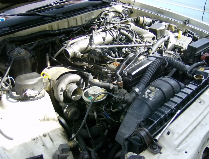

I wouldn't call this a complete rebuild, but I've just bought myself a '88 Supra Turbo Targa for $1500, very cheap but its been sitting for a year so it needs some work so it can be my everyday car, but I am going to add/replace some things to better things, I don't know completely what all those "things" are going to be but here are some pictures of how the car came to get started.

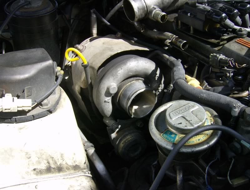

I also have one more project to work on, my turbo runs great, but the wastegate is stuck open:confused: I'm not to sure on how to get it unstuck yet, if anyone has any tips to get it working without having to buy a new one that would be awesome, I've tried searching the site but I can't find much. I might have to make a thread if I can't find anything in the coming days.

johnathan1;987236 said:
Why do you think your wastegate is stuck open? If they fail (not very often) they usually get stuck in the closed position...Happens all the time to Porsche 924 Turbos, and causes them to blow the head gasket usually.
I had a diesel mechanic that lives across the street from me look at it and the rod that comes out of the wastegate doesn't move at all, and its in the open position, but we unbolted the wastegate and it could move perfectly fine. We are going to try to shoot some water or something where the valve is and see if it knocks it loose.
ForcedTorque;987368 said:
Are you sure your blow off Valve isn't just dead. Take it off and see if you can blow through it. You should not be able to.
I'll try that to, and see if it's ok
