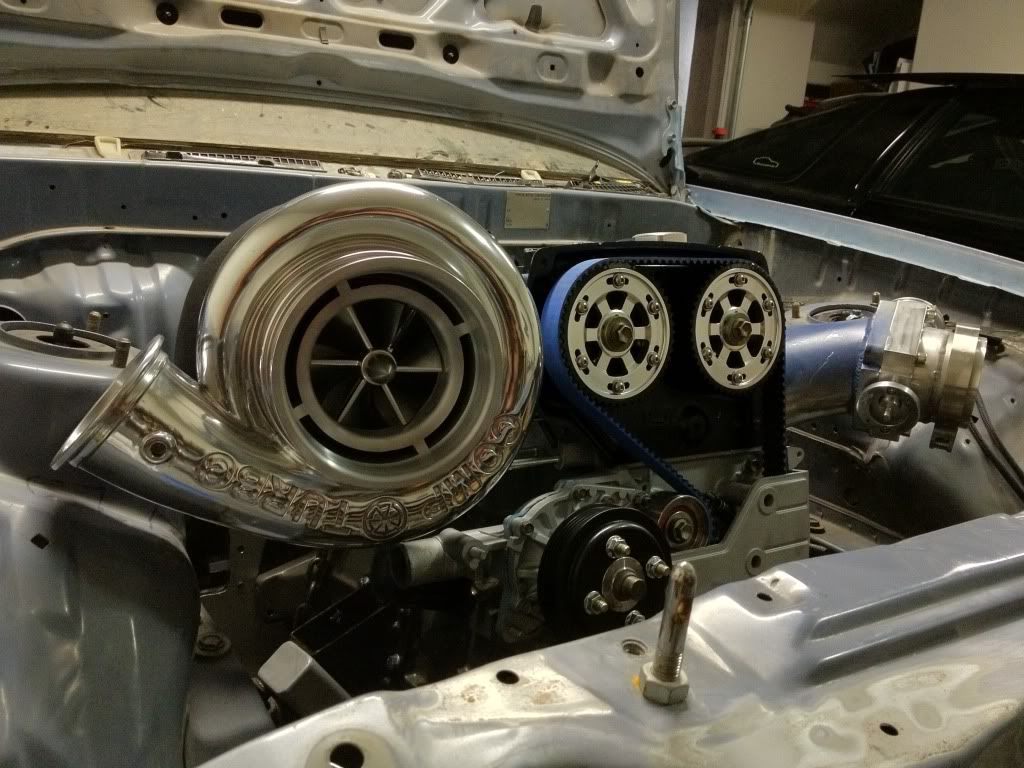

Lets just say.. Lexan windows, No interior, Rewired chassis with a Painless 12circuit, 28x10s (i use on both cars since the DD should be capable of 9's lol) lots of CF ;) I havent posted anything on it since I am currently saving to do the build the motor.. 2jz-gte with a Billet 47-88 attached to a th400. I will do another Build page on it once more parts are assembled
(teaser)
