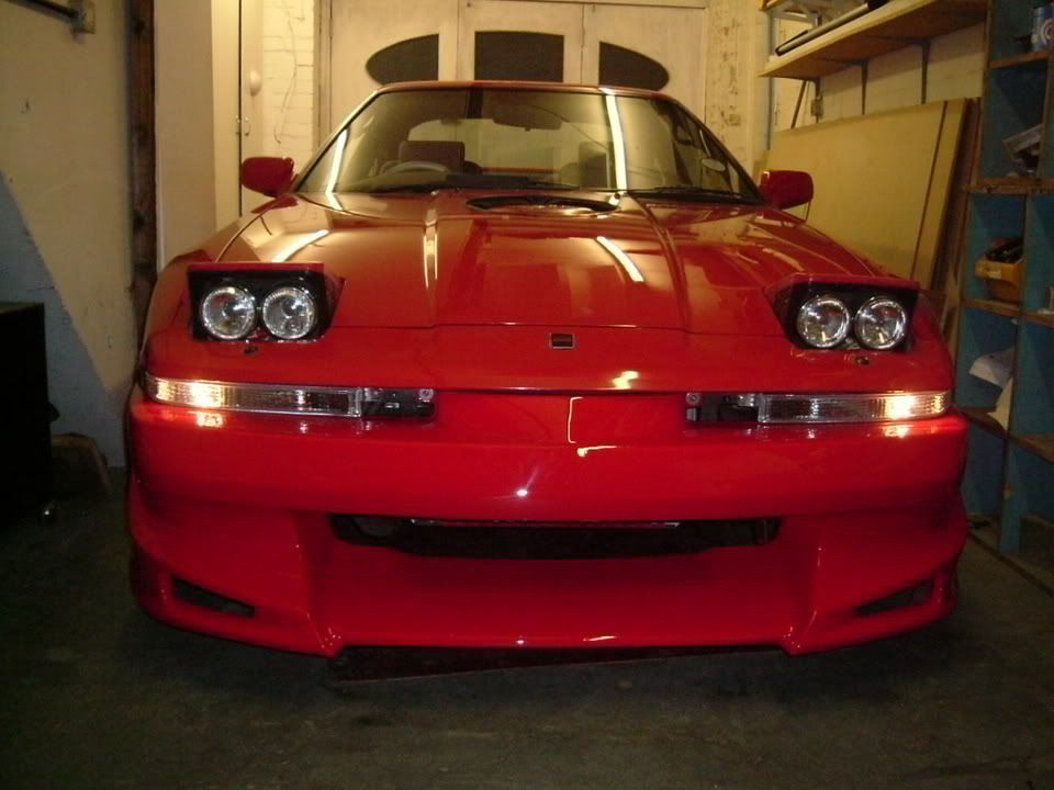

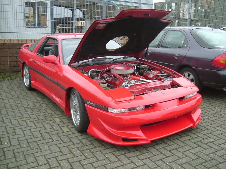

I have been driving my chevy converted supra around for a couple of weeks now and everything is working great including the gearbox and hi-lux/ chevy hybrid clutch. It has been a lot of fun. looking forward to getting it on the track. Here are some photo's

as for other things, that car looks like it was put together really well, did you do all of that, how much power? ever ran it?

thanks for the comments guys. Here in the u.k. we don't have many v8 cars, so the noise is a big attraction to the swap. Over here to get serious power from a jap car cost's a fortune, so buying chevy stuff from summit racing is a very cheap way of getting some more power. The car is about 400 bhp and 400ftlbs of torque + some more with a nos cheater kit. you could do the swap in a week easy. Its loud and my neighbours hate me. There is a down side. petrol is £4.50 a gallon which is about $8.
has been fun though. btw the head lights are motorbike ones .
