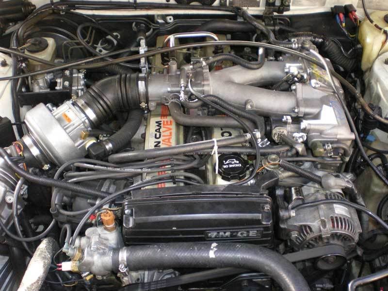

Not sure what you mean about dimples, but the Aussie one has a passage for the egr, and a cover plate on top that i think disrupts the flow path a little, it might be the same as yours. Can get a pic if you want.
I never liked the factory Y pipe because it increases area after the throttle plate. The increased area isn't huge, so the air won't loose that much speed, but it still doesn't sound right. I can't see the Y acting as 'plenum' volume because the flow is still fast and one directional.

Here's a pic of mine. Looks like it must be jdm.

aus87nat;1408394 said:
Ah, cool. I thought the Aussie one's would have been the same as the JDM version.
I think mine is a jdm. I bought it from wrecking yard. Wreckers bring in import motors and fit them mostly to cresidas with blown head gaskets. They take the jdm intake off and put the cressida intake on.
Took me forever to find the little vacuum canister and the accelerator cable brackets so that I could fit it all in my Cressy. Works well enough. It's set up to switch over at about 4000rpm from long runners to short runers.
