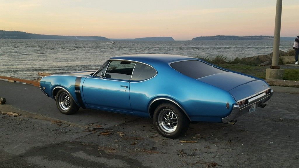

I played with a Muscle car for about 6 months that I bought. That was pretty cool and turned a nice profit. Super clean 1968 Oldsmobile 442

Heres my Olds,
It was great driving it, everyone asked why my dad let me take out his car hahah little did they know... Punks.
