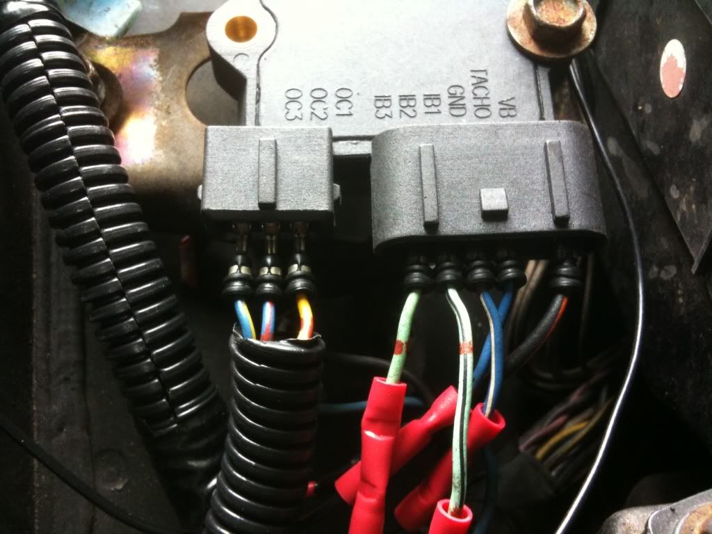

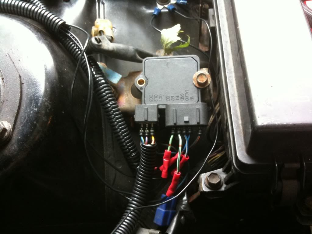

Just did the swap from stock to 3kgt ignitor, Night and day difference. Running 2.125ms dwell with EMS 8860. Recommend to anyone with standalone, 113 dollars from advance auto.

its as secre as the stock terminals fit, Hard to see how secure they are, but ill take a picture tomorrow.
When i was putting them on i know theres no way there coming off unless there physically pulled off.

My install, I'm wraping up the wires with electrical tape so they can't short on anything.
